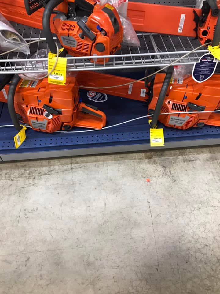

Depends on your RK for parts. One north of me sells stihl and one south of me husqvarna.
