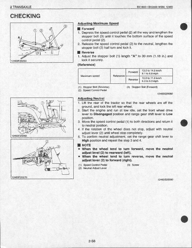

   / Sticking Hydro Pedal on BX..... #9
earlier posts indicated that the pedal was not
actually sticking , but something about the linkage
at the trans not being adjusted correctly.
i remember something about jacking up rear wheels
and making adj under seat till the wheel stop turning.
