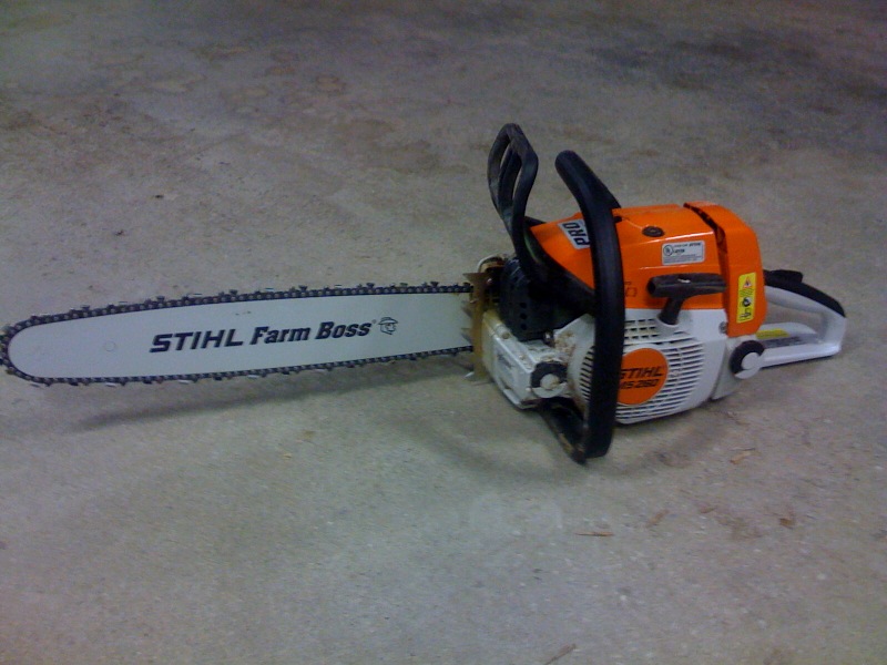

I just had to recheck to see if mine was a Pro or not. I didn't even realize there was a standard MS260. The dealer I went to didn't have one either and they had almost 18 different models. I put it through its paces and it did a great job. I've been working on a 22" fallen tree and I had one issue over the weekend as I could not tell how the tree would settle after cutting a section of trunk and ended up binding the saw real good. This is where a second saw would of come in real handy. It was dusk, starting to rain with 36 deg temps and there was no way I was going to be leaving it outside for the night. Had to take my tractor out for the lights and a cheap Troy Bilt 6" pull saw to cut this 22" trunk to free my Stihl. After about 45 min. I had gotten it free. For a while, I was not very happy with my predicament. It always seem to be the worst time when something like this happens.

The 260PRO has a decomp valve and and adjustable oiler, that's the only difference. The 260 is a pro saw.
The 270 is a fine saw and I'm sure it will last you a lifetime but it's not a pro level saw like the 260. Hope the dealer didn't try to sell it as one.

Get yourself some plastic wedges. Once you start using them you will never bind up a saw. You could also just get a second bar and chain instead of a second saw.
