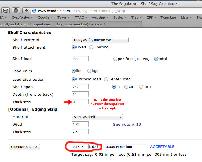

OK how far (in inches) does the TBN engineering squad estimate that the wood beam will sag? It's 5.75" x 7.5" x 242" long, Douglas fir.
About 1/2" initially. Then slowly over the years.
I like James Koua estimate better:cool:, but SPYDER can you explain how you estimated the 1/2"? Always interested in real experience (and the time factor). Note that the 6x8 beam is a span, the other beam/2x8 rimjoist is attached to the post in the middle.
Here's a pic of an internet calculator result (called "sagulator"). It estimated 0.15" with a distributed load. I chose "fixed" because the other span is attached to the 'wall' in the center, so only the 6x8 is deflecting.
If I positioned both snowmobiles with (heavier) engines at the shelf center it would deflect more, and obviously if they were stored tail-to-tail it would deflect less. I think I 'll set them tail to tail next time. I measured the sag after snowmobiles added (as in the pic) and real-life, measured INITIAL deflection down was 3/16" = .19. Sagulator Note 2 says wood tends to deflect an additional 50% over time, so it will go to .28, a little more than 1/4".

PS: If I change the sagulator to "floating" then add the rimjoist strength to the beam dims (so now it's 7.5 x 7.5) then the deflection is .38. Anyway SPYDER you are right in there.
