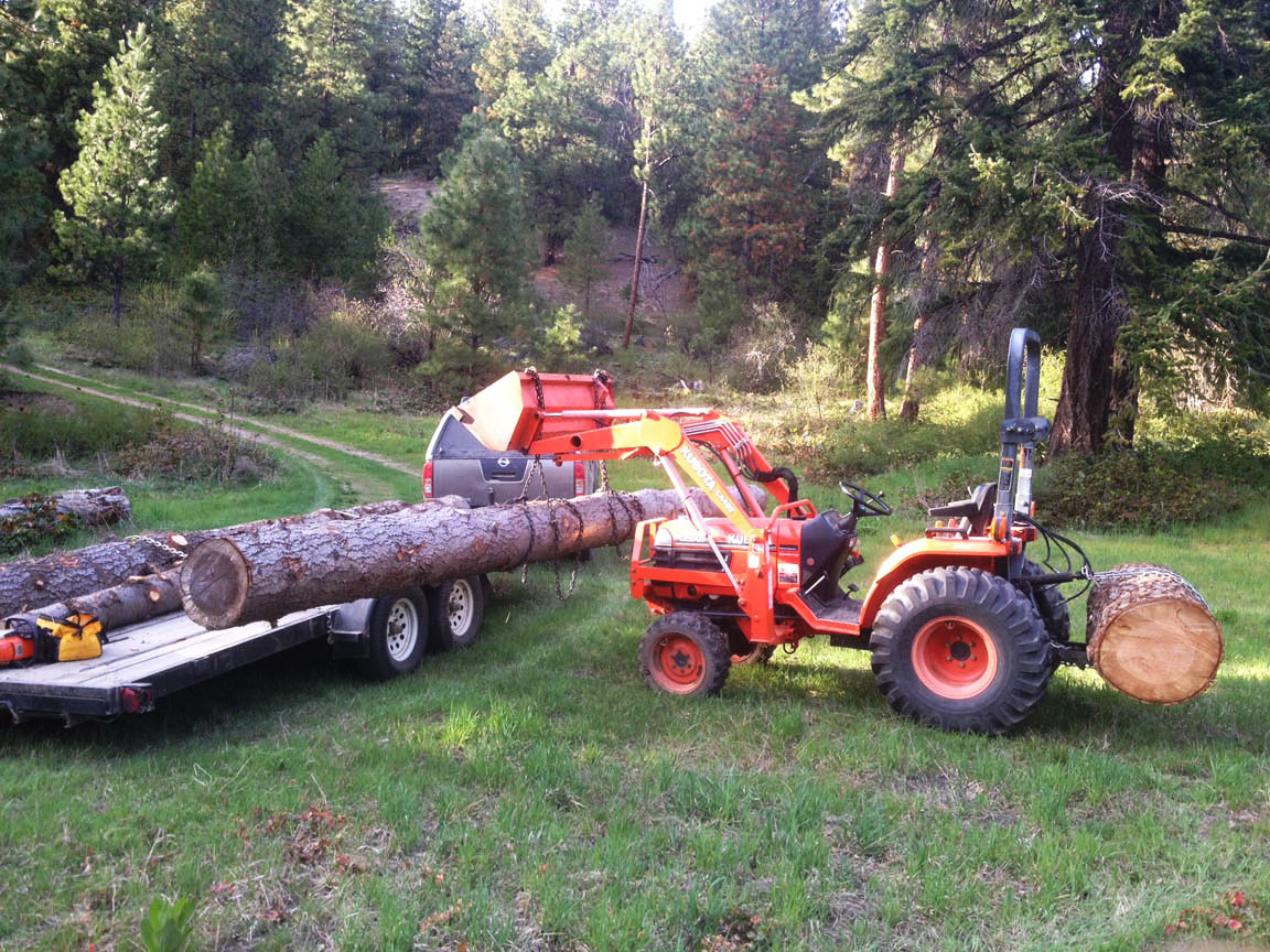

It seemed OK then 'got dicey' when I moved (traveled) with the load up high (for a better pic'). When the load is at hood height, it's actually farther forward - as the FEL gets higher, the load comes back, (towards the rear wheels) putting more weight on the rear. So if you can imagine, being in that position, THEN having to lower it (where the weight advances forward) was scary. I should have stayed off the tractor (while it was stable) and piled weight on the back, before climbing back on. I can think of many ways to do this (now). I could have curled the bucket back (to bring the load back) too but was afraid of the load shifting.
Live and learn.
Here's another pic with a counterweight of ~450 lbs. I chainsawed a couple holes for the 3-pt arms to poke into. I often back into stuff with it there, it reduces mobility for sure.
