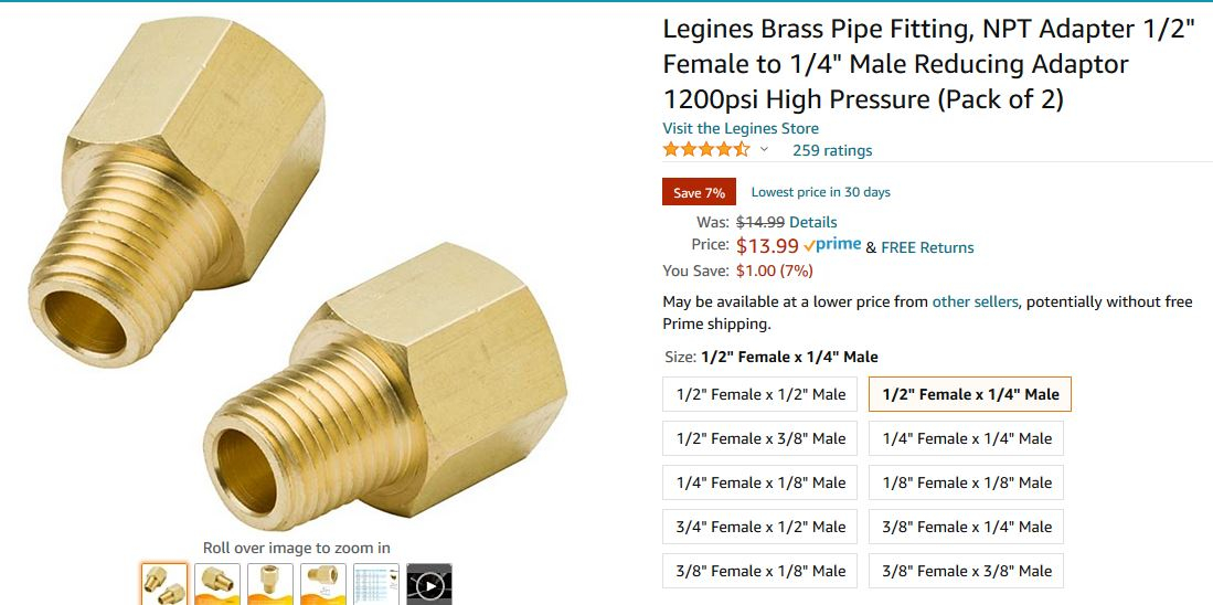

I did find this on Amazon...we shall see.
   / step down connectors #7
Think I would prefer steel.... 1200 PSI may be less than you hydraulic system is capable of... And then there is the price factor...
Your BX should be putting out about 2000 PSI so go with the steel fittings.
