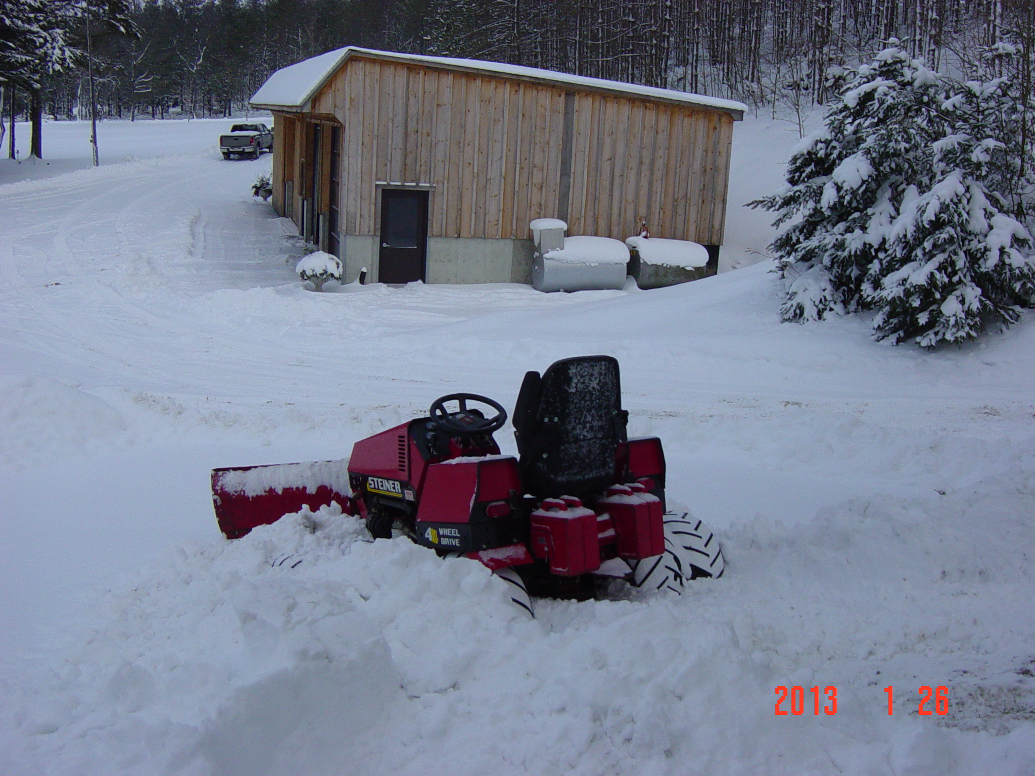

My choices on equipment are always based on what other stuff I have. If I lived in the suburbs, a Steiner would do for my only machine. Out in the boonies, it's nice to have some size and muscle. Even if just to rescue the smaller equipment on occasion.
To answer the question specifically. I had a compact JD with front blower, and I have the Steiner with front blower. Both blew snow about the same. The JD 770 (Yanmar) was not a hydro and THAT was it's main failing. And probably why I ultimately got rid of it this otherwise great tractor. The blower is very heavy on the front of the Steiner 430. Maybe a little too heavy. Blowing with the JD was a little more enjoyable. Better ride, bigger wheels. The Steiner is a dream to get on and off of.
Not with the blower, but I just had to see what she'd do.

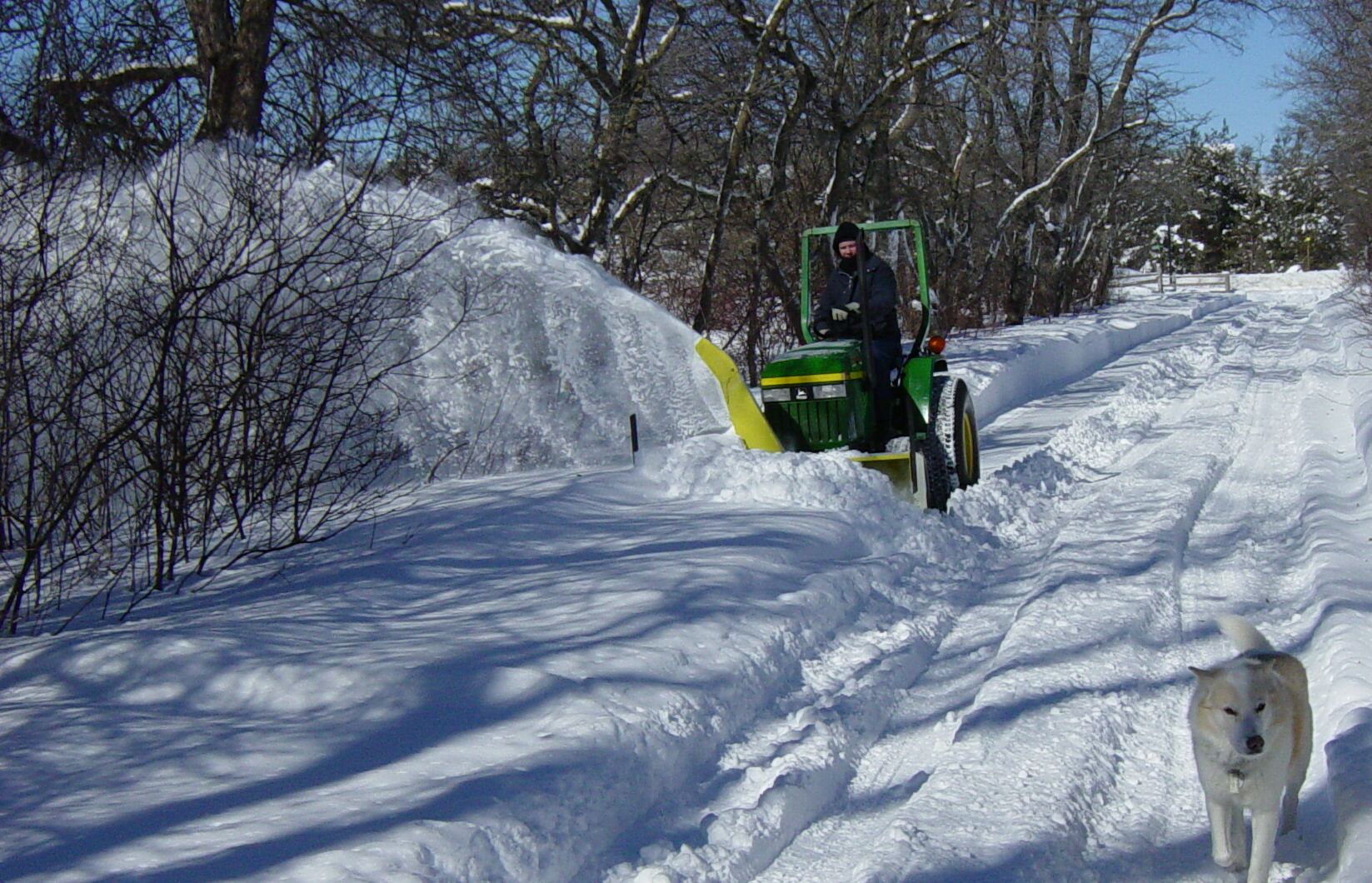

JD 770, Not what I would normally use for my 1000' lane, but it was a trade off between a Big Rear mount blower and the much nicer front mount albeit smaller one.

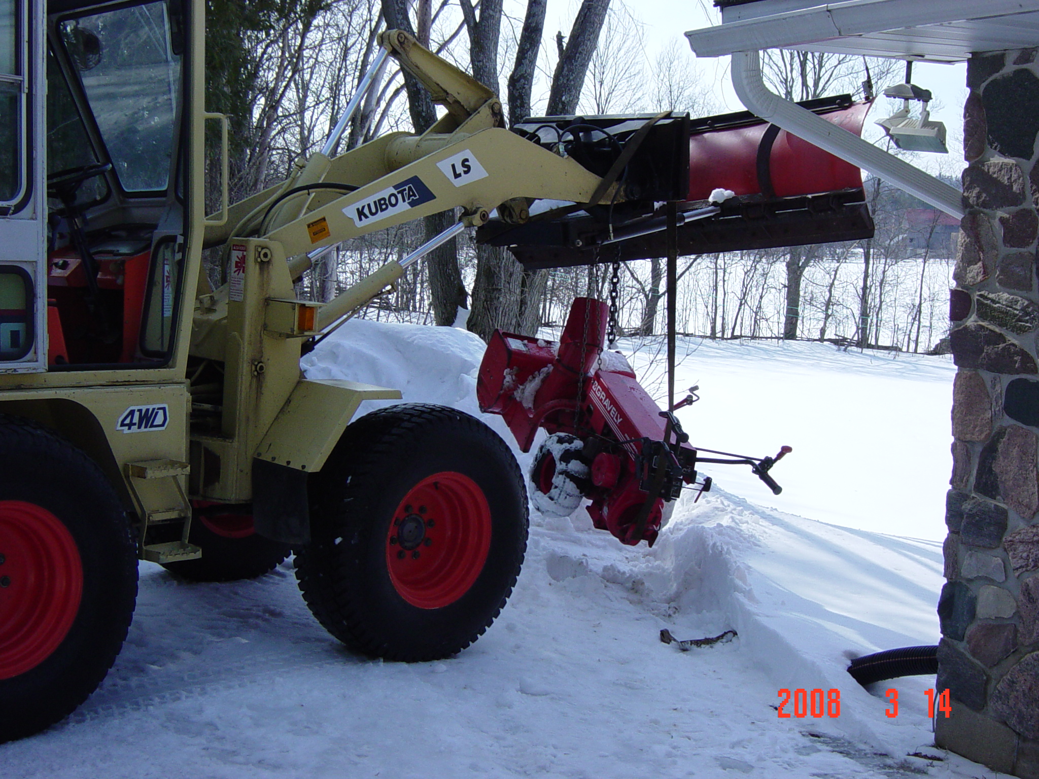

I probably mentioned it but that was the reason I got my steiner. Blowing around buildings. Tired of ripping off baton, eaves troughs and banging into doors. A machine will always slide into what you want to avoid, so at least the steiner won't do much damage.
You can get caught in places though. Last winter I had to take a lever chain hoist to pull the steiner away from a building it got too close to. A worse scenario with articulation.
This for a while was my solution around buildings. I don't miss it. If it went too far over the hill, it was stuck! That Gravely would blow snow a mile though!
Oh, you can see a piece of repaired eavstrough that was replaced!
