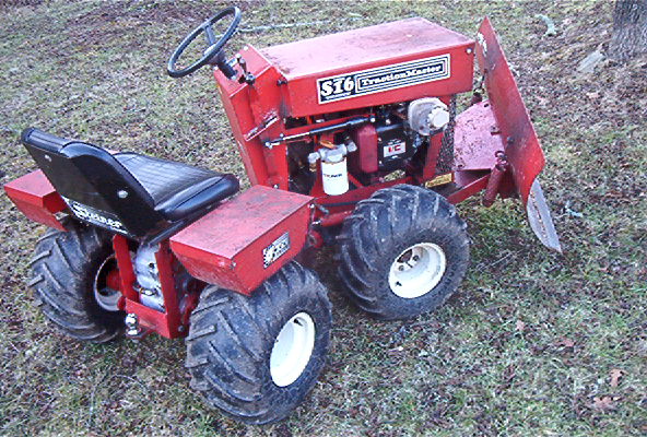

I have a 1979 S-16 traction master repowered a few years back with an 18 hp briggs & stratton twin cylinder engine (about 250 hours on currently). I currently use it for aerations only (50-60 yearly) as I own a small landscaping business. A few of the attachments I am interested in using are...
1-stump grinder
2- snow blower
3- 48 inch or larger mowing deck
4- slip scoop
5- rototiller
Do you think that I can run any of these efficiently? Some people have said I need atleast a 20 hp (normally dealers), is this true? Also, I was told to get a larger engine into the steiner, there would be major alterations done to the machine ($3,000 roughly). I'm trying to get the most "bang for my buck" on this steiner as I bought it for $500 dollars. Any help or insight would be appreciated!

You should probably upgrade your machine.If you add power and larger heavier attachments you will break axles.Larger attachments take more rear weight to control and your machine is to light.I have a Steiner 430 Diesel with all the weights on the rear and sometimes have trouble controling the slip scoop working downhill.You need to keep the stump grinder at full rpm's and I dont think 18 hp would be enough,unless it was very small stump.The Traction Master is an ok machine for lighter grading,snow plowing and mowing,but not up to the larger attachments.I also owned a 410,and a 415 and I broke axles on both of them.The 415 broke with a 72" mower deck and dual wheels(72"deck and duals are not recommended for 410 or 415),the 410 broke one jerking a stump out of the ground.I have had the 430 about a year with no problems whatsoever. Eddie

thanks for your reply! I recently spoke with a dealer rep of Mast Lepley out of apple creek, ohio (they are the largest steiner dealer in the usa). I was talking to him about how I love my machine but its underpowered. He claims that kohler has a 30 hp engine that is a retro fit for any steiner. He says its actually smaller in size than my 18 hp b & s.
He said it would be $3,500 for the kohler put in. I would rather put it in myself for the cost of the engine if it is viable. You mention the axles possibly busting with say.... a rototiller. Is there a way to "beef up" the axles? I know that you said you think I should sell it and get another machine, I think your right but i just want to make sure I give it my all before I go that route. Thanks again for your insight!

Judd,The roto-tiller itself isnt all that heavy,but some attachments can be over 550 lbs.Loading rear weight and using a heavier attachment will break your axles.They went to a larger dia. axle on the newer machines.You can find specs on Tecumseh-Peerless transaxles on their website.If you are going to put 3000.00 in your machine,I would look at some of their used equipment,you could go with a heavier unit for a little more money.Anything with the peerless 2600 transaxle would be an upgrade for you. Eddie
