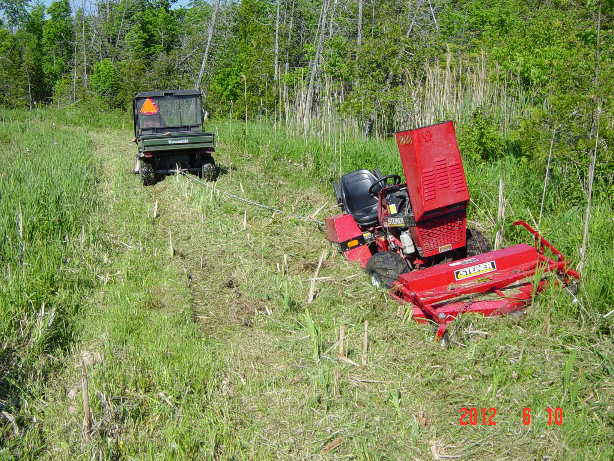

Swamp work without duals. Old 60 SD mower.
Sorry, I get excited when there is talk of Steiner/Ventac. Not enough on here.

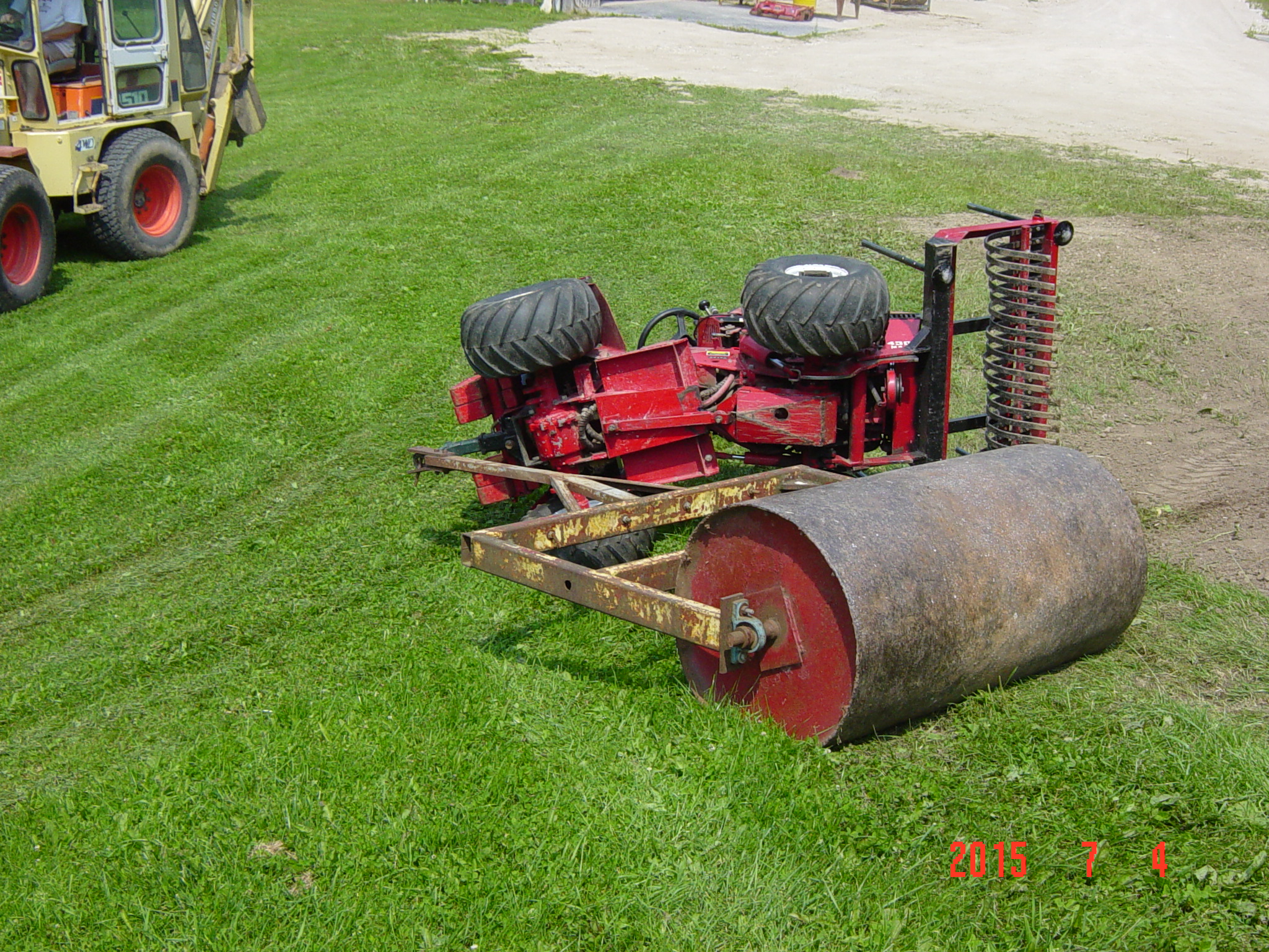

Nah, just without.
Not sure if duals would have helped. Too sharp a turn on a hillside with this gravel loaded roller.
/ Steiner 440
Thanks for the pic, guess anything is possible! I assumed with the dual would be very hard. At least that is what I hoping since I am will only be using this thing to mow. Very expensive mower. I have a couple of JD ag tractors to do everything else with. Might be a good option for people that need several attachments and don't have space or funds to own a big tractor. But as a pure mowing machine 22-28K I feel is a large investment. I really wanted the articulated 7ft deck until I found out it was over 8K for the deck alone.

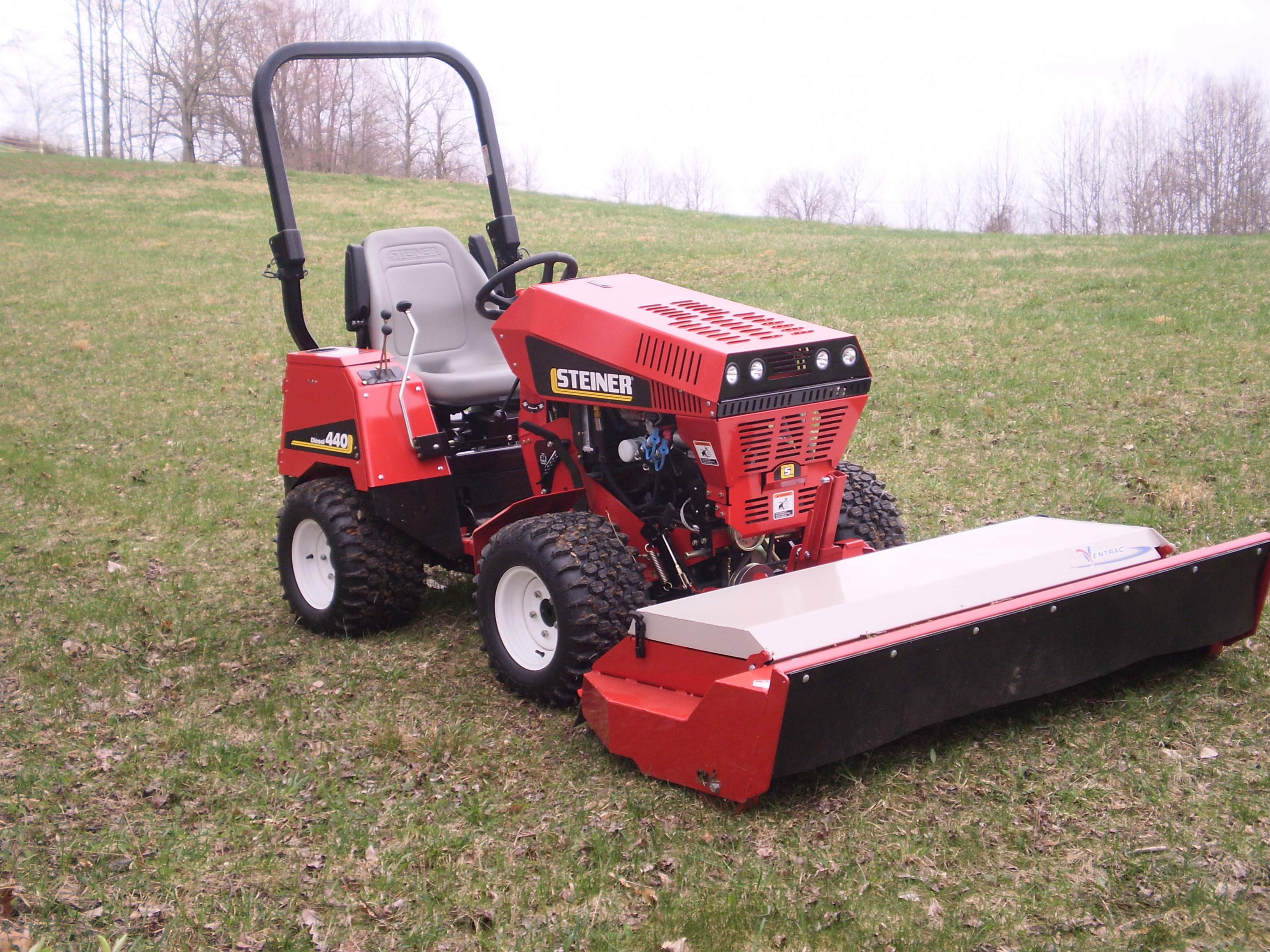

I bought one the first year they came out with the 440. The Ventrac 4500 had not even been introduced yet. I had a lot of issues with mine the first 2 years but Steiner and the dealer took care of all the issues. I don't think you will have any problems with a new 440 now since it will have all the upgrades on it. Well except one ( fuel tank ). The 440 has a steel tank on it and they can rust, mine did. Just keep it full and you will not have that problem like I did. Cold temperatures allow condensation to form just above the fuel line causing the rust. I have the 25hp diesel, single wheels with the 3" spacers and 60" deck on mine. There is a guy up the street from me with the 4500 Ventrac 25hp diesel, dual wheels and 72" deck. He claims his has plenty of power. I say the 25hp does pretty well on the hills but every ones situation is a little different. Every tractor can use more hp mowing up steep hills in tall grass. I also would recommend you get the optional weight transfer for the 440. Makes a big difference on side hills. Night and day actually. I ran mine for the first 2 years before I added it and love it. This is a picture of it without the weight transfer on it and the 68" Ventrac tuff cut mower on it.

Nice picture. Like out of a sales brochure. What kind of mower is that?
/ Steiner 440 #16
That mower is a VENTRAC Rough Cut mower not a Steiner Mower...
