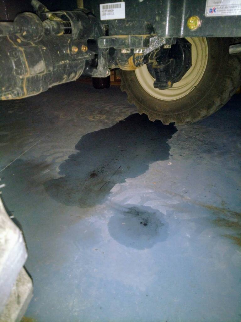

Taking mine in tomorrow. Dealer said he's seen a number of them to the point they have 2 cylinders in stock for replacement. IMG_20180128_173758.jpgIMG_20180128_173728.jpg
