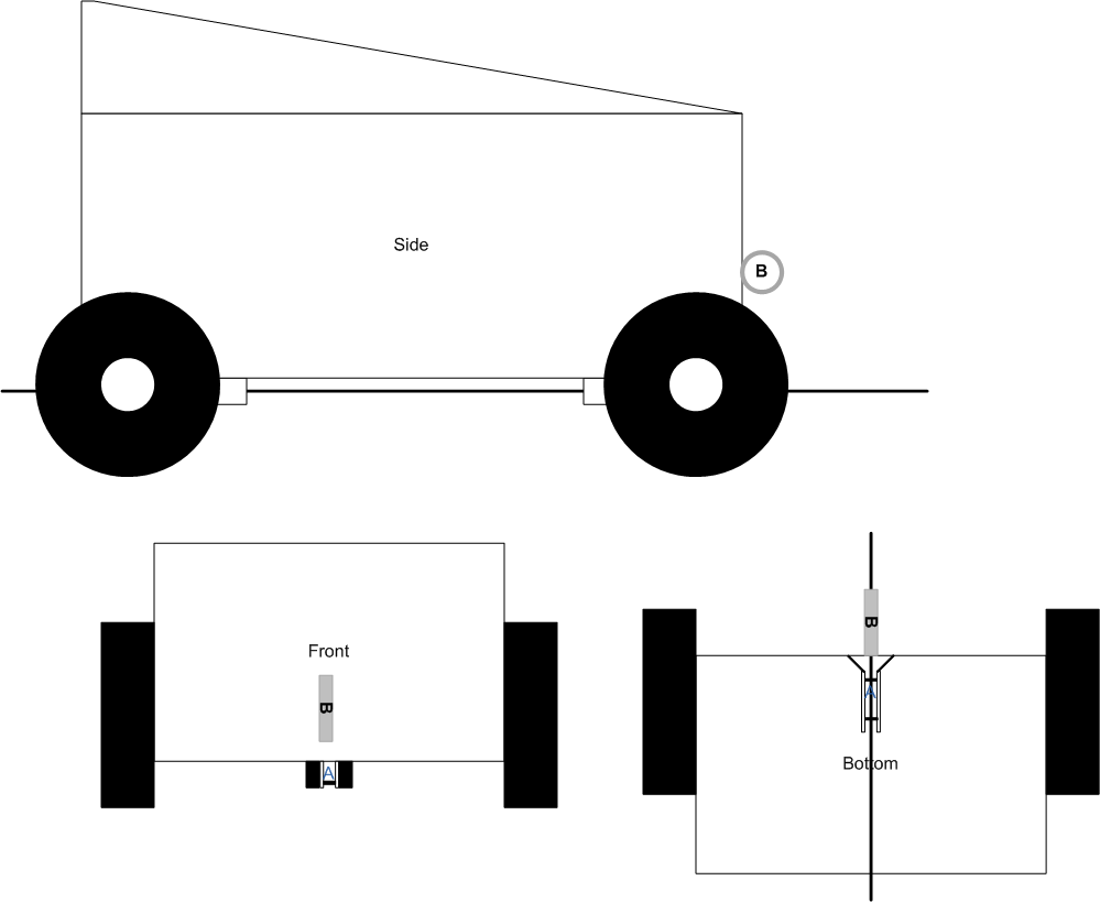

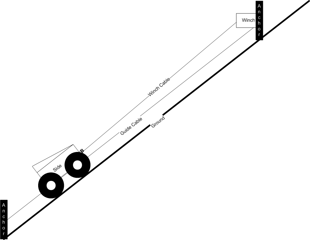

How about something like this:
but with the tractor driving forward or back at the top instead of a winch?
Aaron Z
