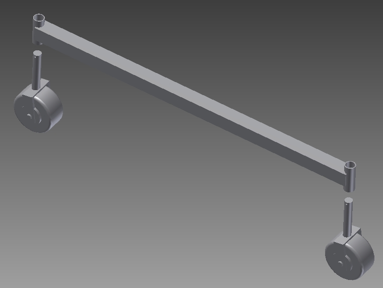

I'm building some new wheel supports for my finish mower. The original ones got bent.
For the spindles I am using 1.5 inch DOM tubing. The wheel fork spindles are 1.125
The wall thickness of the DOM tubing is .120 Is this too thin? Will there be too much slop in the spindles.

Sounds pretty sloppy to me - might work better if you can
Add zerks to the DOM so they can get greased
Maybe find some .040 to .050 shim stock, put a tight fitting washer over the fork spindle, wrap the shim stock around the spindle and shove it into the DOM - the lower washer should keep the shim stock from slipping down (shim should be about 3 times the spindle diameter so it can't "walk away" -
Just a thought, since you probably already have all the parts - otherwise, I'd look for a bit tighter fit - say, around 15-20 thou instead of 135... Steve

Looking online I found some 1.5 DOM tubing with a center of 1.124
How hard would it be to drill it out to size. And what size am I looking for?
   / Steel size for project #11
For that little distance, I would use a brake cylinder hone instead of a drill - I'd shoot for a clearance of around 20-30 thou (>.030), but for that type use you could just hone a bit, try the fit, repeat.
You want enough "slop" to keep a grease film between them, but not a lot more. Keep in mind, it's not like that fitment is gonna be turning 6,000 rpm or anything... Steve

Aha - I see. Then how about changing the DOM size?
Speedy Metals - 1-3/8" OD {A} x 1.135" ID {B} x .120" Wall {C} DOM Steel Tube
this will give you a .010" nominal diametral fit. Just watch the heat when you weld it to the rectangular tube or it'll distort and you'll get something less than .010" nominal - maybe too much less. If that happens, then you'll be wanting a reamer (or brake hone) to open it back up.

I wonder if I could drop the square tube down a size to 1.75 inches.
   / Steel size for project #15
Depends on the weight of the mower and the wall thickness of your tubing - if you can find 1-3/4 tubing with a .120" wall thickness, it should be plenty strong to support a few hundred pounds with that span - but you might be better off going with RECTANGULAR tubing, say 1-1/2 x 3", same wall thickness - that works just the same as headers in a house - if the wide dimension is the vertical one, you get more weight support... Steve
   / Steel size for project #16
BukitCase is right about the advantage of using rectangular tubing like a header. Most of the loading will be vertical, so that's where you want the long side of the section. Consider using a 2x3 with .120 wall (if it will fit). Then you could drill a 1 3/8 hole clear thru and slip the DOM tubing thru the hole. This will allow you to weld the DOM to the rectangular tube in a circle around the top and bottom of the rectangular tube, rather than along the sides of the DOM tube. Much easier to get a consistant weld joint gap, keep everything aligned and less distortion this way.

I got the steel today. 2x2 square tubing with 3/16 wall, 54 inches long,
and 1.75 DOM tube with .25 wall. I ended up with 1/8 of slop in the spindles.
I can live with that. Now to start drilling holes.
