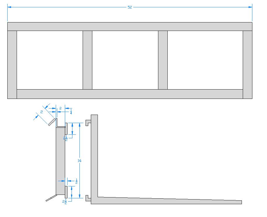

I made a frame for the kind of forks that hook on top and bottom (probably the type you have). Not sure what size loader or tractor you have...
The frame is mostly 2 x 2 x 0.25 wall square tube except for the top member; the top piece is 1/4 inch angle - this allows clearance for the forks to slide and also spaces the tractor side high enough to build the SS attachment. If you are using a one piece QA plate then this may not be necessary.
I built it for a Kubota L3400 and it is very light and also keeps the forks as close as possible to the pins (minimize reach). I don't have pics of it but I will be seeing the tractor this weekend.:licking:

MWB just curios if you use standard mild steel or a higher grade to build your fork frame in the above post? This is the type of design I'm looking at doing for my kubota that I just finished a SSQA for. I have a set of class II forks like the ones you were talking about. How well has the frame held up for you also?

I can tell you for a fact that the notched bars that the forks ride on for Kubota forks are made from A36 hot rolled steel.
The company I work for used to machine these bars for another company that supplied Kubota.
There is an upper bar with a several notches and a lower bar with one large notch.
One was made from 5/8" x 4" and the other from 7/8" x 4" A36.
There was an angle milled on one side also.
Just found this, sorry for the late reply. I used standard "off the rack" steel. For the he 0.5 flat bar for the fork carrier I used hot rolled. The flat bar does not extend very far above the frame - it would take a lot to bend that.
A real forklift has a much higher capacity than your average CUT; I have used mine to the maximum capacity of the loader all the time:D and have not had a problem. If you have a 65 HP machine with a huge loader capacity then maybe you want to re-engineer this. If you have easy access to better steel then you might as well use it; just remember that you have to be able to work with it and weld it.
