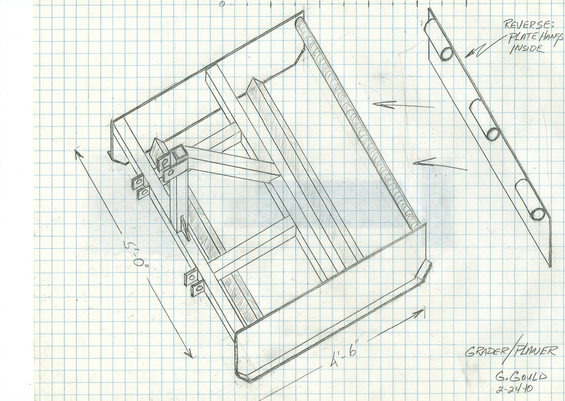

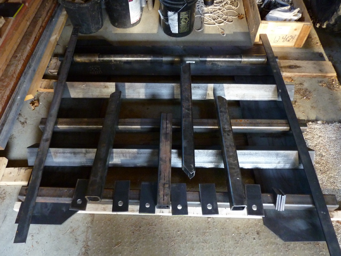

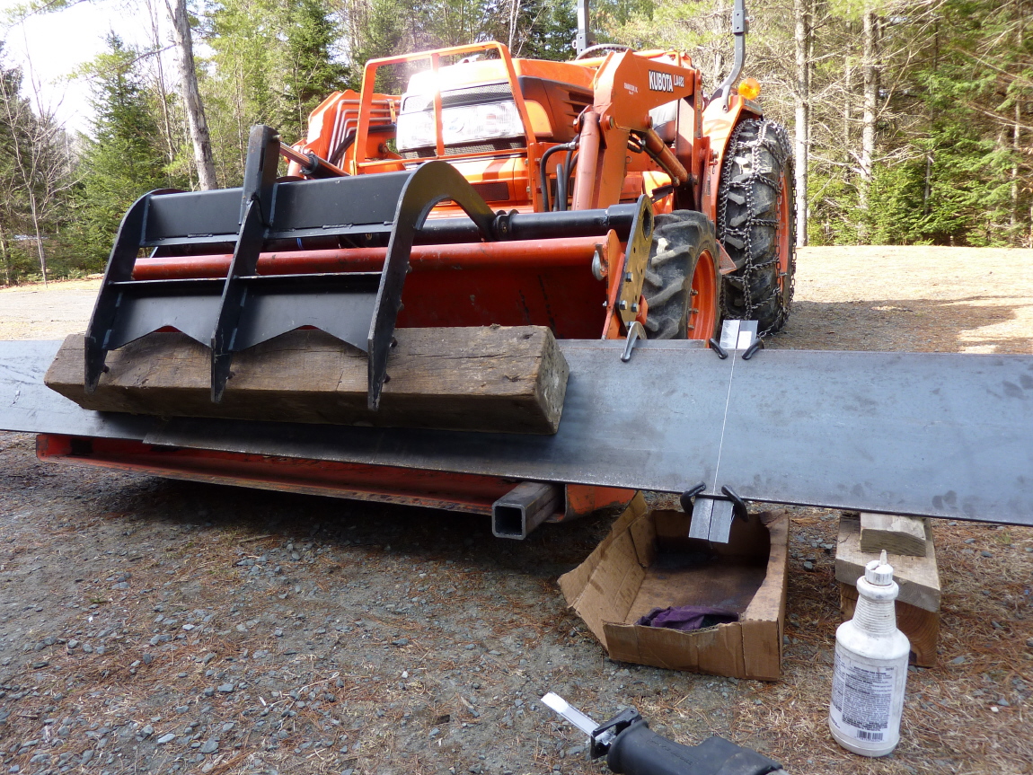

It took many hours to cut the steel. Would think very hard before I did it again.:laughing: At the time I didnt know any better.
The fit was excellent. The parts where all within 1/16" and square. But I
spent alot of time with a hand file to get them that way. The five cross
pieces and the angle piece were the only ones I had to worry about.
I do carpentry work so know alot about making things fit, But steel was
new to me. The welder said it was better than it had to be.
The cutting edges fit a Land Pride rear blade for their lower hp rated blade.
I didnt feel that I need the strength of a heavier edge with my 4x4x3/8 angle.
They are flat with bevel on one edge 3" wide and 3/8" thick. 75 bucks each.
