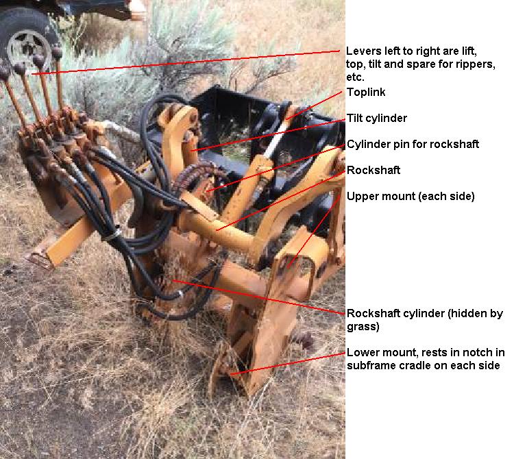

npalen - I've not used the term "rockshaft" in that way - but if you mean ripper control, then yes. When that cylinder is closed, rippers are down and locked with a sort of "over center" linkage.
Rippers are held in their individual slots in the rotating box beam by "mil spec bobby pins" that keep one of 3 notches on each ripper shank locked in place in its slot. When I did that pushout several years ago I had all rippers in the deepest position, gave me 6-8 inches of penetration before the cutting edge touched the ground.

By "rockshaft" I was referring to the shaft that normally drives the two upper lift arms. This would be the shaft that is normally driven by the internal cylinder of the tractor.

OK, we're calling things by the same name - I marked up one of the pix - labeled everything, I know YOU don't need it but others might have questions.
NONE of the pix show the rockshaft setup but it's just an external cylinder that pushes on an arm that's welded to the rockshaft, like a bellcrank.

I think it's off an industrial Case Construction King tractor but $500 is a steal.

Arc, you're right - Mine is identical to this one (the hitch, my Gannon's older) and it was removed from a Case 530 skip loader (parted out) - but the older Case CK's (up to 580C or D, not sure) had the same cradle mounts.
The newer 580's were probably stronger, but the only way their hoe could come off is in pieces.
My 580B's Case shop manual even shows a version that had the seat and controls reversed and a pretty large fork lift mounted there. I doubt if THAT conversion could be done in 30 minutes :laughing:
I bought my 7 foot Gannon WITH the Case hitch from a Case dealer that used to have a branch in Nevada that was mostly used/parting out, they put a new cutting edge on it but NO RIPPERS, just the slotted box beam and linkage -
That was 10 years ago, and I gave $1700 THEN. Both parts of that CL ad are MUCH newer/better than mine - that's what prompted me to post this in the hope that a TBN member might be able to take advantage (assuming it's not bogus, that is)... Steve
