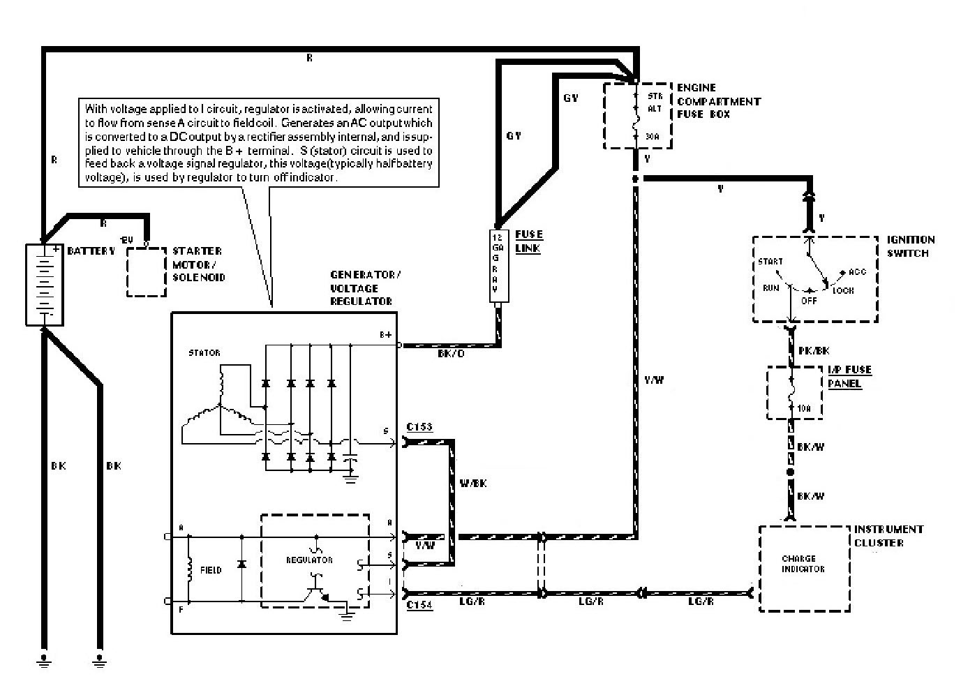

My JD LX176 isn't charging. I wasn't seeing enough voltage at the stator connection when the engine was running. I am getting a .2 ohms reading across the 2 stator wires. No shorts. Is the stator the culprit? I am not sure about the ohms value.
   / Stator Resistance Value #2
How are you reading stator voltage? It should be an AC voltage which is then applied to diodes to rectify into DC voltage. You have a multi phase stator windings typically three or four which output AC voltages that is then rectified to a DC voltage. The output voltage is read by the voltage regulator which applies a proportional DC current to the rotor winding through some brushes. The output voltage is therefore regulated to something between 13 to 14VDC or enough to charge a 12V battery. Typically what fails are the brushes wearing out. Usually about a dollar ninety eight fix.
Typical alternator wiring.

Shoot, I think I read the voltage on the DC setting...already yanked the stator out. Should have came here first! So you are thinking that the .2 reading with no shorts would indicate that the stator is fine? The failing brushes that you mention are on what component?
   / Stator Resistance Value #4
Usually the brush holders are on the removable back housing. The brushes rub the commutator ring on the rotor and pass DC current to the rotor winding which produces a rotating multiphase magnetic field that cuts through the stator windings to produce multiphase AC current.
