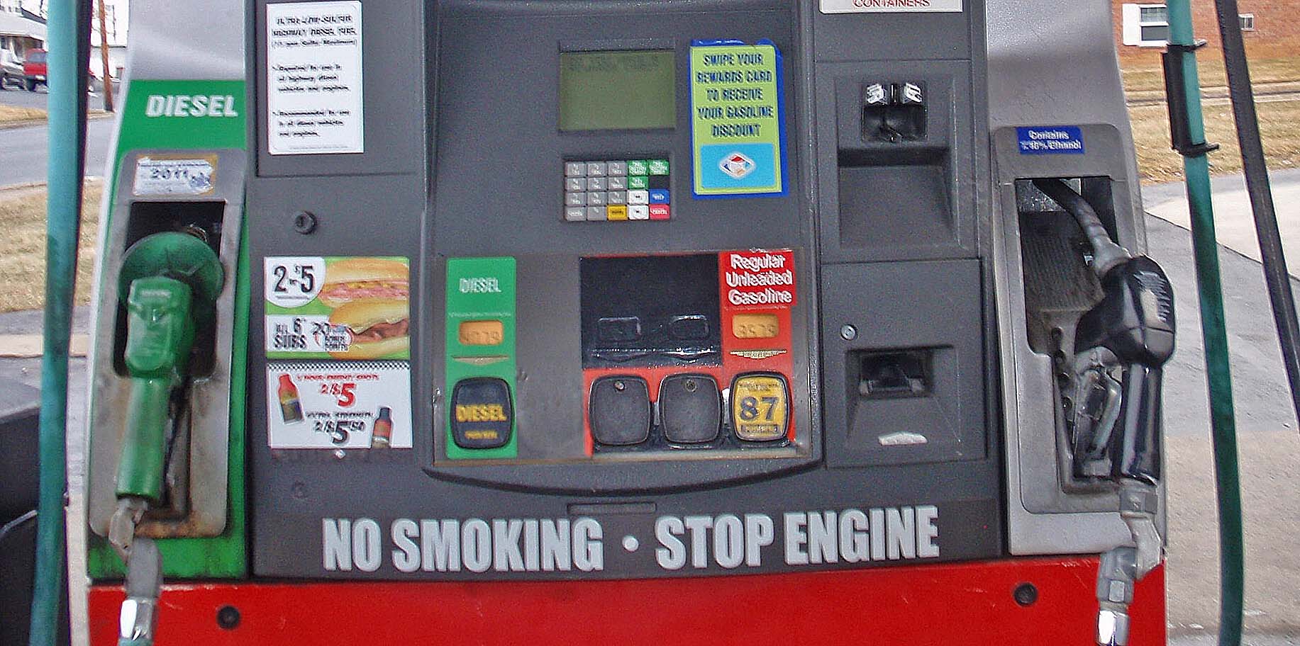

Around here, there is a lever that you lift/lower or there is a flap that the nozzle pushes into. If you push on the flap with your hand, it will shut off the flow of gas as it thinks that you put the nozzle back in.
You can sort of see the flap in this picture:
Aaron Z
/ Static electricity hazard while pumping gasoline #30
Aaron Z

ditto that. the flap is common here.. and it does work to shut the pump down as it thinks the nozzle is back in the cradle.

As Aaron pointed out, the pumps at least in NY and other states I have traveled you can use your hand to shut off the pump. Be it a lift lever or a flap that the nozzle pushes against. It is possible each state has different standards and different pumps and safety devices.
