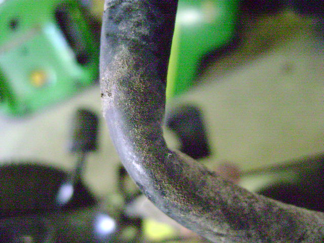

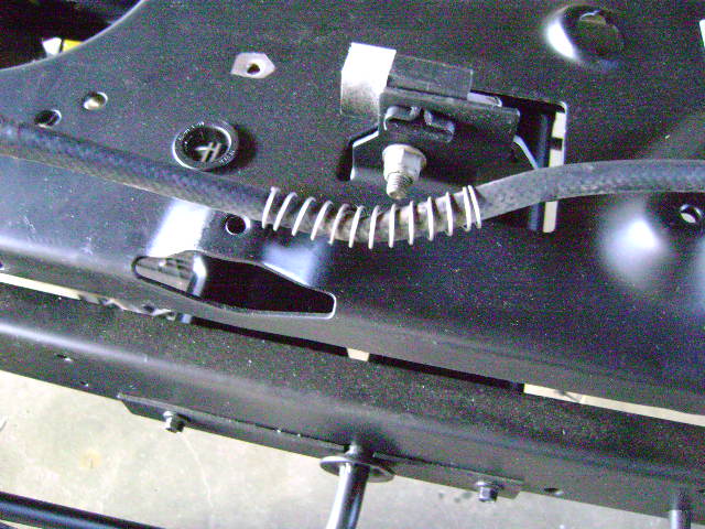

Check your fuel lines I found the line almost pinched shut on my L series when I was working on it, seems the factory bend was a little too tight. I added a spring outside to help hold it open, the better solution would have been one inside.
Try blowing air in the line from the fuel flter back to the tank with the "CAP OFF" to make sure nothing has plugged the line.
