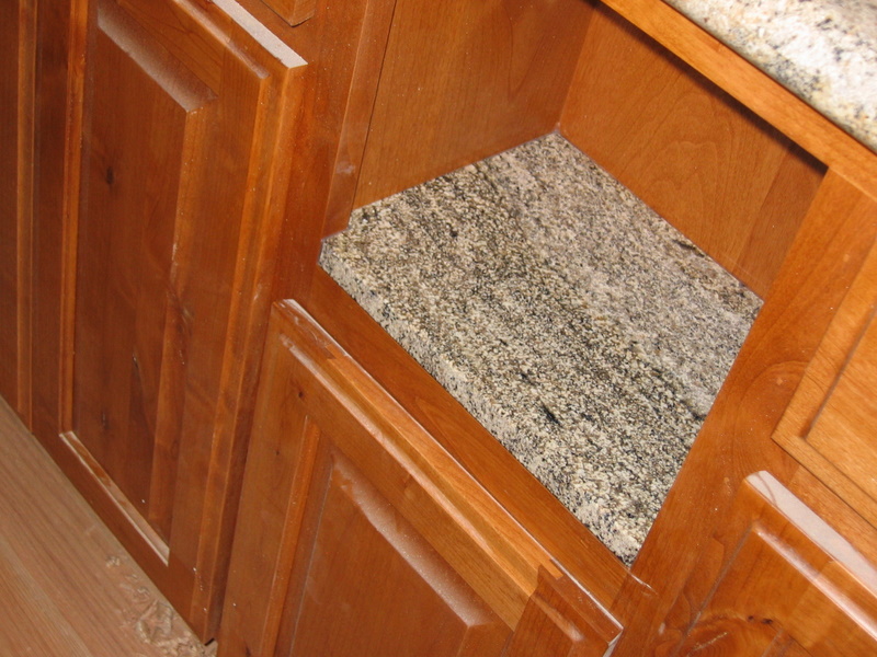

Its been slow. They finally finished the island countertop only today. Cut out the cabinet work for the sink where they screwed up and then put granite on the side (back of shelves under island) to cover it up. Mrs. Alan L. approved the job - she likes it. Now the light fixture does not hang directly over the sink like its supposed to.

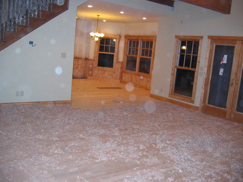

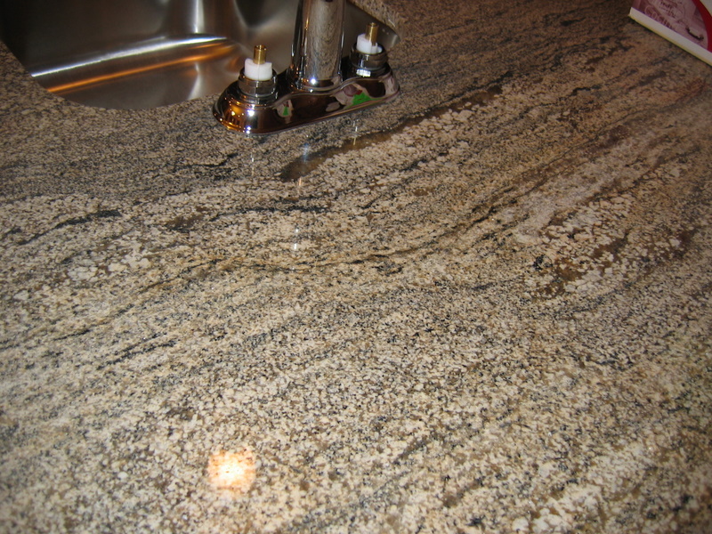

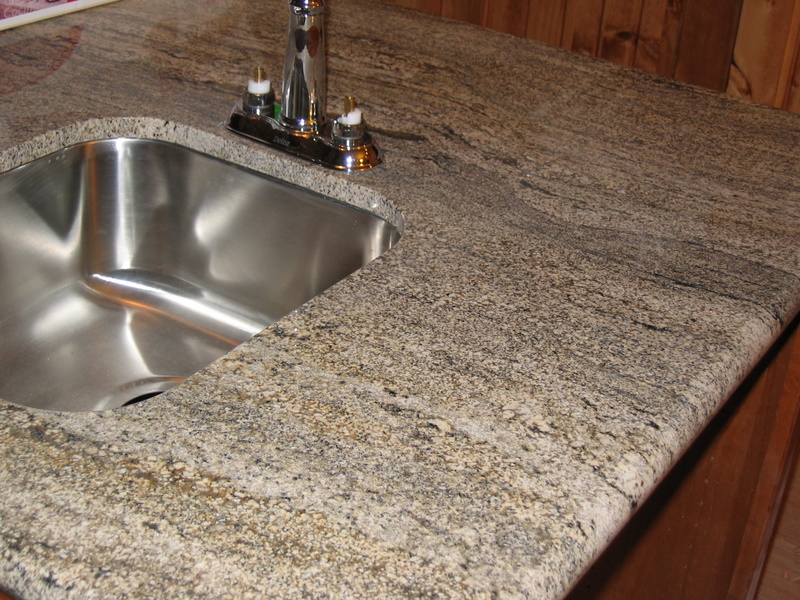

Here are some pics of the tile backsplash in the kitchen and tile in the master shower (no grout yet). Also granite in the kitchen and the large piles of shavings from the hand scraping of the oak floors done today.

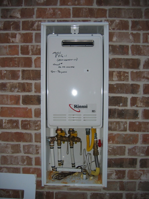

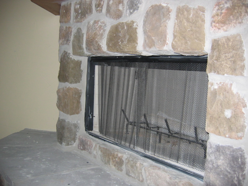

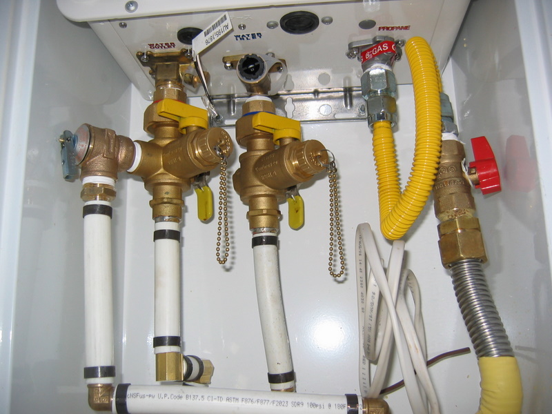

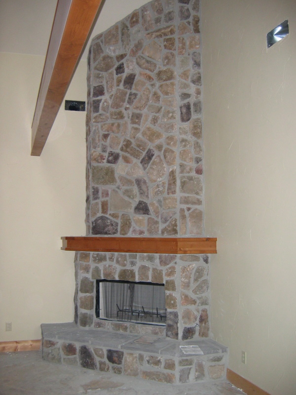

Somes pics of the fireplace and tankless water heater. Today I ordered a 250 propane tank which we will purchase (used) for $300 rather than rent for $65 a year. We are going to get it filled up although our only uses for propane are the water heater, fireplace (starter only) and outdoor propane grill.

The countertop color is terrific and things in general look like they are coming together. I know exactly what you mean about having a house with no furniture. It took me six months to get the minimum and another two years to get things like I really wanted.

You're going to love the hand scraped wood floors. They really look impressive when they're finished. Have them scrape some scrap flooring and stain it just to double check your choice of color. It will look dramatically different (much darker) on the scraped floor then on any smooth store sample.
We get a ton of compliments on our scraped floor.

The pine trim and alder cabinets, beams, and mantel all have Cherry stain and flat lacquer. The oak stair trim is special walnut, as will be the oak floors.
I'll get some more pics of the window trim and such. The picture showing back into the dining room shows the walls above the beadboard not finished. They are putting wallpaper there, but the living room and everything else is painted/stained. The walls in the living room turned out lighter than we had hoped, but its growing on us.

They scraped a section and stained it ahead of time and we decided on that. Overall it was not too dark, just the distressed parts took on the darker color. We'll see how it turns out.

Alan, any pics of the guys scraping your floors? As a retired woodworker who has never ever dealt with scraping hardwood floors, I'd sure enjoy seeing the implement used.

Unfortunately we did not get pics of the guys scraping the floors. But it was 2 guys, each equipped with a tool that had a convex blade about 2" wide at the end of about an 18" steal handle. They would put the left hand on top of the blade and pull it back toward them with the right. They did 900 square feet like this, all on their knees. They appreciated the 62 degrees I had the thermostat set on for the purpose of reducing the humidity before finishing the floors. LOTS of work, but they said they love doing it.
