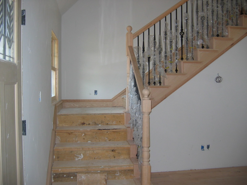

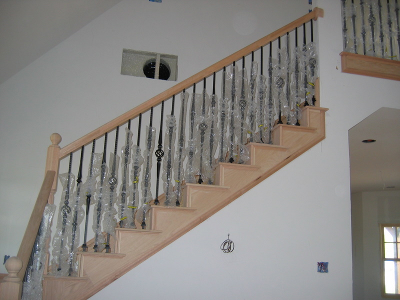

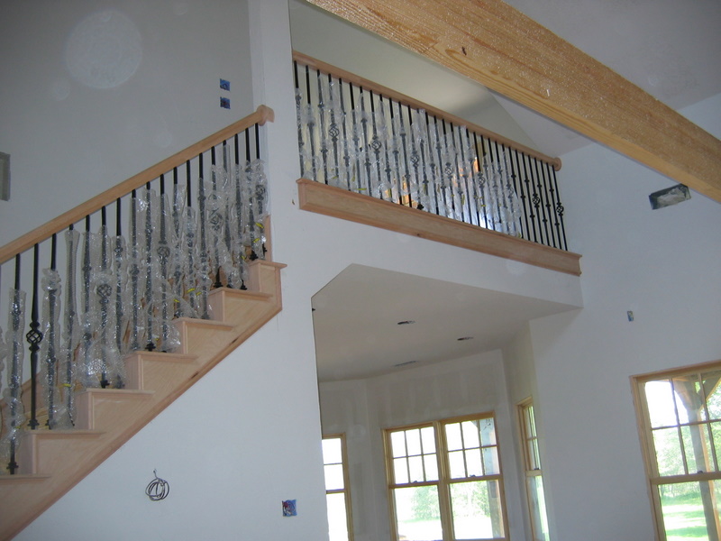

Stairwork and cabinets. We also got the hardwood floors down (unfinished), but somehow we didn't get any pictures yet.
The trim carpenter is showing up Thursday.

   / Starting New House Finally! #179
Real pretty stairs Alan, and I always always apprecite a landing. It is much less fatigung to walk up a set of stairs if there is a landing, it gives you a little rest, so much easier than straight up.

Rox, on the stairs, the landing just happened because its the only way to get enough climb in the room available. Based on a mountain cabin we stayed in we put a window near the landing, so one can sit on the stairs and look out at the pond. However there is a hopefully minor issue in that the stair trim comes right to the window jamb leaving no room for the lower casing trim on the window. Hopefully the trim guy can figure out something to do with it.
