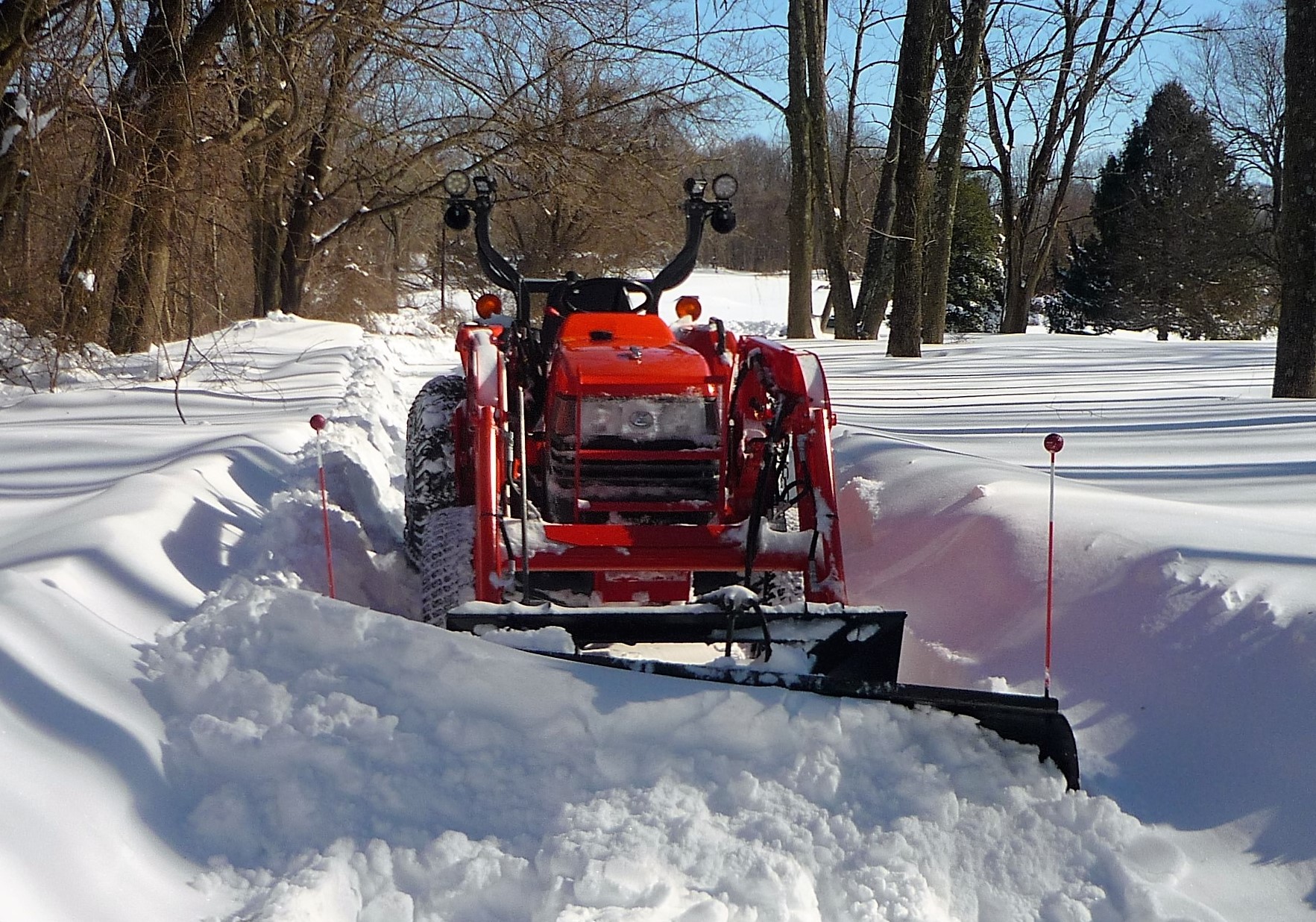

The truck plow is nicest to use, comfort-wise, but a tractor with a front plow on a SSQA loader will do the job, and you can lift/tilt the plow up to push snow into high piles if needed. A rear blade will maintain the gravel drive. A post hole auger will make fencing easy. A loader is... very useful, and pallet forks are handy. Very. A 6' rear finish mower will make mowing go quickly if it's mostly open ground. A modest 4WD diesel tractor will be a good investment over the years, and if you get and maintain a Kubota, it will hold its value.
My "avatar" photo is of plowing a 30" snowfall off a gravel lane. A plow truck was tearing up the gravel, but my carefully adjusted plow did the job with little damage.

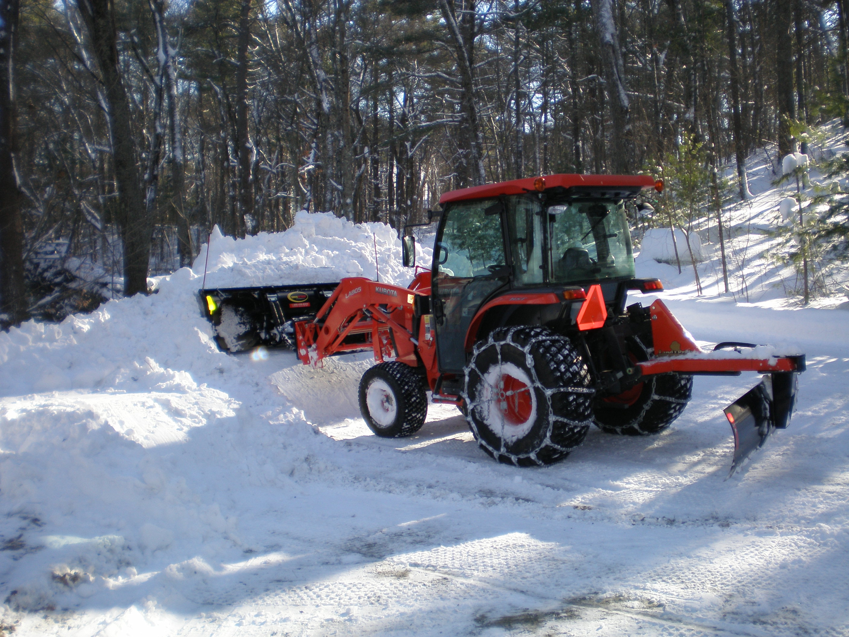

Varmint, you need a cab on that thing. I plowed my 1000' gravel driveway with an open station for years, now I have a L3560 HSTC and love the heater and the AC in the summer. P1280013.JPG
