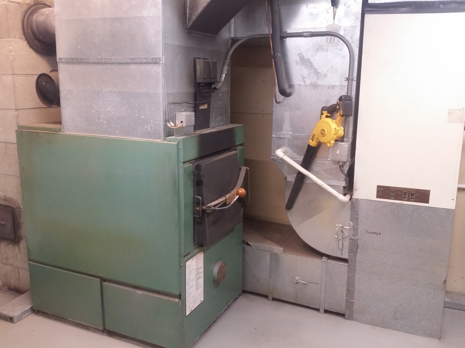

I follow what Piloon, PMSMechanic and others have mentioned about regularly burning a hot fire. We have a 40 year old RSF wood furnace that does 99% of our heating. It is tied into the same hot air duct work and uses the fan from the 25kw electric furnace, which is used a few days in the "shoulder" seasons. Here is a photo of the setup:
This is a video showing the draft in the chimney after adding wood:
20200109 Wood Furnace startup - YouTube
The centre of the masonry chimney(that has a stainless steel liner) is 18" from the vertical stack out of the furnace. The chimney length is about 30'. I left the furnace door open a bit to show the flames in the chimney. The draft on the wood furnace is thermostatically controlled and opens the air inlet on the front of the furnace. If there is a power outage the inlet will close. There are two sensors in the plenum above the furnace door. One turns on the electric furnace fan when it is warmed up and will shut off the fan if the plenum cools. If the plenum gets too hot the other sensor interrupts power to the air intake device, thus closing off air to the fire. But the air intake never completely shuts off all the air.
It took a couple of years to figure out how to run the system. The furnace has a large fire box. For one of the first fires we turned up the thermostat, filled it with wood and let it go. The house warmed up and the air intake closed. But the furnace was full of hot coals so the temperature kept soaring in the house. It was -27C outside and we had every window and door open for a while. We've since learned how much wood to put in at one time according to how cold it is outside.
We also plan the nightly fires so the house is fairly cool in the morning. That way, we can put in a lot of wood for an initial hot fire to help clean the chimney. I try to use faster burning pine, spruce or poplar as opposed to slower burning but higher thermal content wood such as birch and fir. I also use the smaller split pieces for the first fire most mornings.
We normally had our chimney swept and inspected each year. A couple of the sweepers said we can easily go two years without sweeping the chimney because there is virtually no built-up creosote. At least here, people seem to be getting out of the chimney sweep business. I have been unable to get one for the last two years and bought my own equipment this year. I'll use that in the spring.
My neighbour is a mason and works with a fellow who had a sweep business. His liability insurance was $4,500 per year. It's hard to make much of a living with those up-front costs.
Most of the people in our area use wood for their main heat. Houses have masonry chimneys but, when a house changes hands the insurance companies insist that a steel liner be run in the chimney. We were lucky in that the previous owner had to do that. It cost quite a bit because the installer(our chimney sweep) had to break out the clay tiles to make room for the liner.
The dangerous creosote is the shiny black stuff. The dull grey creosote is not so bad.
I believe the other key to avoiding creosote problems and for easily starting fires for that matter, is well-seasoned wood. I burn wood that has been stored under a roof for three years.
The last chimney sweep I had(and who has quit the business) used the Sooteater system and cleaned the chimney from the bottom up. He took the elbow off between the furnace and chimney and put his Shopvac hose in the chimney elbow and slowly ran the Sooteater up and back. There was no mess at all.
I've digressed from "Starting a Stove Fire" so this will get back on topic. Another tool I use for restarting a fire that has good coals is the small DeWalt shop blower shown in the photo of my furnace. It works great.
