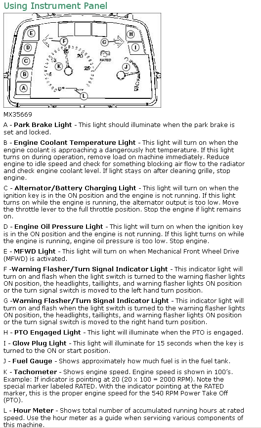

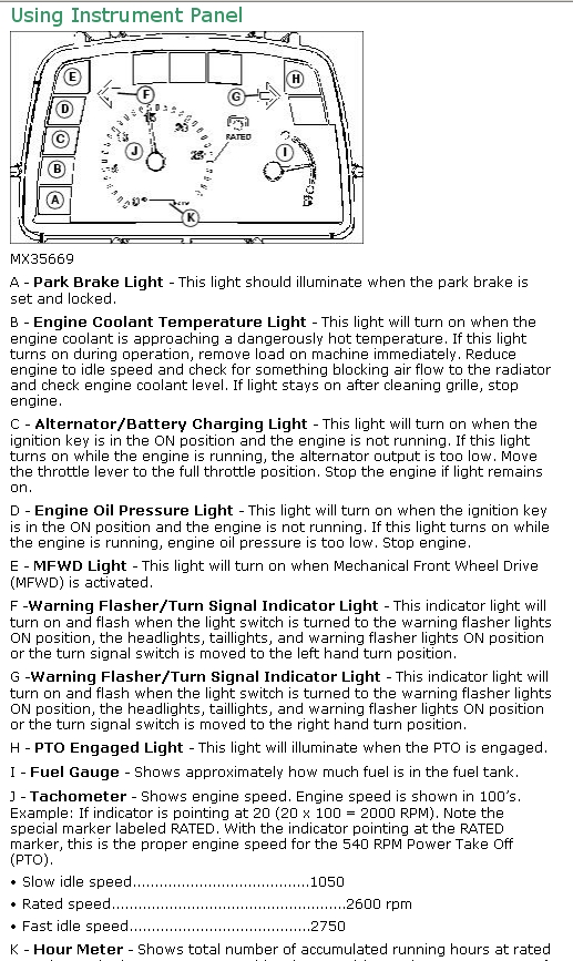

Note how the manual for the 2520 specifically does not show a preheat light, unlike the 2720 manual which does. Based on comments here I'm guessing earlier 2520 with the air heater did have a light, while later glow plug ones deleted the light, along with instructions on using one.
Air heaters and glow plugs do not make noise. Clicking is typically an electric fuel pump.
