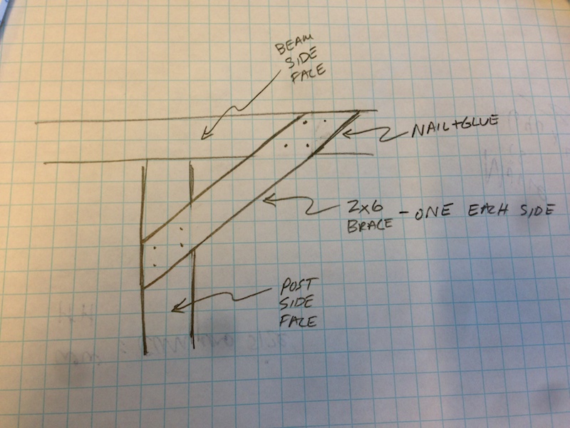

I really don't like the look of the hanger. I know the beam needs some bracing (beam / back down to the post). I am thinking something along the lines of this.

Another good way to do a corner brace is by face nailing a 2x to each side of the corner, again on a diagonal. You get lots of surface area for the nails to act on, and can put a gob of construction adhesive in there as well. In the end it's very similar to a gusset plate.

S219 - Thanks for the comments. I had planned on rigging up a jig for the router and notching the corner braces into the post and beam, but your comment has got me thinking.
"Corner brace by face nailing a 2x to each side of the corner"
If I am reading your comment correctly, do you mean taking a piece of 2x lumber (2x6 in my case) and essentially mounting a piece on the underside of the beam and then a piece on the vertical post. These would be cut at 45's so when you mounted the corner brace you would essentially have a "triangle" brace assisting to support the beam.
Is my thinking correct? I think I can see it in my head and it may be a better (easier) approach then breaking out the router.

That's what I would call "blocking" and it will help a lot as you are sandwiching the brace in, and benefiting from nails across the grain from your blocks to your posts (blocks can be oriented with horizontal grain for even stronger results). But I wouldn't put a 45 on the blocks -- I'd leave them with straight cuts and instead put a small chamfer on the diagonal brace (basically blunt off the point of the 45 cut) so that it has a flat "seat" on the block. Then any loads from the brace to the block are going to be normal to the nails. With a 45 on the block, loads would want to peel the block off.
When I said face nailing, I meant take a 2x and nail to each side of the post/beam combo, so the braces are on the outside faces of the corner, like so:
That's also a scenario where nailing across grain with lots of surface area, so they will hold well. This method doesn't look as classy, but it works.

You definitely need bracing similar to pic in post #43 - many of the post and beam folks cut angles and use large screws for fastening, although notching or side bolting can also work (not sure of the calculations but have a timber framing book that may have the formulas - will check later today)
