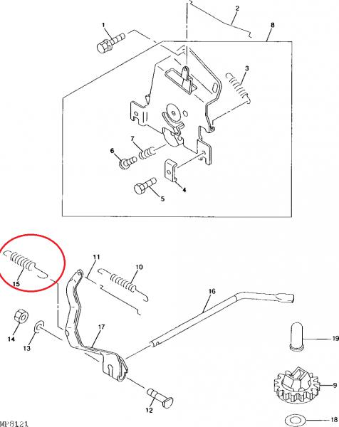

Hey Guys, Can some send me a picture of where a spring goes on a lx178 John Deere. I know it goes somewhere on the govenor, but I can't figure out where. I have the arm and spring on the back end of the carb, but there is another spring that goes on the idle arm and attached to the governor somehow. Any pics would help. Thanks, Denny A
   / Starter Solenoid #9
Can you post a pic? You can download a manual for the FD440V engine at mymowerparts.com
   / Starter Solenoid
Tomplum, I added an attachement of the spring that I was telling you about. It is the one circled in red. I hope the attachement made it
Thanks
