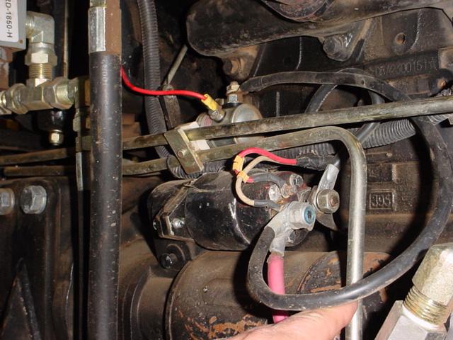

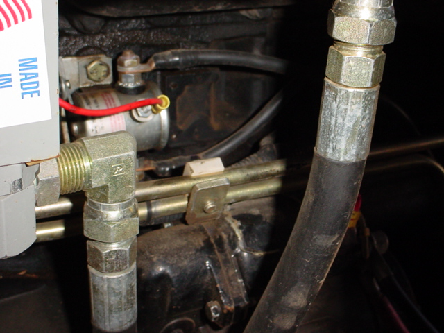

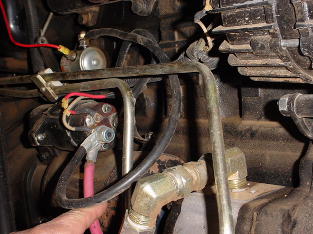

DOH - just like mine, I was too cheap (or lazy?) to replace the starter solenoid. Many years ago I did exactly as you did now, added a parallel solenoid with contacts (relay ;)). Perhaps energizing two coils is too much for the circuit? and that's why the voltage drop? I place my bets on a corroded something somewhere or a high resistance contact. Sounds like your not electronically challenged, so I have no doubts your going to find and fix it. For sure clean up the battery ground to the frame, it's worth cleaning that up regardless if that's the problem or not. Attached are a couple of pics where I located my aux starter relay to the starter solenoid. I picked it up from Granger.
Larry

Larry, I see the proliferation of lugs on the high amperage post (last photo) has left you a few threads short. If that relay you got from Granger as a second low amperage post (typically labeled "I"), you could relocate that small wire. Might get another turn outa the blue Nyloc that way.
//greg//
