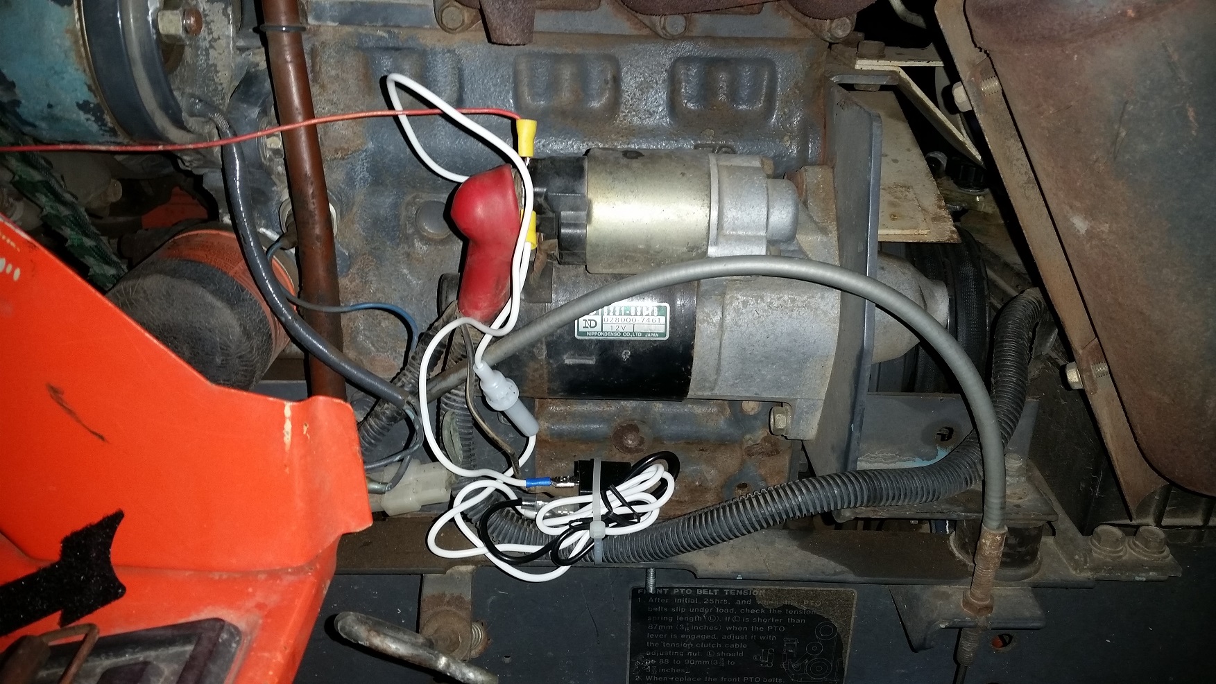

I was having a problem with Kubota starter intermittently failing--turn key, it clicked but didn't spin the starter--worse in the cold it seemed. Tried all the usual checks: battery, wiring, ignition switch, etc. and couldn't find a problem. Could whack it a few times with a rubber mallet and get it to start so I figured I had a bad starter or solenoid; not a huge deal, but not cheap either.

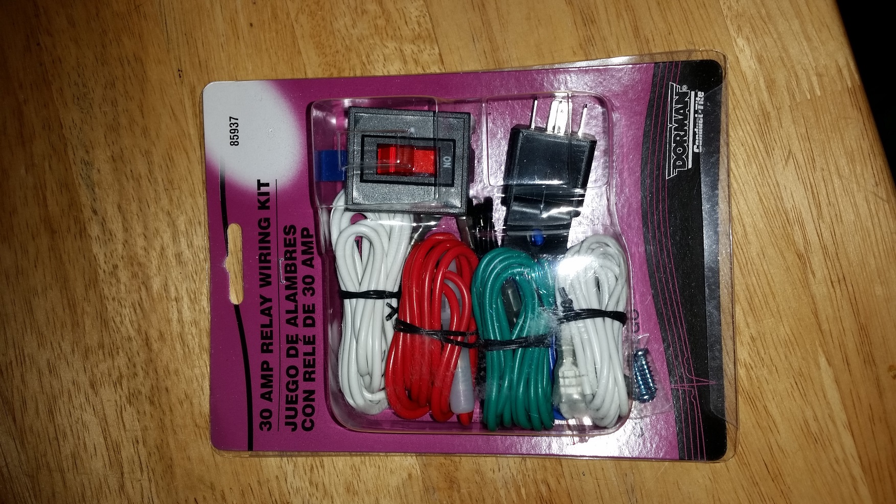

A simple automotive accessory installation relay kit for installing lights, horn, etc. contains everything you need pre-fabbed. I picked this kit up at Tractor Supply for $15.

I followed KUBMECH's directions and had the relay installed in 15 minutes. Presto - the starter engaged perfectly and the engine fired like new! Been fine every start now for a couple of weeks, even in colder weather.
Thrilled with the result, and realizing the kit was unnecessary, I then fabbed one myself and installed on another tractor that was starting to crank a bit slow. Didn't help (turned out to be the starter itself), but will likely prevent a future problem. I bought this 30 amp accessory relay at the local Advance Auto parts store for $6. Used wire and fused connection left over from the kit referenced above.

The short version of installation: the relay has 4 prongs numbered 30, 85, 86, and 87. Connect #30 to the battery side post of the solenoid with a fused wire. Connect #85 to ground (a short loop to the underside of the relay works well if you attach it to the frame). Connect the wire that goes from the key switch into the solenoid (the small wire connected to the solenoid with a spade connector) to #86. Connect #87 to the post on the solenoid from which you just removed the key switch wire.
Start it up, grin from ear to ear, and be thankful for smart people like KUBMUCH who are generous with their time and knowledge! (By the way, I notice on KUBMUCH's profile that he hasn't posted since 2006.)
Here is a pic of my completed install. I might tidy it up a bit by shortening the wires, but this gives you a pretty good look at how accessible everything is.

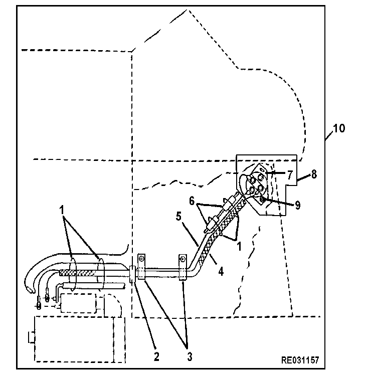

Thanks for sharing this tip. I have to start my John Deere 410 backhoe with screw driver across the terminals of the starter, do you think this would fix that issue as well?
JD offered as parts or factory installed a relay kit to help starter solenoid engagement for tractors as far back as the 80's as yes it will help your 410. And yes extra relay won't help if starter has worn bushings or brushes
