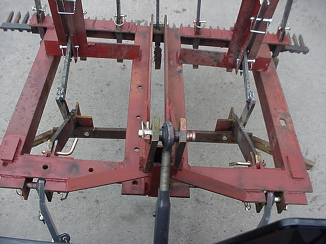

Looks like about 2 or 3 weeks an it should be done. we have snow in the forcast next week, that will slow me down.

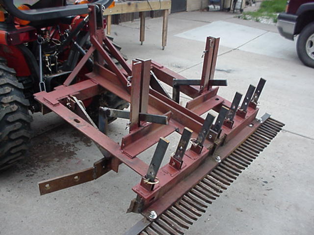

Sunday is the day I'm taking it out, HOPE ALL THE WELDS HOLD!!!

Are you planning to add some gage wheels? I would think wheels would keep it from digging in to much when pushing or pulling.
Can you tell me the approx dimensions of the back rake teeth or what you used for that please?

looking really good .! have you tried it yet ?? are the teeth on the back rake made from rail road spikes ? sorry for all the questions its just i am really glade someone built one....looks like a first class job ..congratulations...

The back rake is 60 inches and made with r+r spikes and the gap between them is about one inch. I got the idea when someone on here was talking about using spikes for a tooth bar. I bought about $40 of new metal (20foot of 1/2 by 1 1/2 bar) the rest is all scrap metal I buy for 25 cents a pound. I'm not sure how much it cost to build but I do know it was under $200. It will be more if I ad wheels to it.
