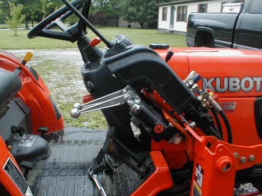

I wanted a auxiliary valve control on the BIG ORANGE to operate home built goodies (Grapple in front and Log splitter rear). So here is one way U can do it if you would like to waste some green and have fun doing it. /forums/images/graemlins/grin.gif

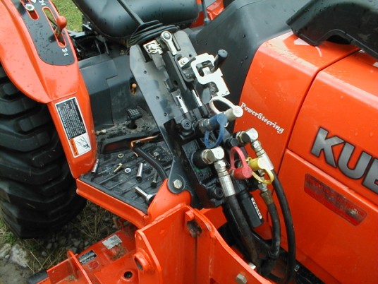

1. Start to break it down and location of valve.
   / Started AUX Valve install on B7800 Saturday!
#2
2. Location of aux valve control.
3. Forget the washers! This is the way to go. LOCTITE.

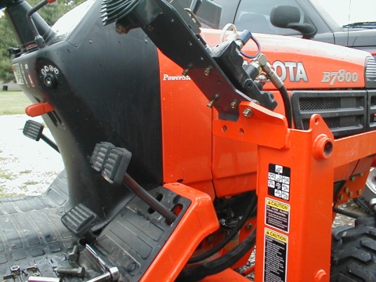

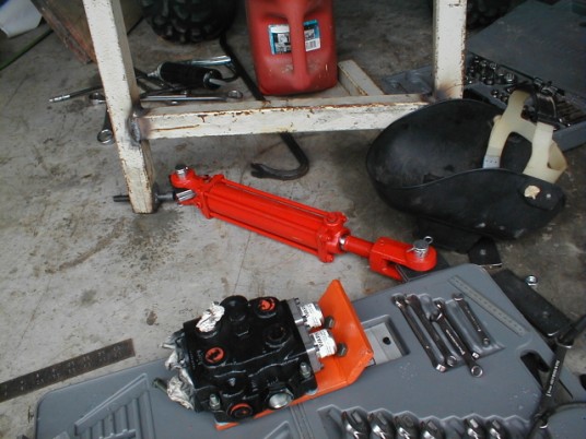

4. Built the bracket and attached to valve. Grapple cylinder shown also.

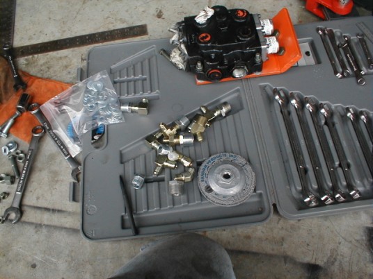

$88 bucks per hand full.....Fitting are expensive.

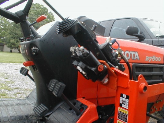

Adding the handles.

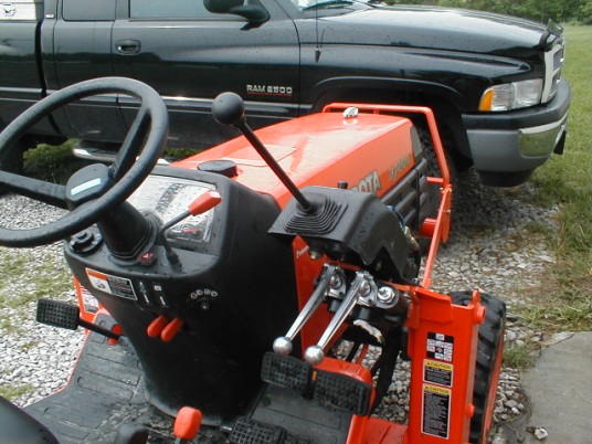

Top view.

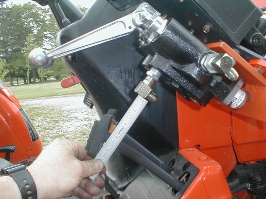

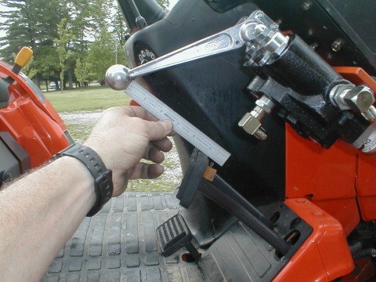

Clearance measurement.
Another measurement.
