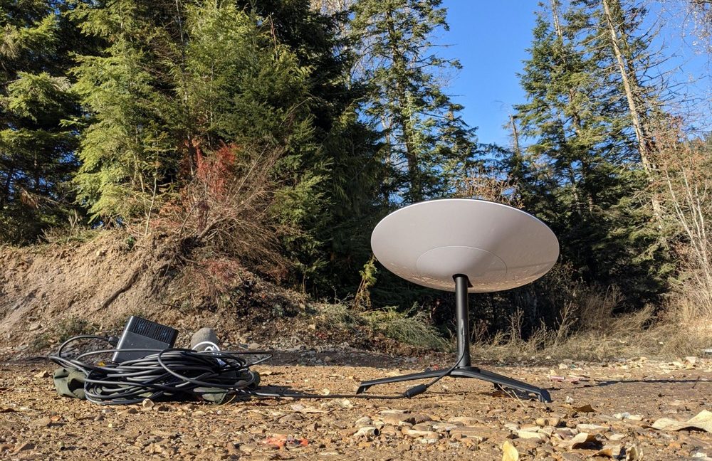

Finally got around to relocating my dish from the picnic table in the side yard to our roof. From the table I had a slight obstruction to the north (a critical area for our location).
The obstruction analyzer said the picnic table was causing a gap in coverage every 45 minutes or so (which was pretty much what we were seeing: they typically lasted only for seconds, but on rare occasions as long as 20 seconds).
After moving to the rooftop, I was on a zoom meeting for 2.5 hours. ("Live" video conferences are a tough test, since you can't buffer those.) The only problem was a single stutter in the video feed which lasted about 2 seconds. (Hard to say whether that came from my end or the folks on the other end.)
