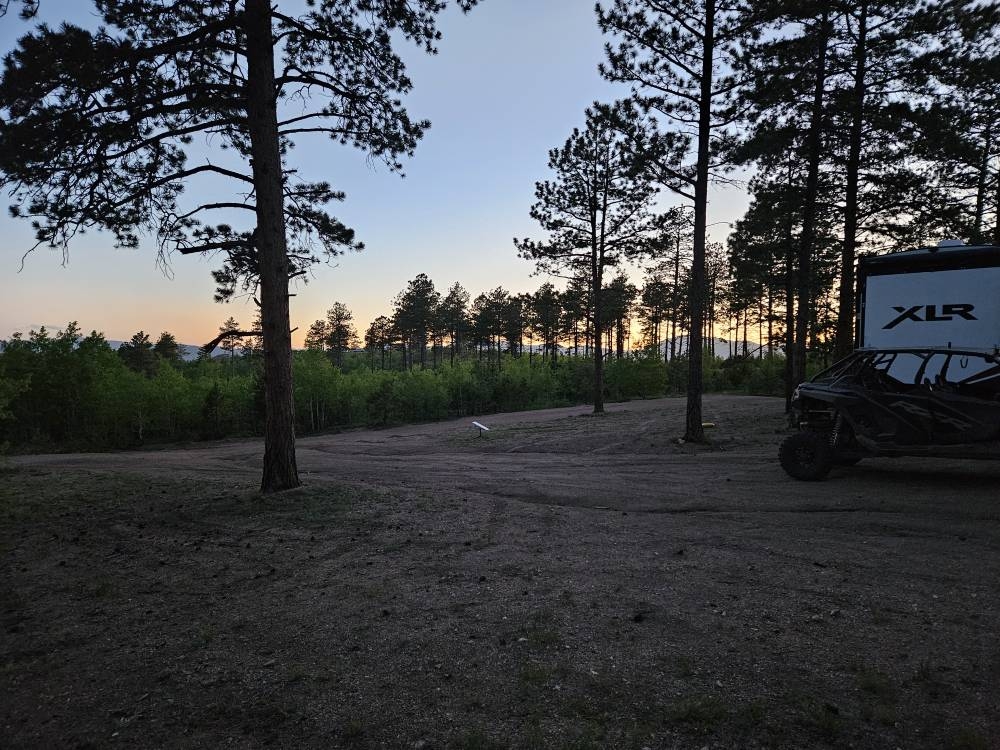

On a recent camping trip my gen 2 dish kept pointing itself into the trees instead of open sky. Still had 99.9% connection though so I just left it there.
