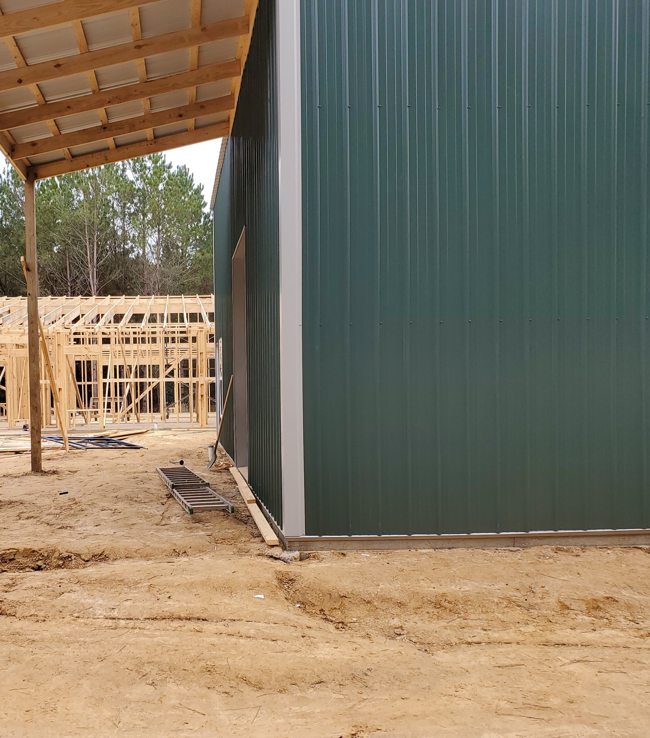

Now I need to drop about $100 for ethernet adapter and either a pole or wall mount. Roofs are metal and none of the typical adapters will work. I'm considering trying on one of the posts of my lean-to. The pole mount is probably too short to help much. This is an old picture, but that far post is north. About 14' high. Thoughts?
I would start by getting up the ladder at the eave with your phone and checking first. (I know, I know, broken record. But really, it is your friend.)
I used an eave mount Amazon.com
and it has worked well for me. I go to a fair amount of effort not to puncture a metal wall. Sealing metal is such an issue.
The Starlink Ethernet adapter is straightforward to set up, just be very nice to all of the cables. No sharp bends and no pulling on them. Gentle is the keyword here.
Remember you probably want Starlink on the southern end of your space/roof to give it the best view of the Northern sky.

Thanks. I wouldn't mess with mount on metal either...i hoped maybe the engineers had a non penetrating mount. So, you remove dish from the feet for that mount? It is cheaper than the Starlink ones. I may have to order the longer cable, for southern post, but your reasoning is spot on. House is north, so cables could be shorter, oh well. I got on the ladder on the other side of the building. 8% or so, but closer to trees.
Yes, the feet come off. I would invest in the Starlink pole mount adapter because there is a few mm or a 0.1" of wiggle between the metric Starlink pipe and the pole mount above. I went with an extra bolt in the eave mount for about a year and then put the pole mount onto the eave mount when I needed to thread a new cable up to Dishy.

You have me wondering if I could mount the sl pole to my lean-to rather than the recommended 'bury in concrete'. That could help get above trees and garage peak. Maybe then I can put sl router in shop and run cat 6 from adapter to the house. I may already have enough.

I saw those. Roof has to be flat. Most (all?) metal roofs have ridges. I like that they keep innovating though.
   / Starlink #3,910
I would pay attention to wind. Some areas get hurricanes/tropical storms, others tornados, and some just have high winds. I think that your Dishy will thank you if it isn't exposed to peak winds on a roof ridge. Part of the reason I went for the eave mount... the other part being better visibility there than on my ridge top. "The app is your...";)
