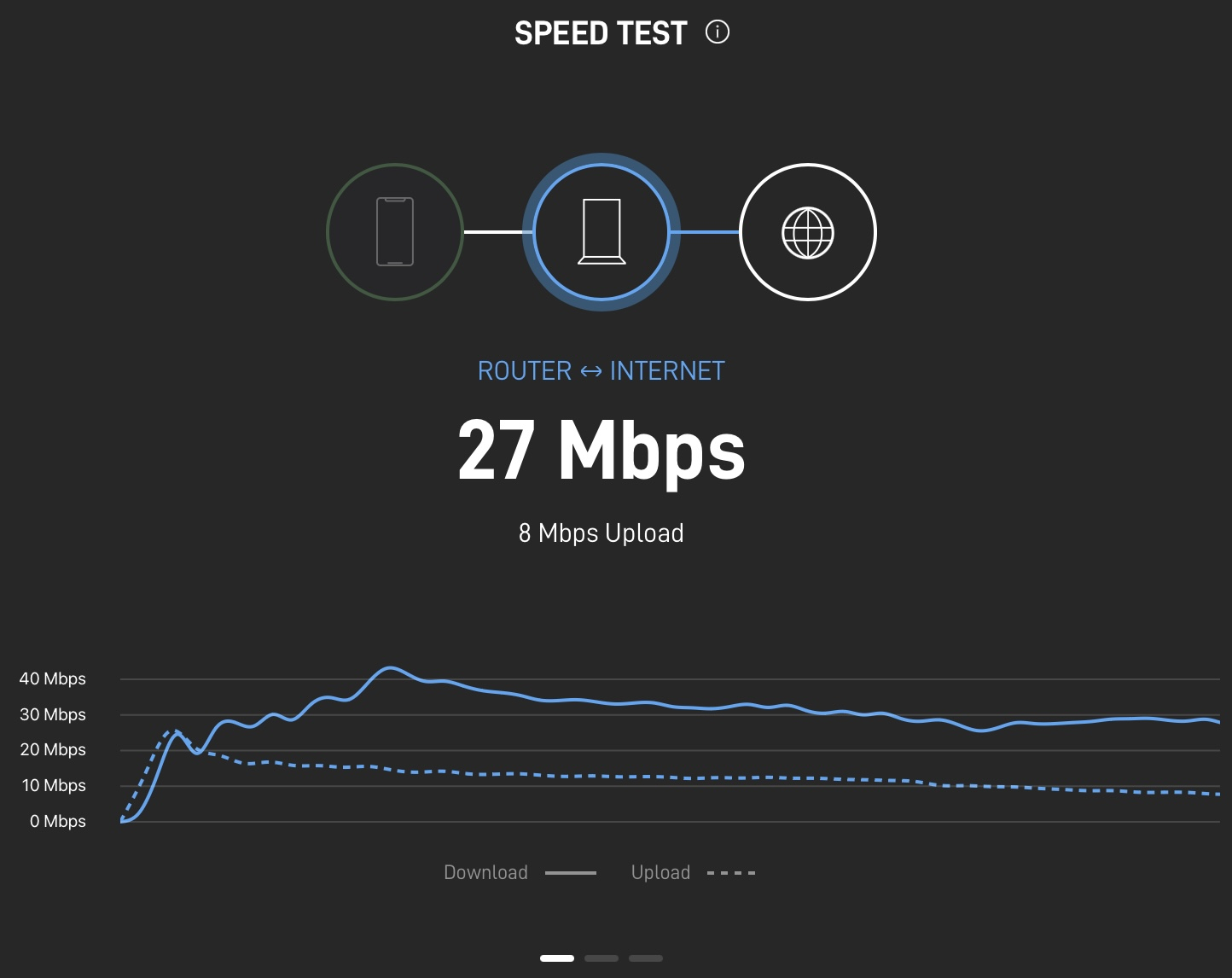

Noticed mine is pointed a little bit east, and getting 97Mbps right now.
/ Starlink #3,422
Interesting. I hadn't heard of anyone on standard residential service being below about 75 Mb/s on an average basis. Also interesting that the dish reoriented and has better speeds. Cool.
We very rarely break 100Mbit/s; most often Starlink service is in the 25-40Mbit/s range. That's way better than our previous, and unreliable, AT&T DSL service. We are happy, though, we would certainly appreciate faster service.
Our dish did recently reorient slightly from NNE to NNW, and the performance does seem better. What is outstanding is the uptime; we rarely have dropouts.
