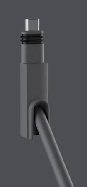

I know the cable going into the dish (rectangular one) can be unplugged, but how do you get to it? The cable currently goes into the bottom of a short piece of pole that goes into a ball joint which is embedded in the dish. I can't see where it connects nor how to get the pole/ball joint apart. Can anyone tell me how to do this so I can run the cable thru the wall? Also, what do you use to seal the hole in the wall?
/ Starlink #3,117
Its a long plug. Simply pull it out. It looks like its apart of the pole.
/ Starlink #3,118
The cable unplugs from the open end of the pipe. If you look closely, there is a molded piece that matches a groove on the pipe. You pull gently along the axis of the pipe.
Starlink has a line drawing of it here, on page four.
Good luck. My two cents is not to yank on the cable hard. Use long nose pliers if you have to.
All the best, Peter
/ Starlink #3,119
Thanks, I got it out. Looks like a 1" hole is needed to pass thru the wall. Any suggestions on how to seal the hole in the wall?
/ Starlink #3,120
Starlink sells an installation kit - or at least they did back when I was installing mine. Includes an extra long drill bit, a plastic "grommet" of sorts (maybe two of them, on for outside and one for inside of the wall I can't recall and am not home now to look). Onec eI had the cable through, I shot expanding foam into the hole prior to placing the grommets, then a bit of silicone caulk around the edges of the grommet and in the center where the cable passes through to make sure things were sealed up.
