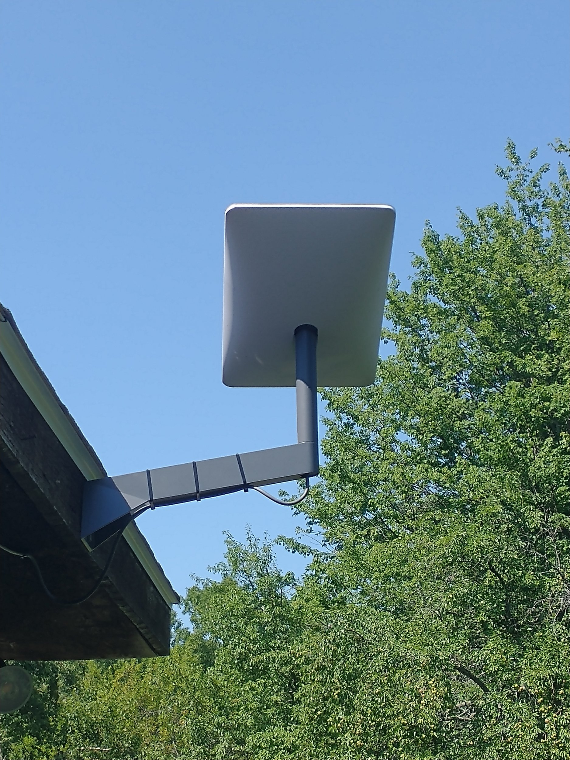

My dish points within a couple of degrees of true North (about 13 Deg from magnetic North), with a 30 degree slope towards the North.
