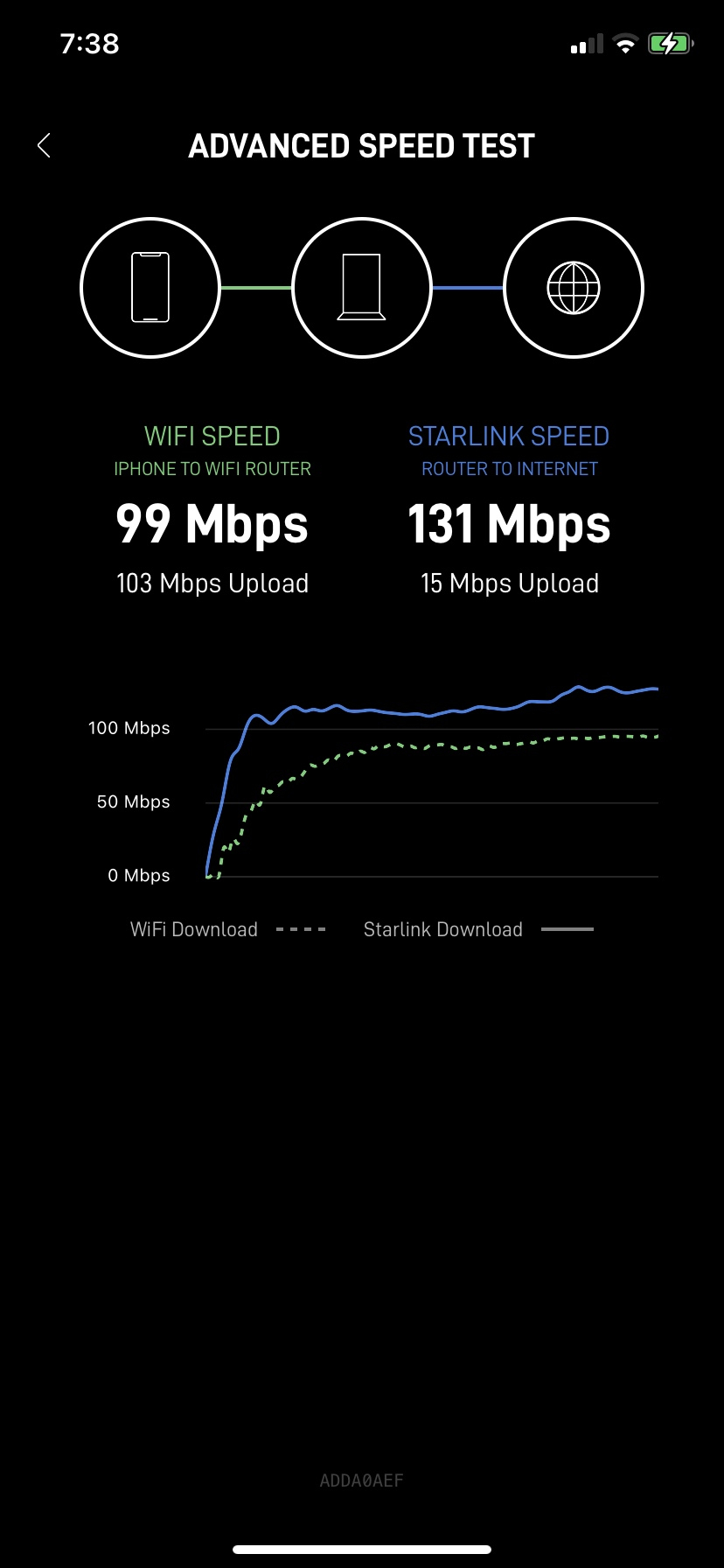

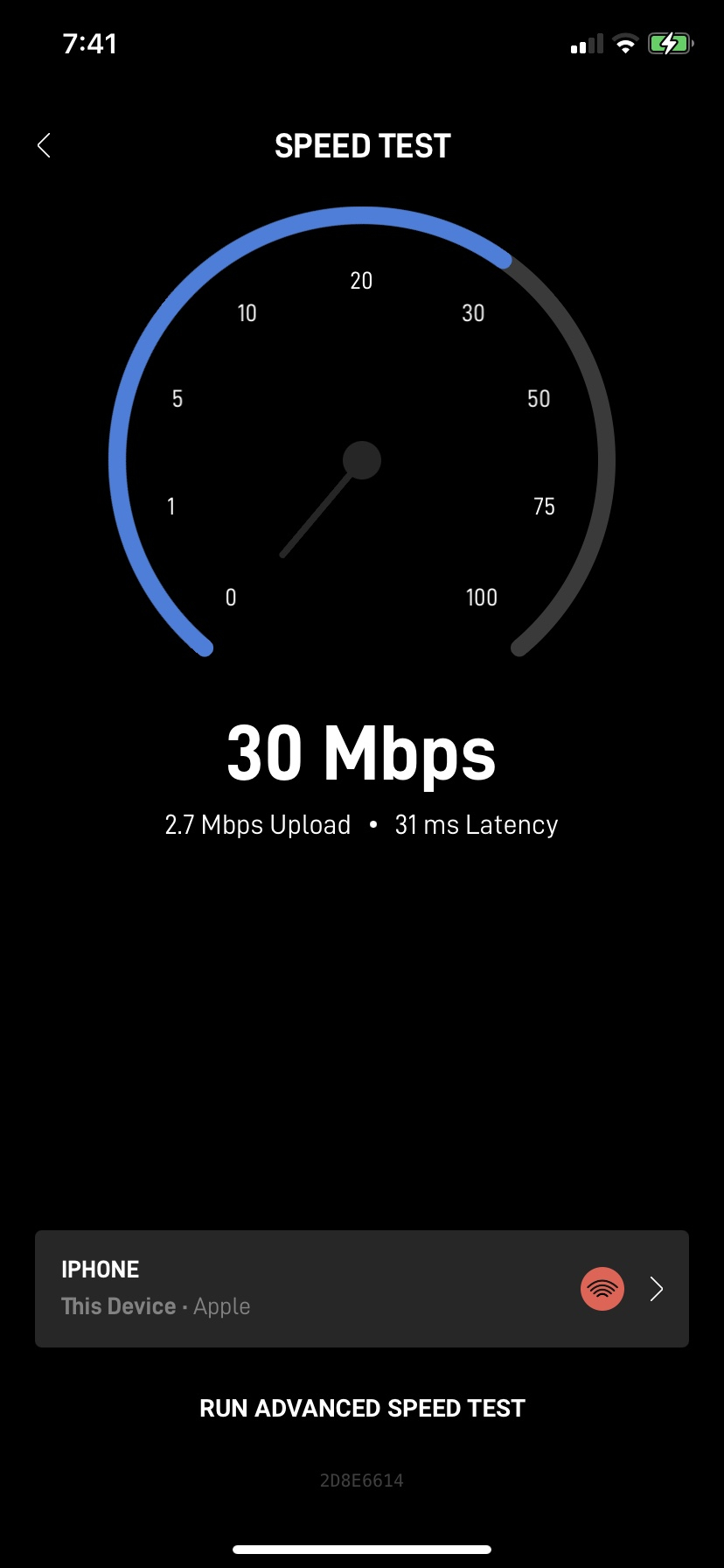

My normal speed test showed 30 Mbps, then it gives you the advanced option. I got 131Mbps to router and 99 Mbps to my phone. Wonder why the difference.

My normal speed test showed 30 Mbps, then it gives you the advanced option. I got 131Mbps to router and 99 Mbps to my phone. Wonder why the difference. View attachment 785909
I have noticed that repeated running of the speed test tends to improve the reported speed. Whether it is some "auto-speed reduction" algorithm, or real, I don't know. I do know that the advanced speed test "router to internet" section is the one that I pay attention to.

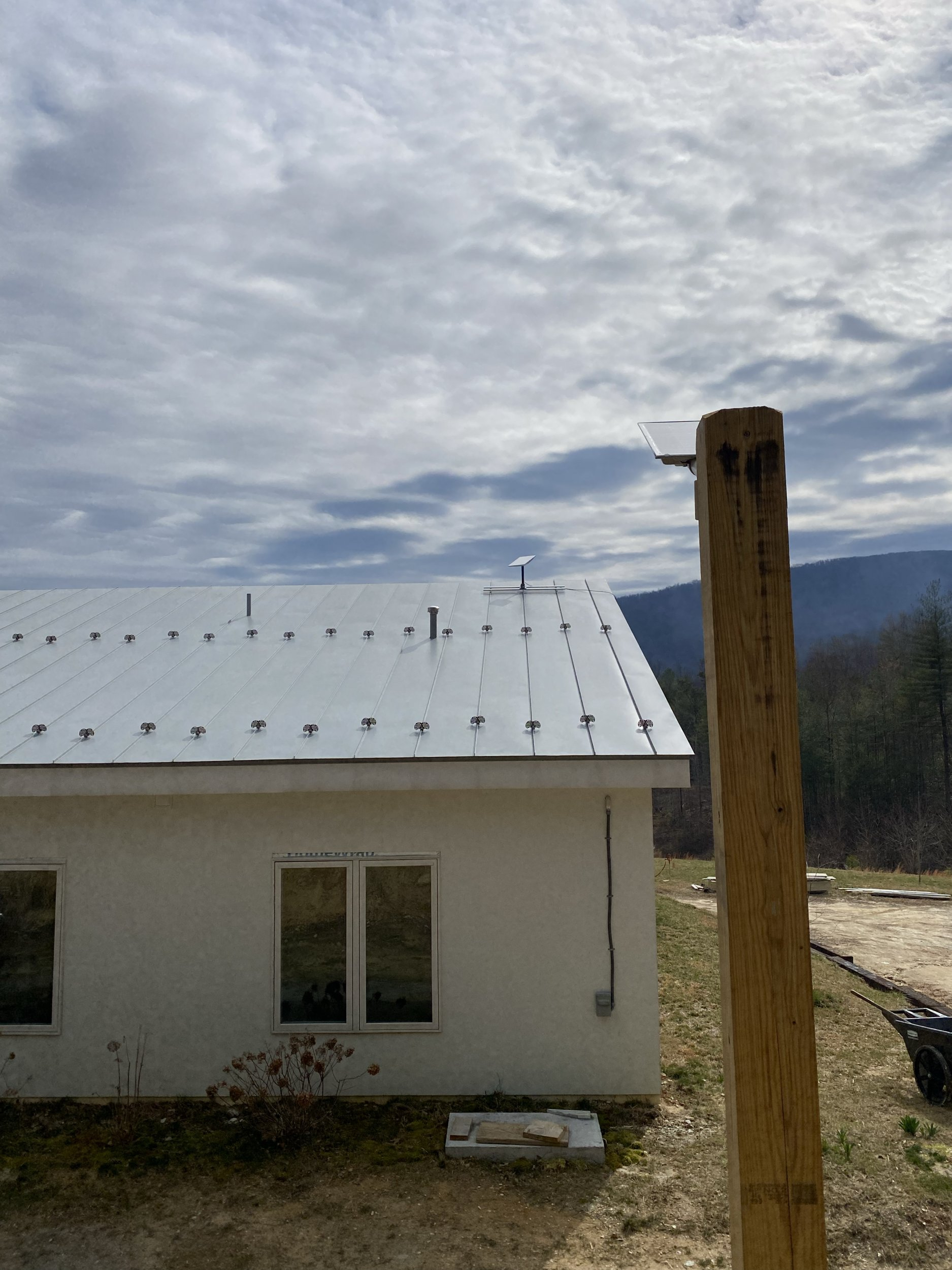

/ Starlink #3,548
Inlooked for the advanced test option but I don’t have it.

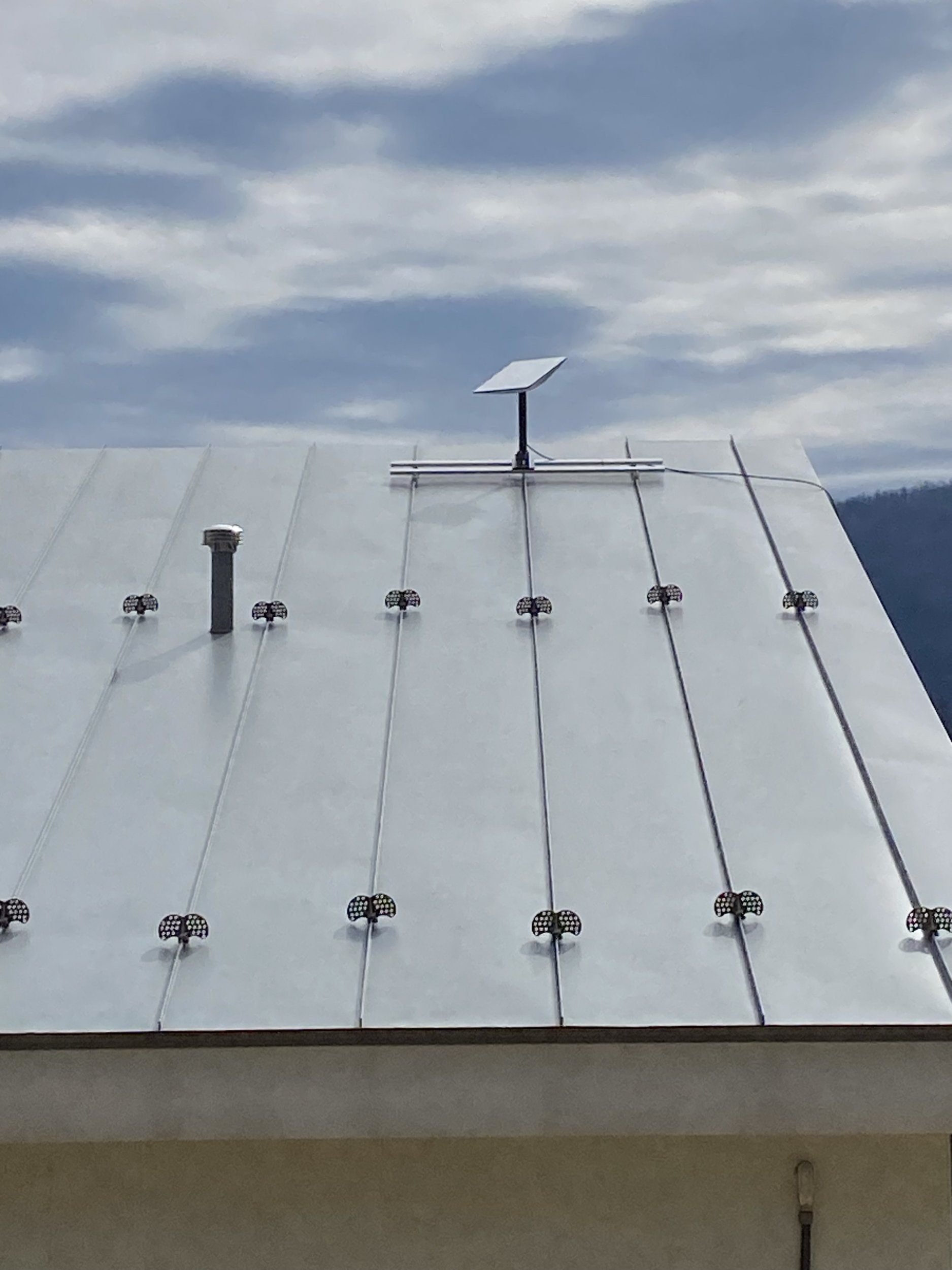

Here is a shot of the new orientation of dishy. The seem on the roof is about 3 degrees north facing. And that was about what dishy was pointed to before. Now it is about 43 degrees NNE.

@WoodChuckDad The advanced speed test option comes up if you click on "Statistics" then scroll down to "Throughput", and click "Speed Test" there, allow it to run the full speed test, and then, finally, a new option appears at the bottom of the screen after you run the basic speed test that is labeled "Run Advanced Speed Test". Yes, it is a little hidden.
Also filed in the hidden secret handshake section is that if you go to Settings>Advanced > Debug Data, there is quite a bit of information about the status of the system, including the ping time to the router, and the ping time from the router to Dishy ("Cable ping latency"), as wells as the percentage of lost packets, the status of the LAN link, and a wealth of other information.
Try putting your iPhone in airplane mode for a minute then turn off airplane mode. When you run the advanced test again you should see a lot better numbers to the router. I do not know why but that works for me.

Thread drift warning!
What are those things in a row on your roof?

Wired connections are always better than wireless. Especially with respect to WiFi. Think of wireless like a room. If there are 2 people in the room you can speak & hear really well. There may be occasional airplane noise or something outside that room that causes interference. Add 20 people to the room all talking & it gets really hard for the original 2 people to communicate. They can still do it, but background noise will often make it hard to hear. You can still get outside noise as well. WiFi works exactly the same way. 2 devices in the middle of nowhere with no interference will be really fast. Add in more WiFi devices (doesn't matter if they are on your network or not) & they start interfering. Any RF interference from electronics, microwaves (they operate at the 2.4ghz frequency WiFi usually uses) will cause problems as well.
I can have very high end WiFi gear sitting a few feet apart & get inconsistent results just because something else happens to transmit when I'm doing testing. So seeing different performance from your iPhone to the Internet vs the wired router to the Internet is quite expected under most circumstances. I live on 5 acres off a dirt road & still get noticable WiFi interference a lot. Anybody in suburbia will get more, living in an apartment with everybody having WiFi will be really problematic.
Using 5ghz instead of 2.4ghz WiFi help. 5ghz has more bandwidth & shorter range. The shorter the range the better as it means your neighbors WiFi is less likely to interfere with yours.
