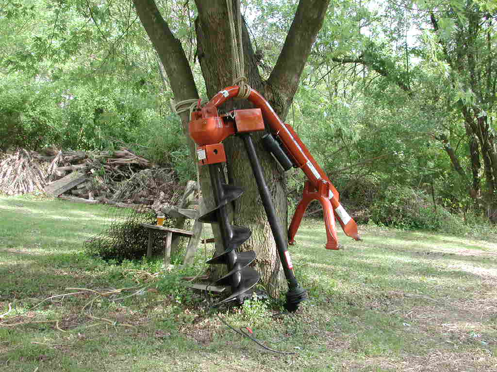

So many neat man made PHD hangers!
Guess I'm a tree hanger at heart...even though over winter I hang mine from a rafter in the shed.
Since no one posted a picture of a tree hanging PHD yet (At least I don't think anyone did) here's what I do. Just a piece of rope, nothing fancy...works quite well. /forums/images/graemlins/smile.gif

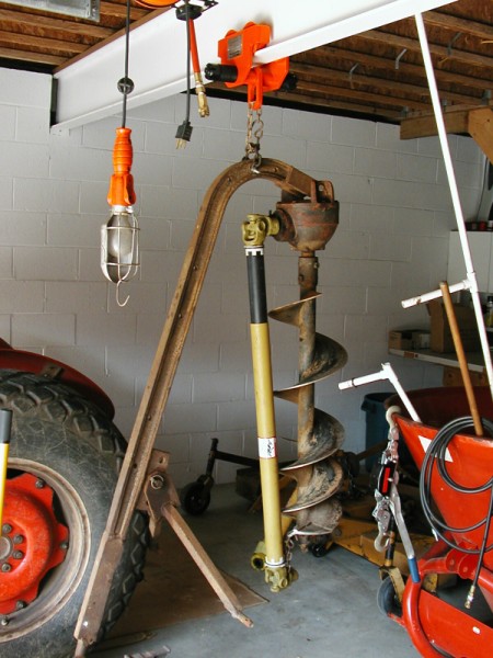

Hi Doug, Well I ended up using the beam support in the basement of my Bank Barn, Put a beam trolley on it and I was a little suprised while the tractor was almost at full lift it was high enough to just chain it to the trolley. I just hook it and release... Nice to roll it outta my way... /forums/images/graemlins/smile.gif
Please no comments about the custom home-made Digger, I bought it local from the OLE Farmer that made it... I works smooth as butter and the price was right /forums/images/graemlins/wink.gif
135, That is another great idea! BTW, I think that auger looks great. Home made? Wow. Where did you get that trolley ? Thanks for sharing.
