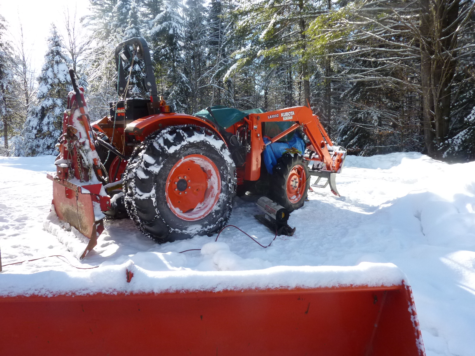

It's been so cold I haven't even tried to mess with my gelled fuel problem. This morning was 3* F above and it got up to 15* by noon. Figured this was my best chance. Snow tomorrow then back to 25 below for the weekend. I just followed the directions on the 911 Power Service bottle except I put it in the tank yesterday and let it sit for a day. Today I did the filter thing, made a little tent over the tractor, and ran my salamander heater a couple hours for extra insurance. It started just like it was summer - I never thought clear fuel could be so beautiful. I won't let this happen again. Once is enough. I will never use month old fuel in December again.
Now I am a Power Service fan !!!
