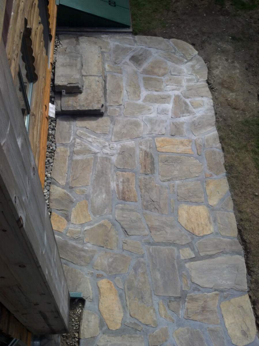

You could check out pavingexpert.com for the definitive how to on all things flat and walked on. I consult this encyclopedia often and enthusiastically with wonderful results. I just did a stone patio. Take a look ....

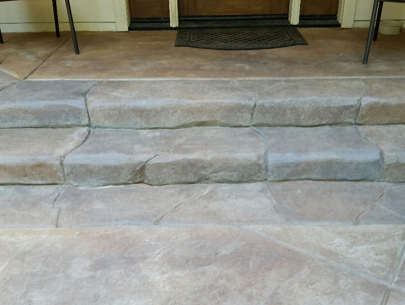

Last summer I had some walkways, a front porch and a front patio done in stamped and stained concrete. The front steps were hand carved to look like stone. I'm a big fan of stamped concrete as it's not much more than regular flat work. It's not very complicated as all they do is lay rubber pads with the pattern you want on top of the concrete after it's set then tamp it down to transfer the pattern. We went with natural stone. You can stamp concrete to look like almost anything and with stain it looks very much like what you're trying to duplicate. Many concrete outfits do it so it's not hard to find a local pro in most areas. Yes like normal flat work regular control joints were also cut into the concrete after it was poured to minimize any cracking. You can even stamp it to look like pavers if you want, or natural stone or bricks, or whatever comes to mine. Overall it's probably easier than doing a proper job with pavers and there won't be any weeds. Curved winding walkways, radiused corners etc. are all easy to do to.
