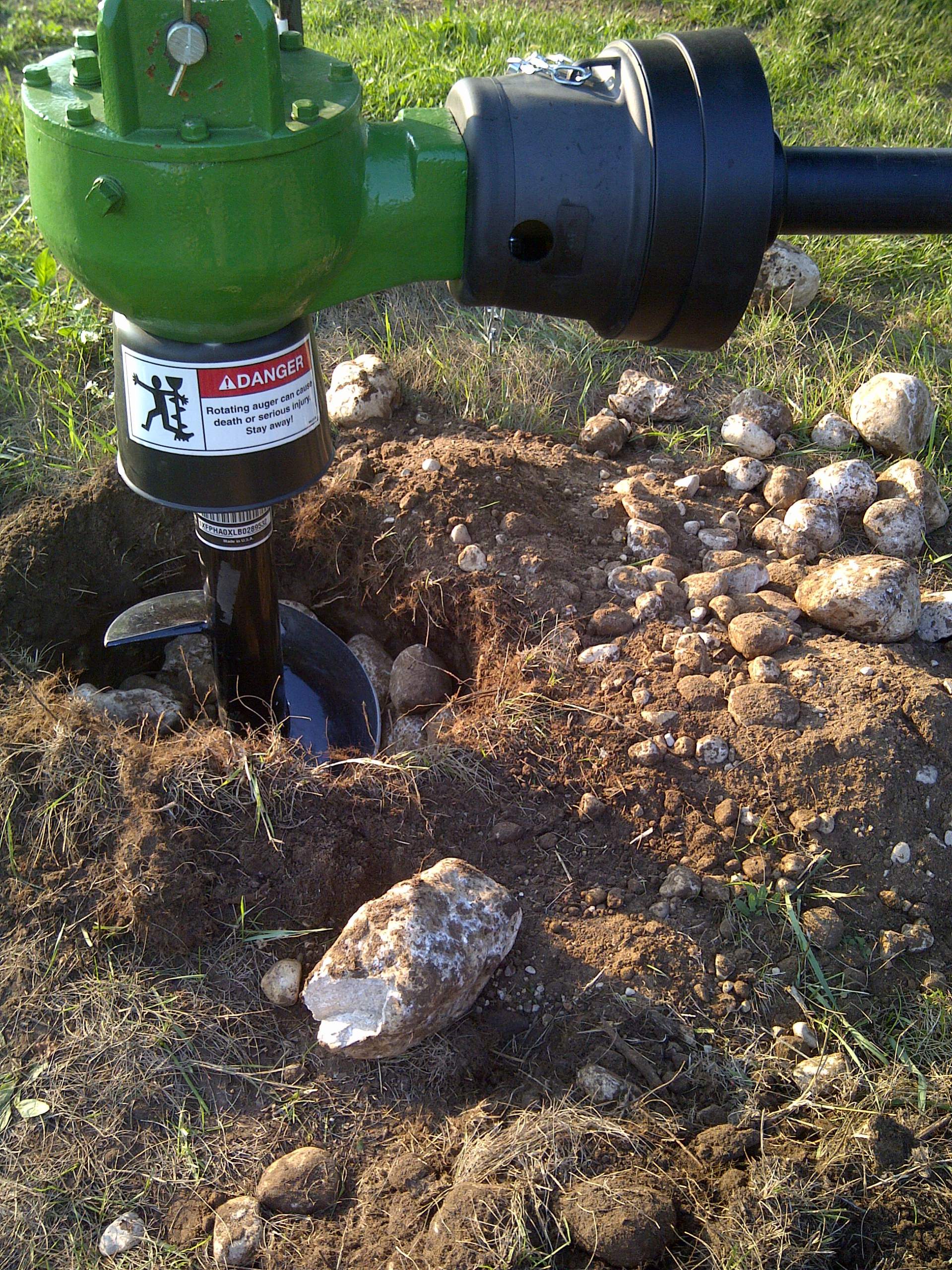

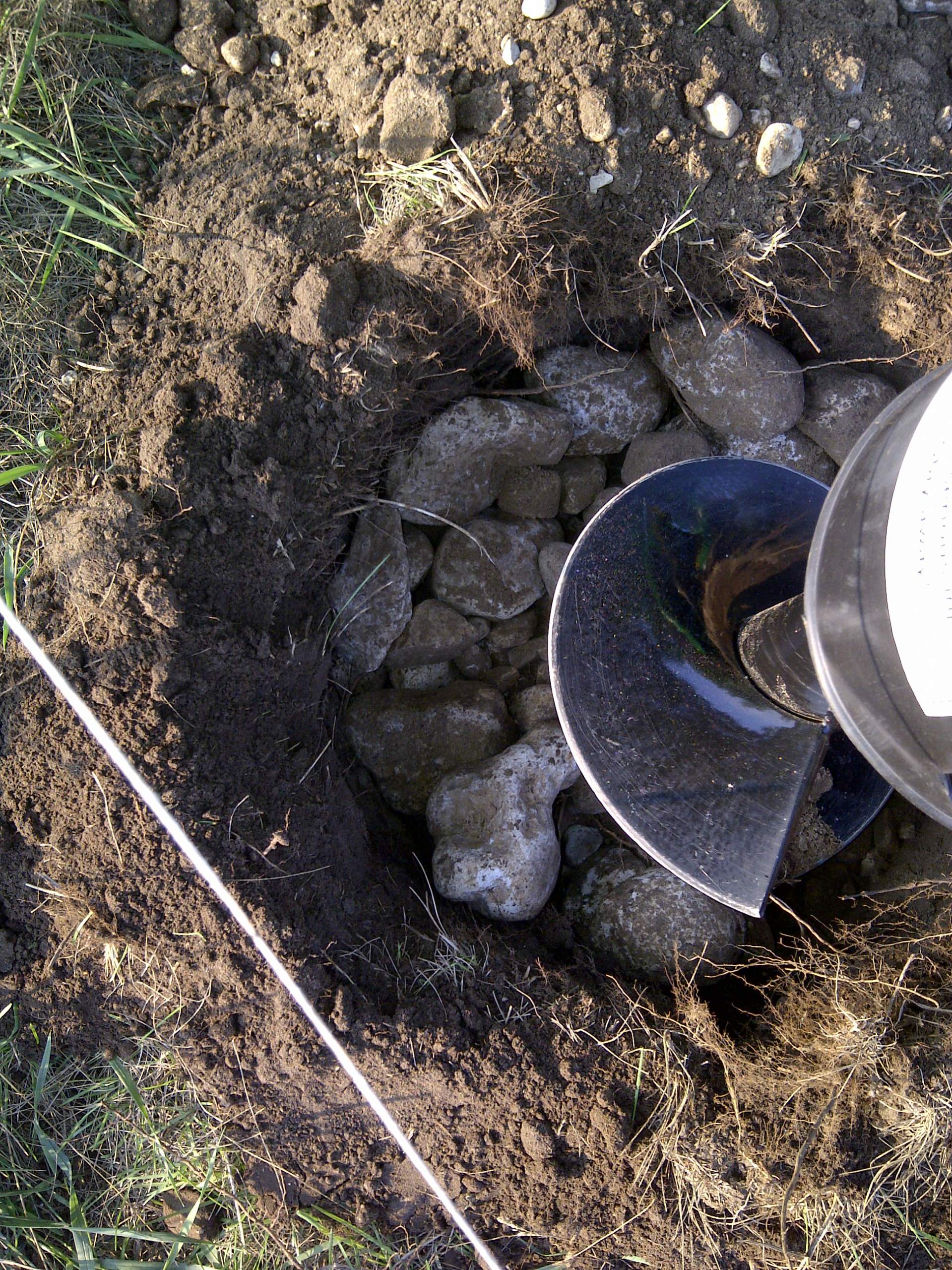

I apologize for not understanding this fully and would seek some feedback regarding pto brake/clutch. My situation is a bit different but the result of stalling the tractor is the same. I have been putting in fence posts and because of the location...I can run into a lot of rock. Sometimes the rock is so large, the post hole diggers "rides" on top of the rock because it cannot get past it, other times it "grabs" too big of a rock and breaks a shear pin, or as I experience a couple of times yesterday, the auger just bogs down and stalls the tractor. In all the aforementioned examples, the engine is runing at the slowest speed. Am I damaging my tractor when the load on the PTO cause the tractor to shut down?
   / Stalled the engine on my 2520 using a chipper #7
Not an unusual issue, it's a matter of buying the right tool for the job. In your case, Wallenstein recommends a minimum 35hp for the 42 series chipper. I don't know if that's engine or PTO horsepower, but I'm sure your 2520 falls well short on both. I'm thinkin' you'd fared better with the 32BX series., and even then they recommend at least 25hp
So to answer your question, yes. I think you should be concerned. You're trying to run more machine than the 2520 is spec'd to handle.
