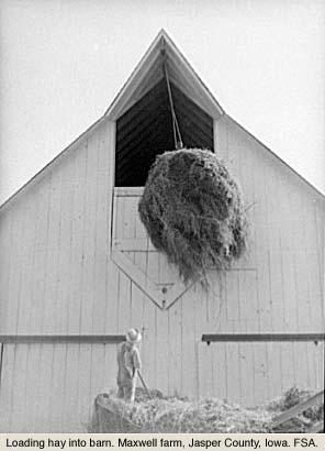

Can't leave loose hay outside here as it's too wet. The only hay bales you can leave outside are round bales that are net wrapped or plastic wrapped. Everything else has to be put in a barn or it spoils. People used to put up loose hay in barns as that's all there was. No reason somebody couldn't continue to do that as long as you have enough space in a barn to store the hay. 100 small square bales of hay is only about 2 1/2 tons or so of hay so it's not a ridiculous amount to deal with.
It is a lot drier out West and maybe they can get away with things we can't in areas where we get four feet of rain per year, such as leaving loose hay stacked outside. I'd guess they use a grapple to do it today but in the old days, stacking was done by hand with forks.
