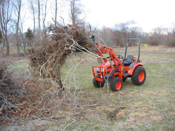

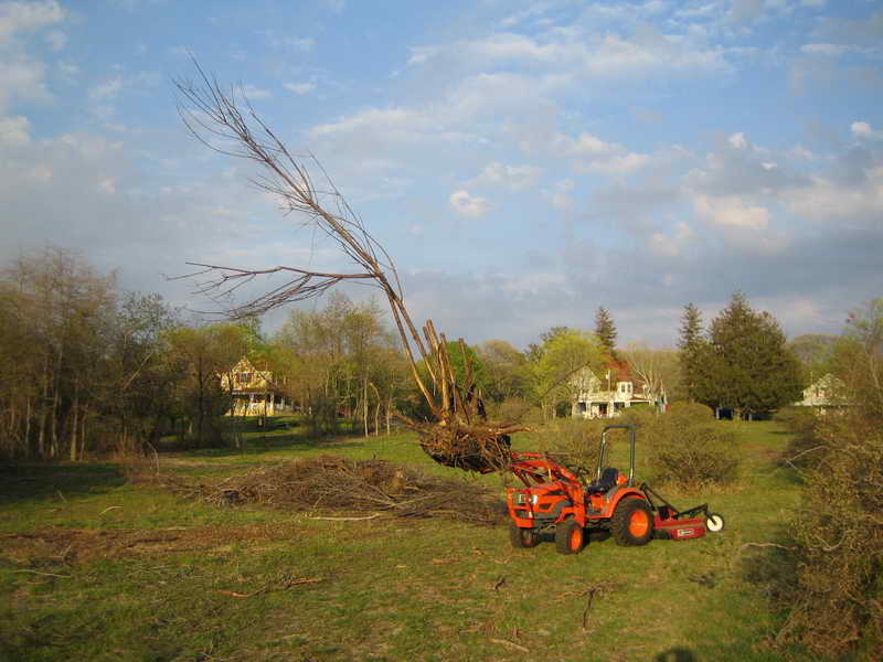

Agree. The CK20 would be better with a 3 speed no question and that is my own personal #1 wish for it. It is not necessary for loader/grapple work or road travel but for mowing the middle range would be a real enhancement.
The trade off in going to the CK27 is size and weight, both the good and bad aspects of each. If mowing more than 3-5 acres it would be nice to add a foot of width to a bush hog or finish mower and you can do that going from the CK20 (48 for bush hog, 60 for finish) to the CK27 (60 and 72 respectively). You lose some manuverabilty and need a bigger trailer as trade offs.

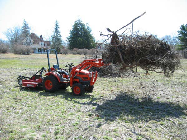

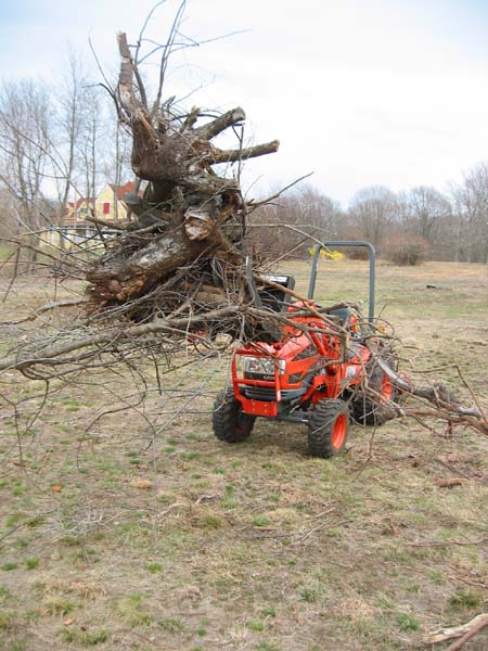

I am a bit biased because I loved my CK20. There were very few things I could have done with a bigger CK that the 20 could not handle. That is especially true for grapple work. If I was to upgrade to a CK27,30 or 35, I would investiage getting a Woods loader to gain another couple hundred pounds of lift over the KL130.
