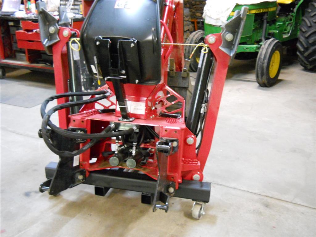

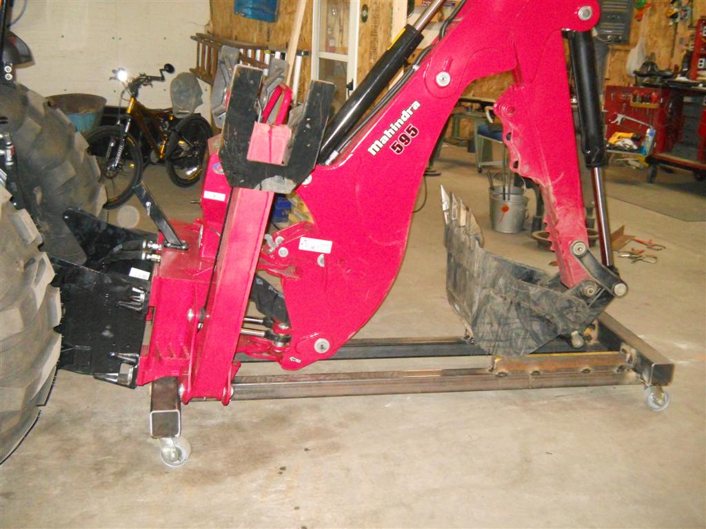

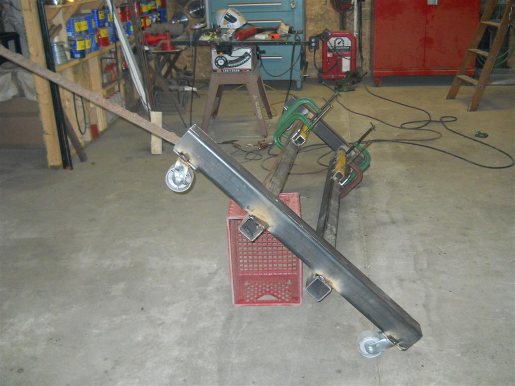

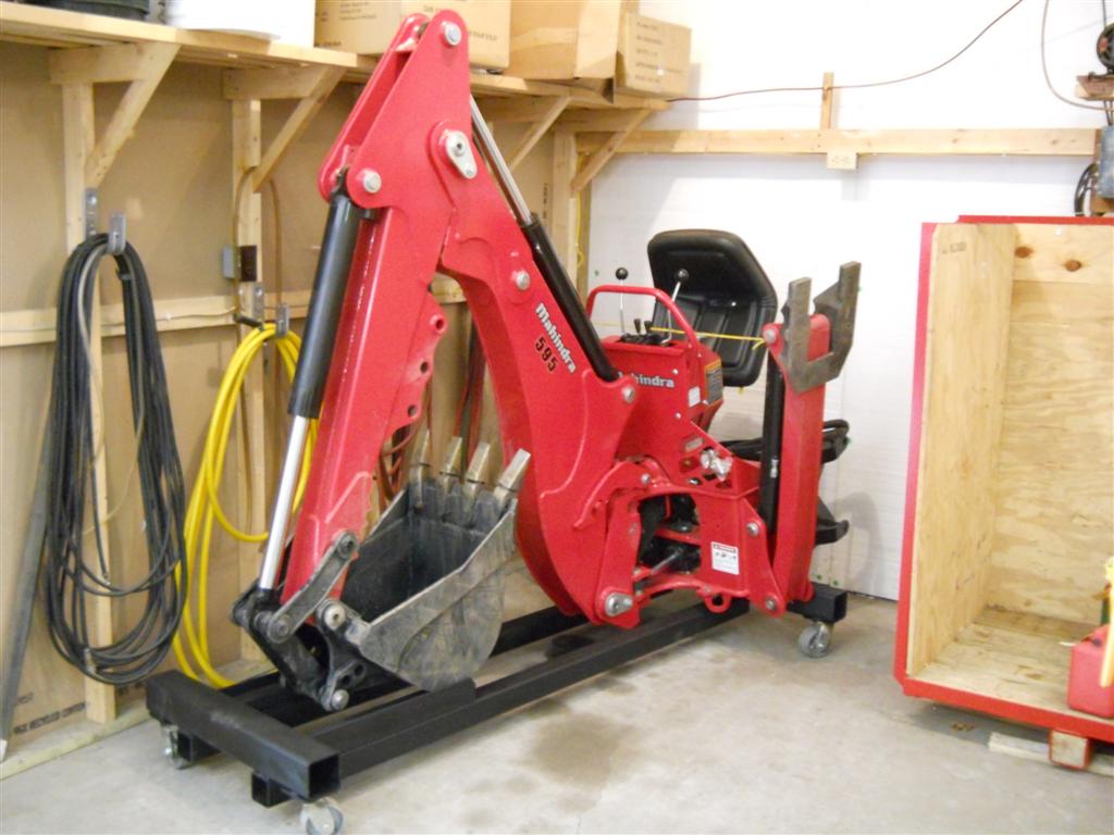

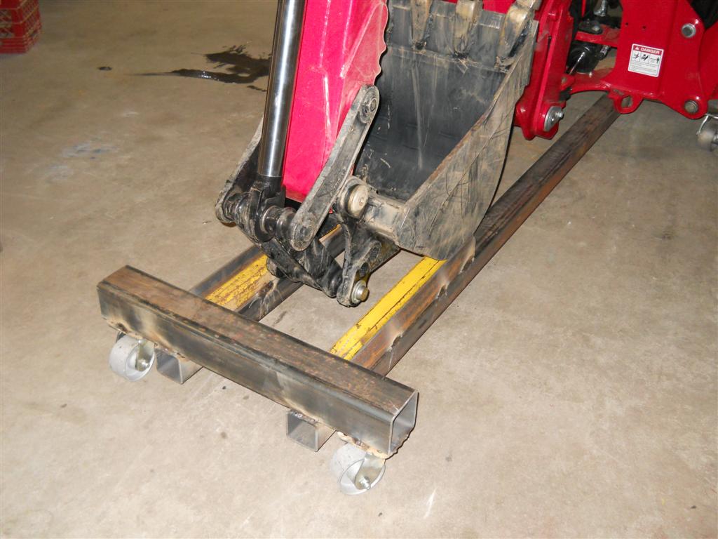

/ Stabalizer is sagging. #4
Made a dolly several years ago for my 595 hoe.. Do a search on this forum area for 595 cart ...

/ Stabalizer is sagging. #5
Evidently there are lock-out valves to prevent cylinders from leaking down never use one so can't give you any details.
/ Stabalizer is sagging. #6
I put a strap across the stabilizers when I store the backhoe for long periods.
Very fancy! Maybe I'll knock something together out of PT wood. I won't need casters since they won't roll on gravel anyway. I'll stash mine in the RV shed.
