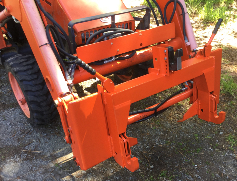

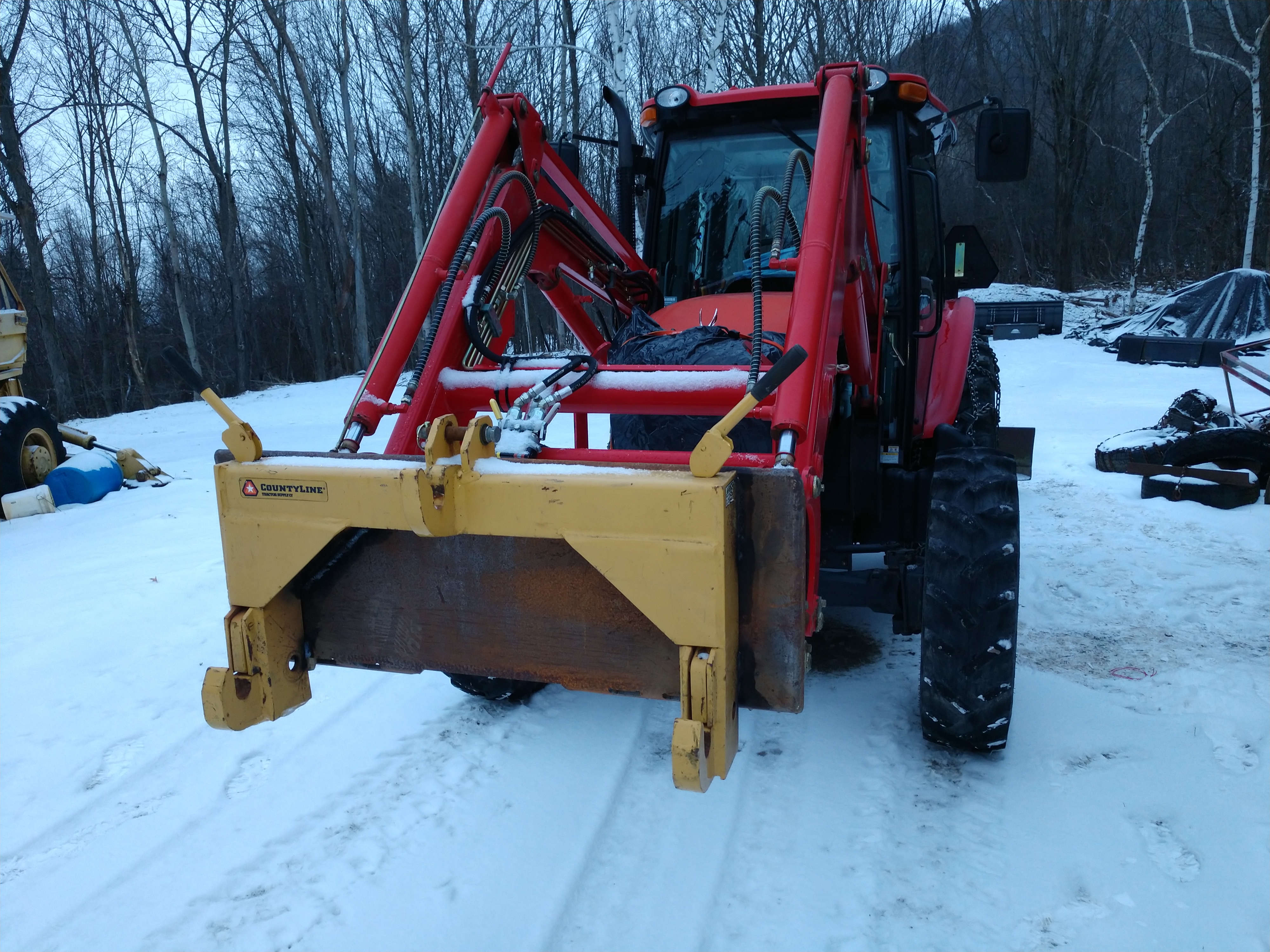

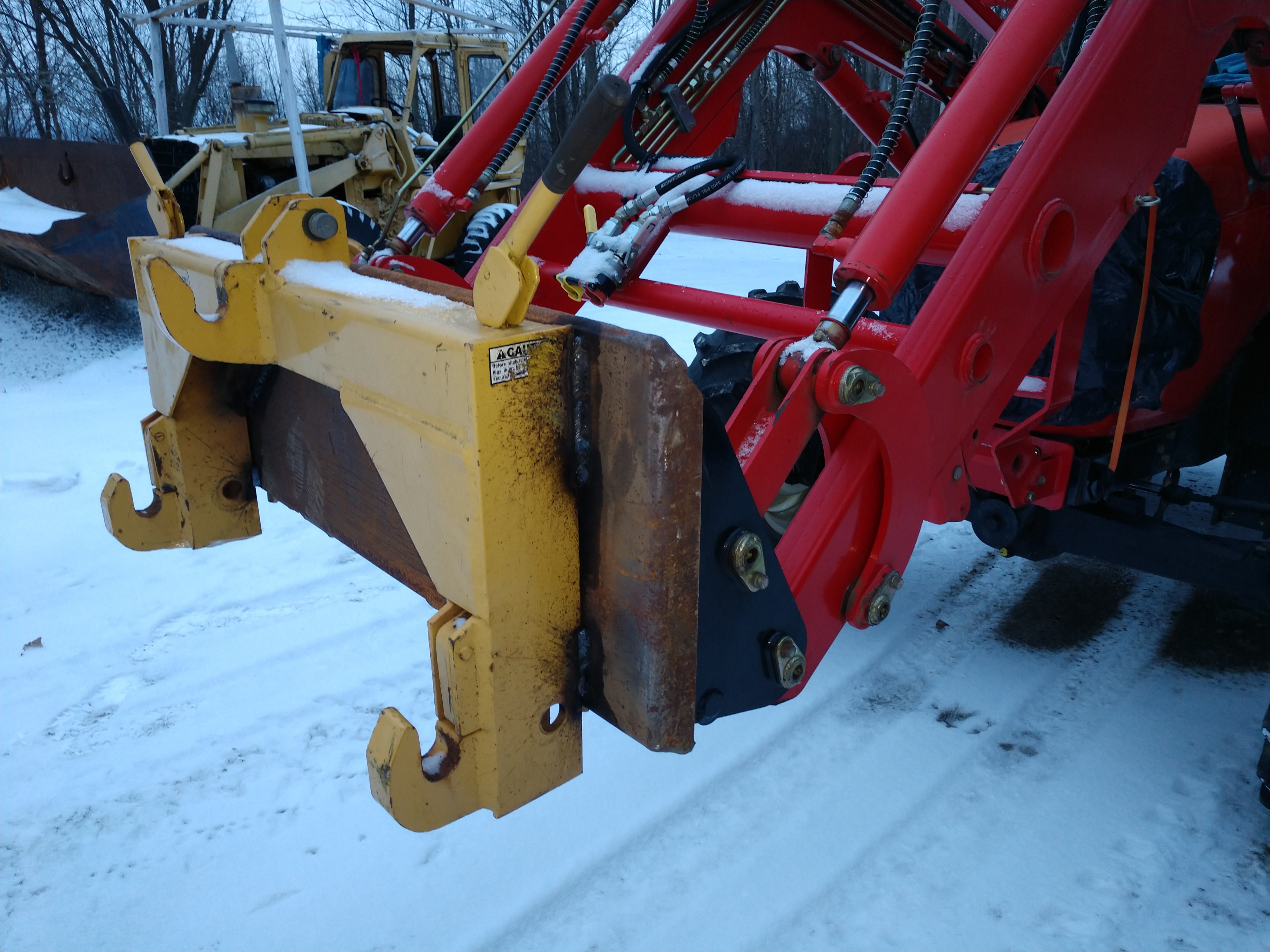

Or get a blank mounting plate and weld a quick hitch to it.
   / SSQA to 3pt for the front of the tractor #6
I did the same thing. Cheap ssqa plate from ebay and cheap quick hitch from HF, weld them together. Use it all the time, mostly for a trailer mover. Also to move around 3 pt implements easily. Works fine.

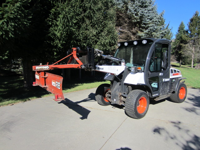

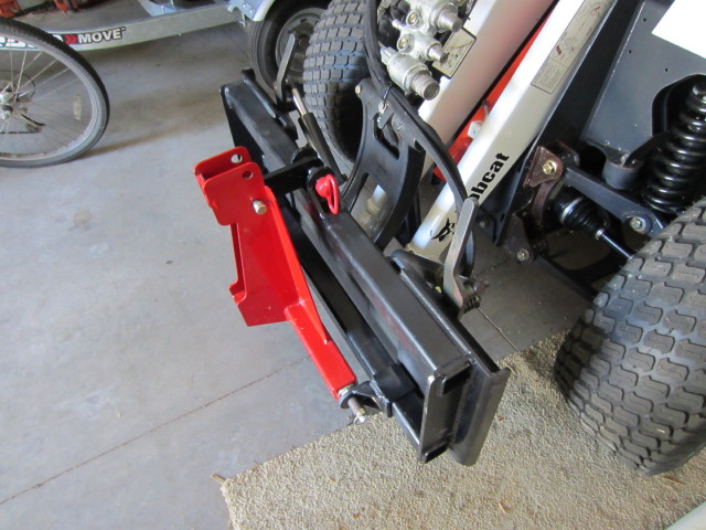

Then you can mount any cheap 3pt equipment to the front.
   / SSQA to 3pt for the front of the tractor #8
I just looked at that link. $300 and no quick hitch capability so hooking up the 3 pt implement is still a nuisance. At the time I paid about $80 for the cheapest ssqa plate I could find and about the same for the HF quick hitch. The welding part is dead simple.

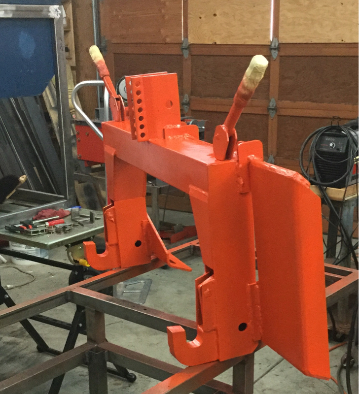

   / SSQA to 3pt for the front of the tractor #10
Yours looks quite a bit better then mine, all painted up and pretty.
I had the SSQA sitting around as a spare and the quick hitch behind the shed and needed the reach that day,
it was still hot from welding when I hung it on the tractor and used it, should wire brush and paint it this summer. :thumbsup:
