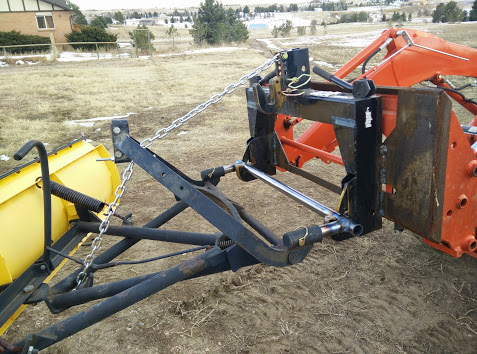

I made mine from an old 7'6" Diamond steel truck blade. I have a Curtis poly blade on my truck. My tractor is 66" wide so the blade a full angle covers my tracks. I can't say one brand is better than another but they all seem to work well. QA plows are made by many companies such as Diamond, Hiniker, Curtis, Meyers, Fisher, Boss, to name a few.
As far as angle, 25 degrees is more than enough to plow snow. Too much angle may tend to push the front of the tractor in the opposite direction. The better brands incorporate a crossover relief valve to relieve pressure if the cutting edge hits an immovable object.
Yes, you can back drag using a plow blade.
The key to using a plow is to get the A frame level when lowered. That way the blade cutting edge stays level when angled. If the A frame isn't level the end of the blade will dig into the ground when angled.
My plow frame is rigidly attached to the QA plate and the cutting edge has trip springs in case it hits something. I don't use the loader in float mode. I have a gravel drive ans lower the arms till the blade touches then pick it up an inch. That keeps weight on the front wheels for better steering. If I had a paved drive I'd lower till the cutting edge touches and plow.
Others use a setup like you see on a truck using a chain to allow the blade to float on its own.

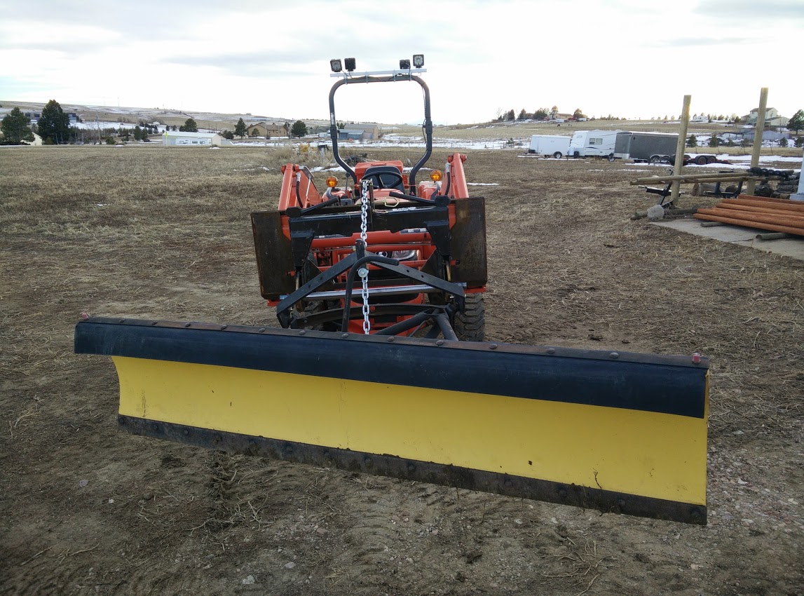

I did the same as George2615. I made a quick attach plow from an old Meyer 7.5' truck plow I picked up for $300. Welded two 2"x2" boxes on the bottom of a quick attach plate for the plow mounts and welded a D ring on the top of the plate for the chain to raise the plow up and down. Hooked up the hydraulics and have a fully functional plow for around $450. Was my first welding project, so learned a lot too.
My tractor is 66" wide, and the 7.5' plow is just wider when full angled. I keep the loader arms 6-8 inches off the driveway, and tilt the plate forward to allow the plow to float by providing slack to the lift chain.

The old small manual plow I build from a cheap small truck plow ran off with my old L3200. so now I'm debating between reviving that old beater plow & looking for a new beefier hydraulically angled SSQA plow for my new L4060. I had the A frame on my old plow attached to a 3pt quick hitch welded to a SSQA plate. I ran a chain from the toplink on the QH to the plow to get float. Personally I find that method WAY better than floating the loader. I deal with a lot of freeze/thaw cycles here in Colorado, so I'm often plowing on not frozen gravel. Keeping the blade light is a necisity. The only problem with my old setup, other than the manual angle was the plow stuck out a ways. I didn't have to much problem with sideways push, but it was kind of awkward. 4shorts & others have built skids for the back of the plow frame & leave the loader in float.

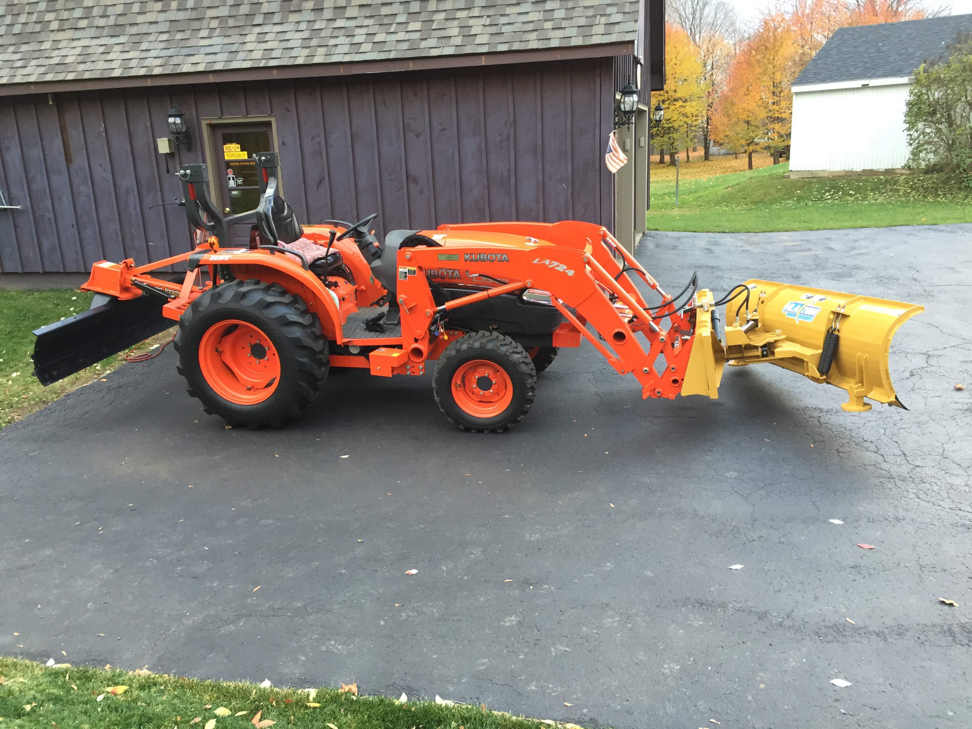

I have an HLA 2000 blade that is new to me this season. Very well built. I have only used it one this year, but it was real smooth to operate and will significantly reduce my plowing time.

I have a HLA2000 up front and a LP3584 on the rear, it's neat as I can go either way.
