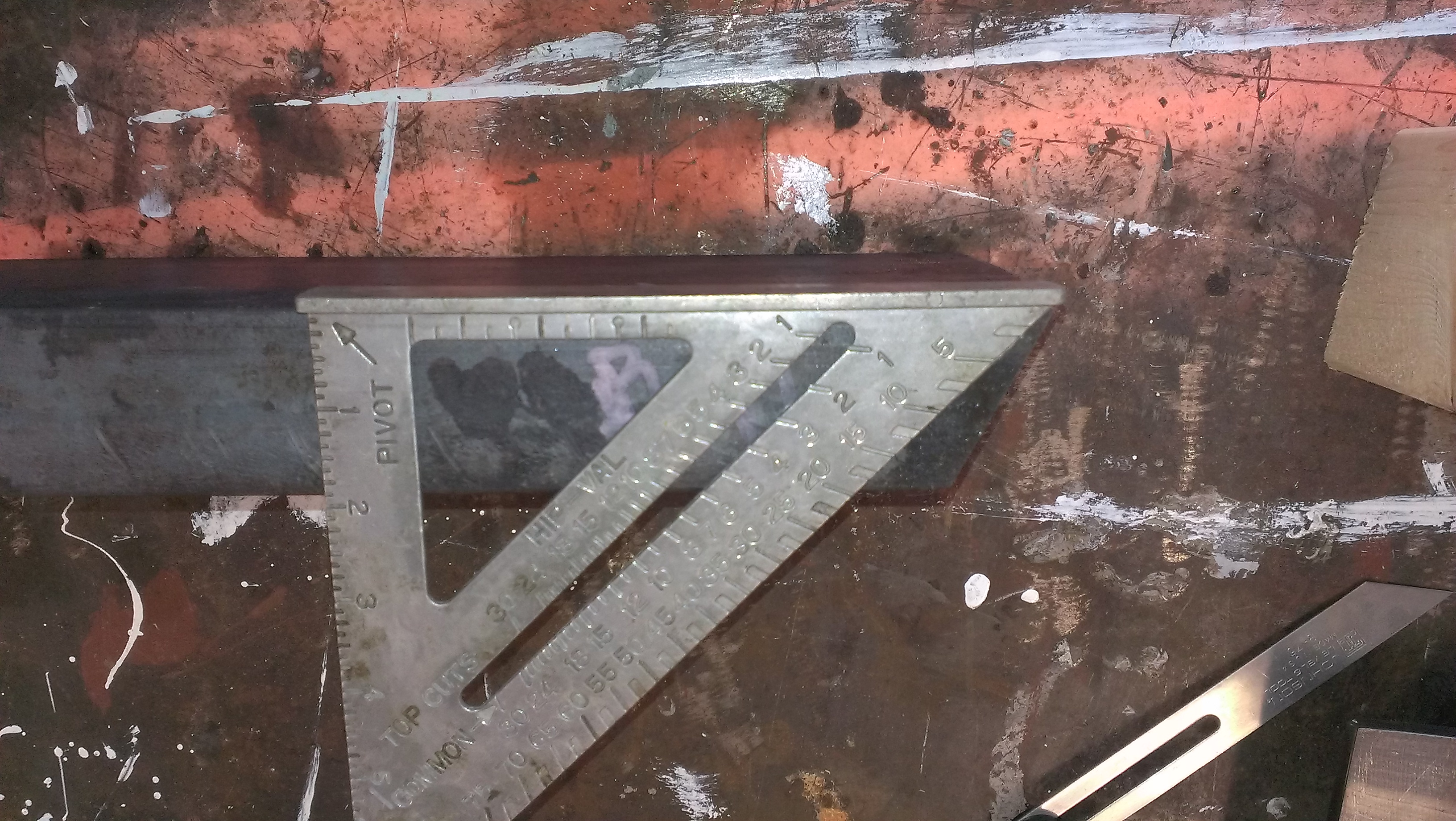

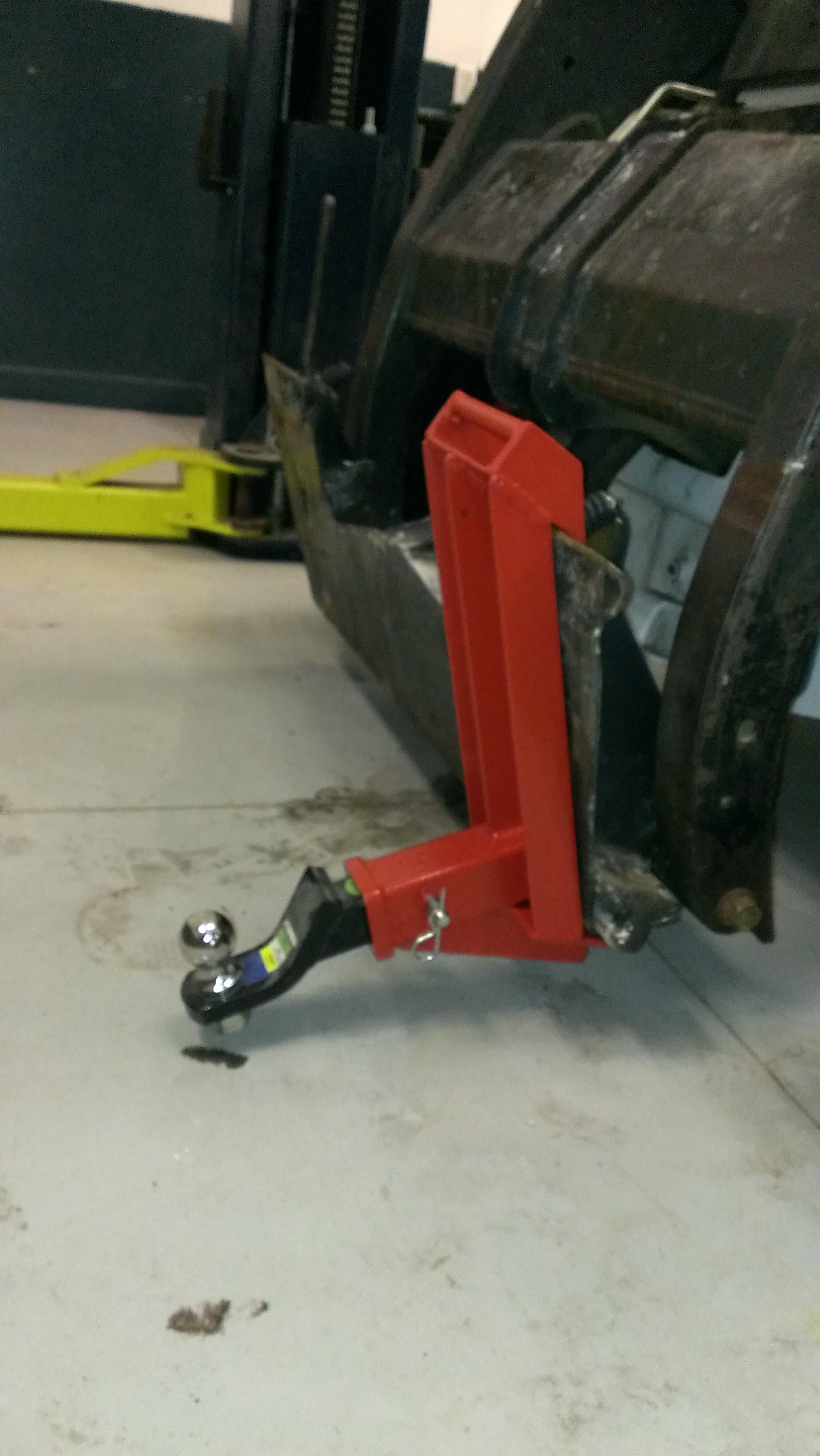

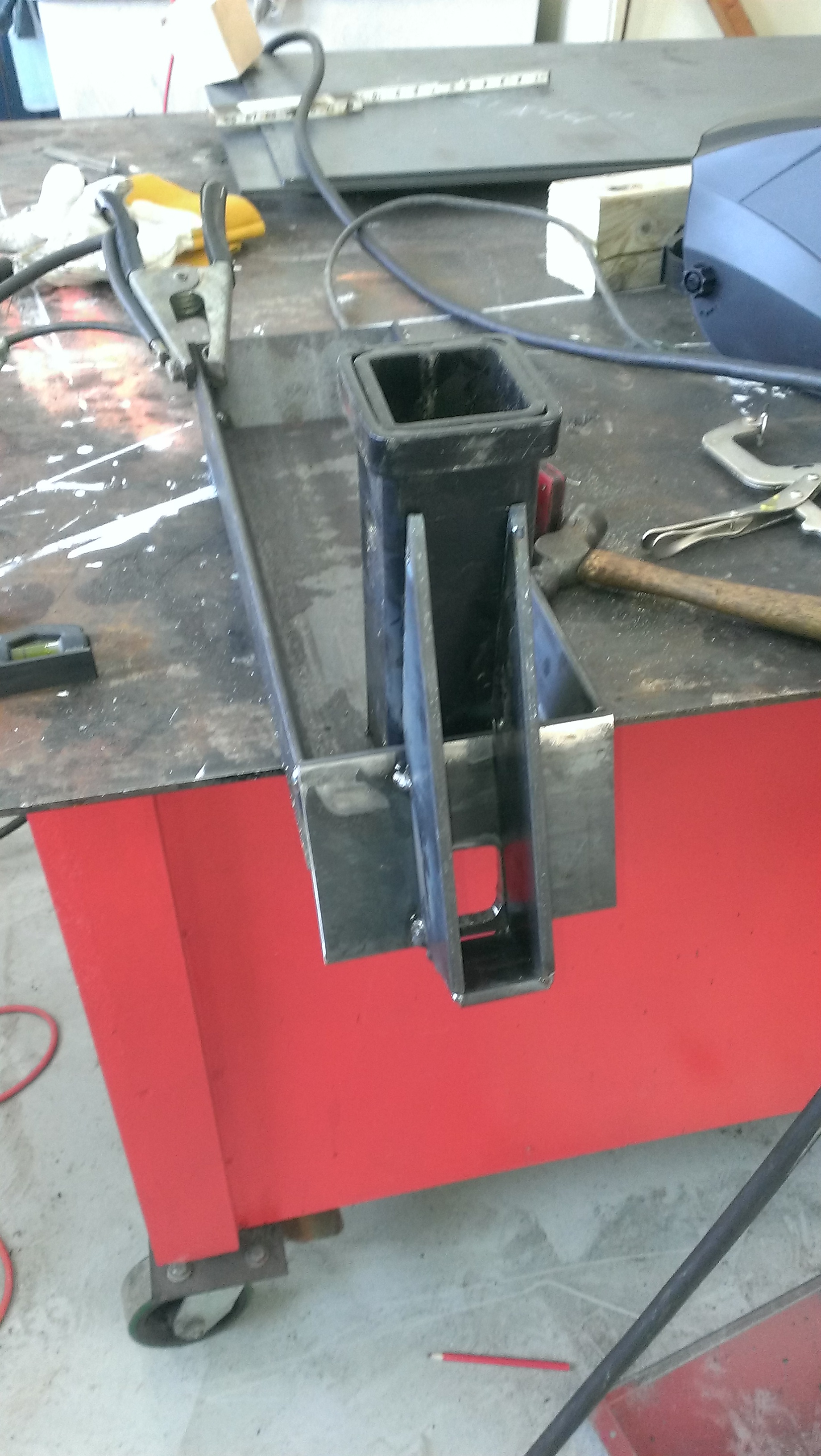

Built this so that I could get low and under the tong when it is on the ground. Also don't have to grab the forks.
boxed in the pin hone

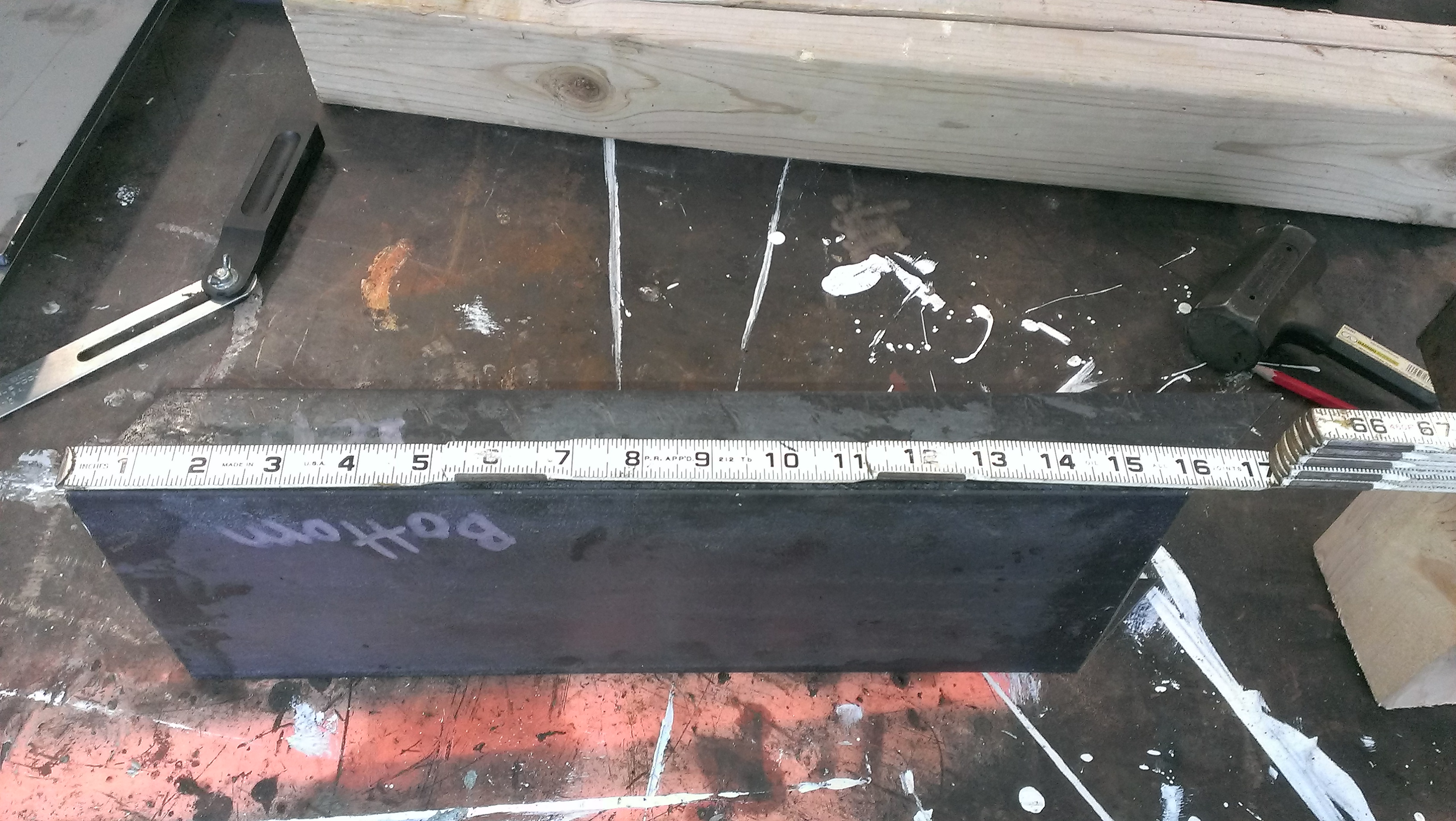

This should get you the length
the other one is at a 45 this one is at ?, think you could get away with another 45, I just matched what was on the bucket.
The handle/bar on the top is a must, its heavy and makes much easier to move around
Everything is powder coated.
   / SSQA Receiver tube atachment #2
Clever design and very easy to use! Powder coat looks nice!
Thanks. I improved on someone else idea. If i do it again going to leave the tube off and just go with a ball most of what I have is 2" anyway. The way I have it it is on the heavy side. Thanks on the powder from a distance it is deceiving. Way I am doing it now more art than anything else. Beats paint. The HF gun has gotta go, won't get the coverage in the corners on the smaller complicated parts. Anything with no corners works great.
   / SSQA Receiver tube atachment #4
Corners are an issue no matter what system you use. Look up Faraday cage effect. You have to kind of 'force' the powder in the corners.
   / SSQA Receiver tube atachment #5
Be careful when lifting heavier trailers. I have repaired/rebuilt 4 different ssqa's that have been twisted because to much force has been applied to one face. It really needs to span both side to prevent damage.
I hear you. Moving around empty trailers it should be fine. On the heavier stuff I use the ball in the forks
