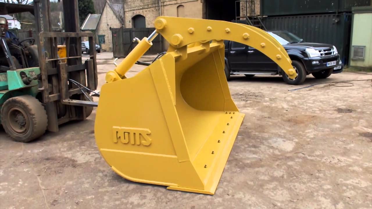

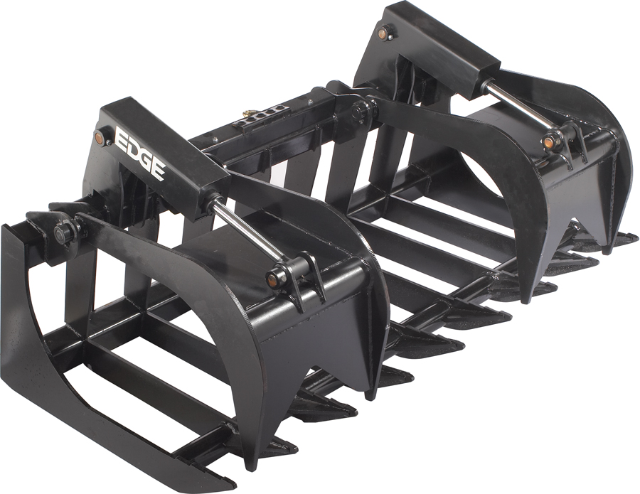

It makes sense what your saying, and I may have responded too soon, and apologize. I mis-spoke that it is 3rd class, but should have typed 1st class, (think scissors or see-saw). But I was without knowing *your* intention of cylinder mounting position. If your going with a bell crank type, with the cylinder *behind* the bucket, the forces I listed will apply. The second image (yellow) is what I thought you were wanting to do, (and it may be). If your going for more of the brush/debris type grapple like the first image (black), then the calculations will be different. I suppose you could make a mock-up of your design, similar to how you posted the plywood grapple 'tooth' in mock form, and post your dimensions we could make a calculation from that. I usually make my mock-ups with cardboard, and run it through the motions, and see if they perform the intended function.

   / SSQA multi use base #33
Here is another (first class lever) setup, to give some ideas there is more than one way to do it. Just *remember* during mock-up, to curl the bucket all the way back, and cycle your 'cardboard grapple' to check for interference with loader crossbar/hose connections/hood and grill/headlights/etc. before committing to cutting steel.

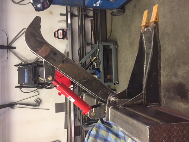

Sorry for the late reply, I have been out of town. The cylinder mounting design that I will be going with is the same as the black grapple style in your post #32. I have mocked up a cardboard cylinder and have cycled the grapple and it clears everything nicely. This is how I came up with the 8" stroke, 16" retracted and 24" extended, giving me a 36" grapple to bucket opening.

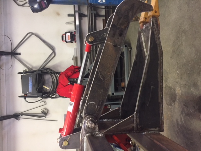

#36
Heres where I'm at now. I made up all the cylinder mounts and just have them tacked in place for now. I will pick up the rest of the hydraulic parts tomorrow and cycle everything to make sure it works before I weld it solid. After that all it should need is some paint.

   / SSQA multi use base #38

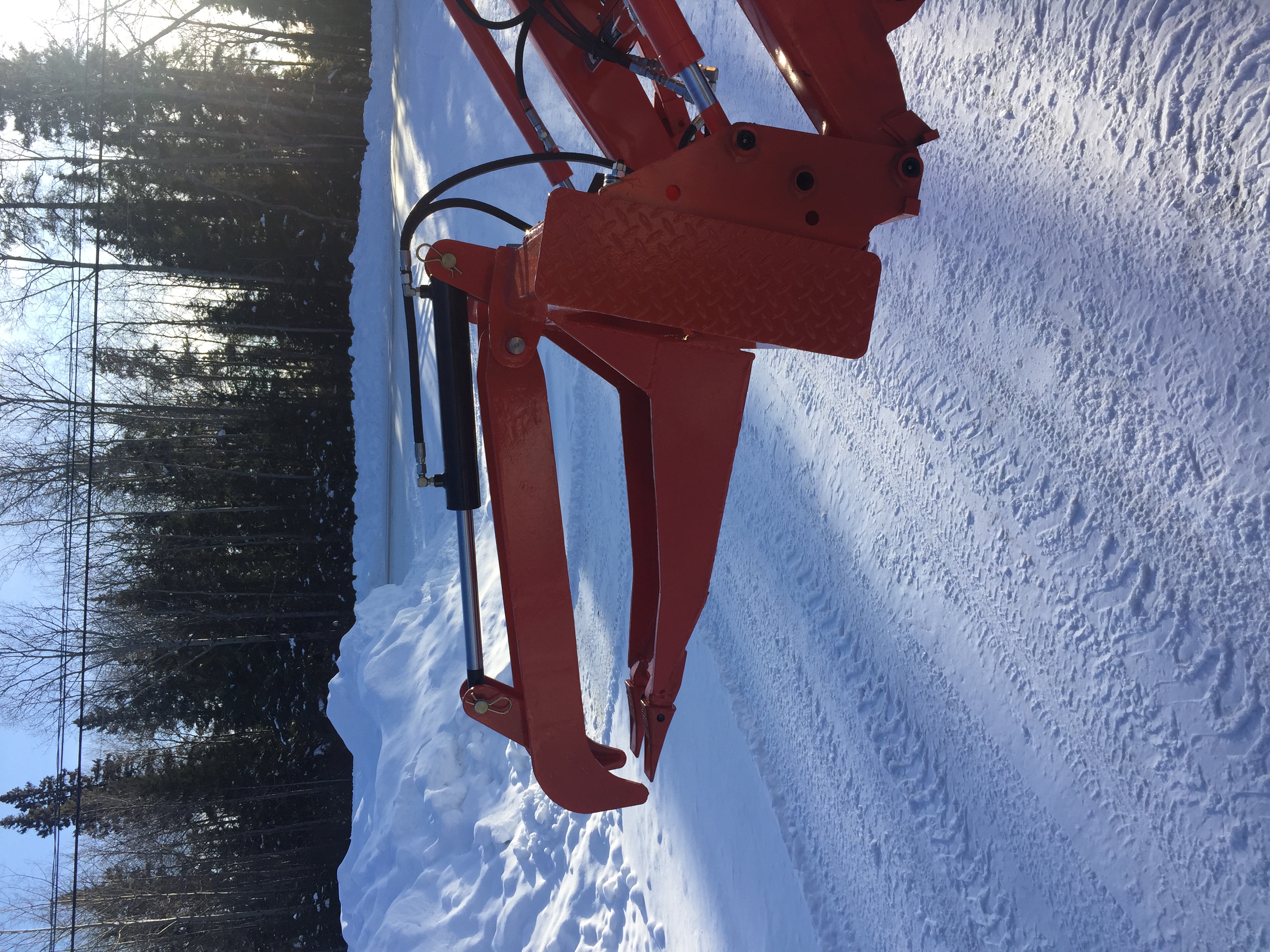

The only thing I see and it may be to late to do anything about is the grapple doesn't reach to the end or past the tips.
That is how my grapple is built and at times to grap something I have to go to almost full curl to get the grapple close enough to the ground, example a 6" log flat on the ground and you can't or don't want to drive into the ground and get the bottom under the log and then clamp it, I have to curl way under to get the grapple points close to the ground to try and clamp the log.
if the grapples where longer I think it would be easier to get ahold of some things.
But your build is impressive, looks good.

#39
Thanks and good point about the grapple length. That actually crossed my mind as I was measuring up for the cylinder length but it was too late. I designed the grapple length without the removable teeth installed on the bucket and thats where I went wrong. The teeth add an extra 3 to 4 inches. If I find it too much of an issue I guess I could add some length to the grapple arms just past the cylinder mount. I didnt think it would be an issue but thats where my lack of experience with using a grapple come in I guess.

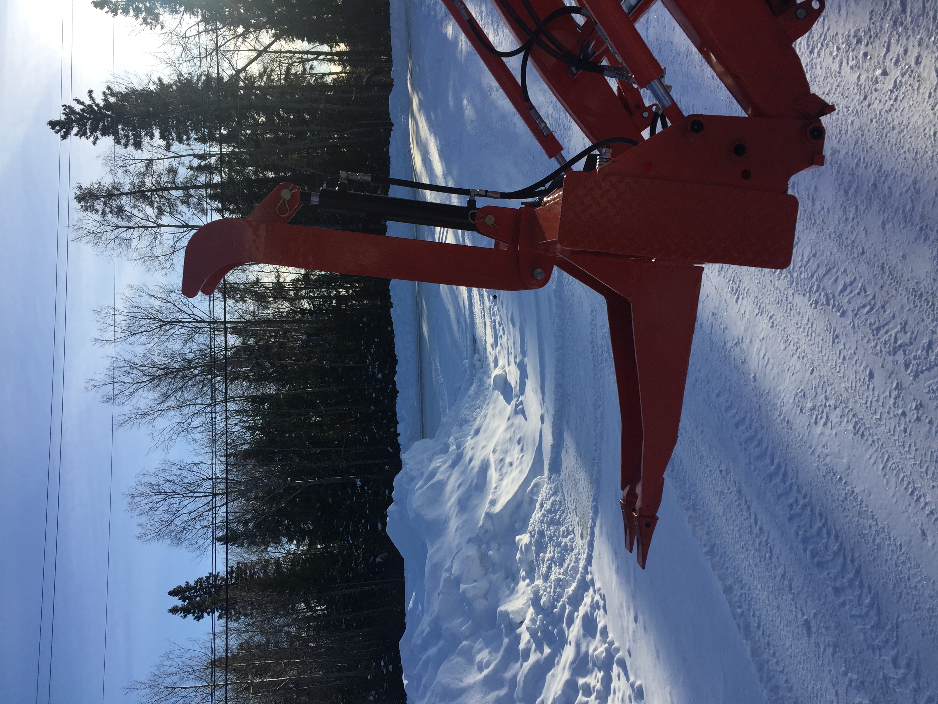

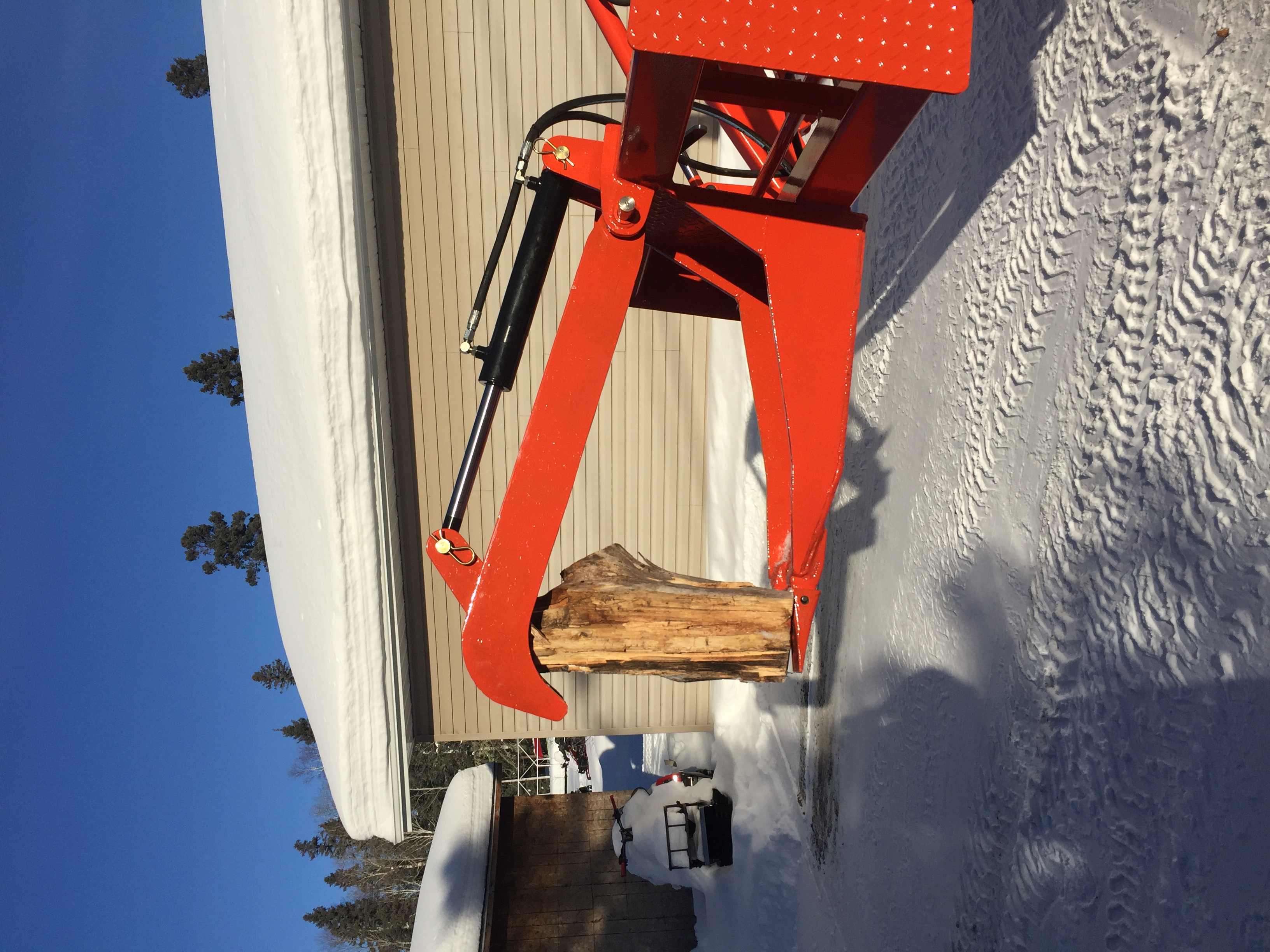

#40
Well I took the advice of some of you and extended the length of the grapple as well as the stroke to have it open more. It was s bit of work but I think it was for the best. I still have to build a cover to protect the cylinder and finish the pivot shaft.
