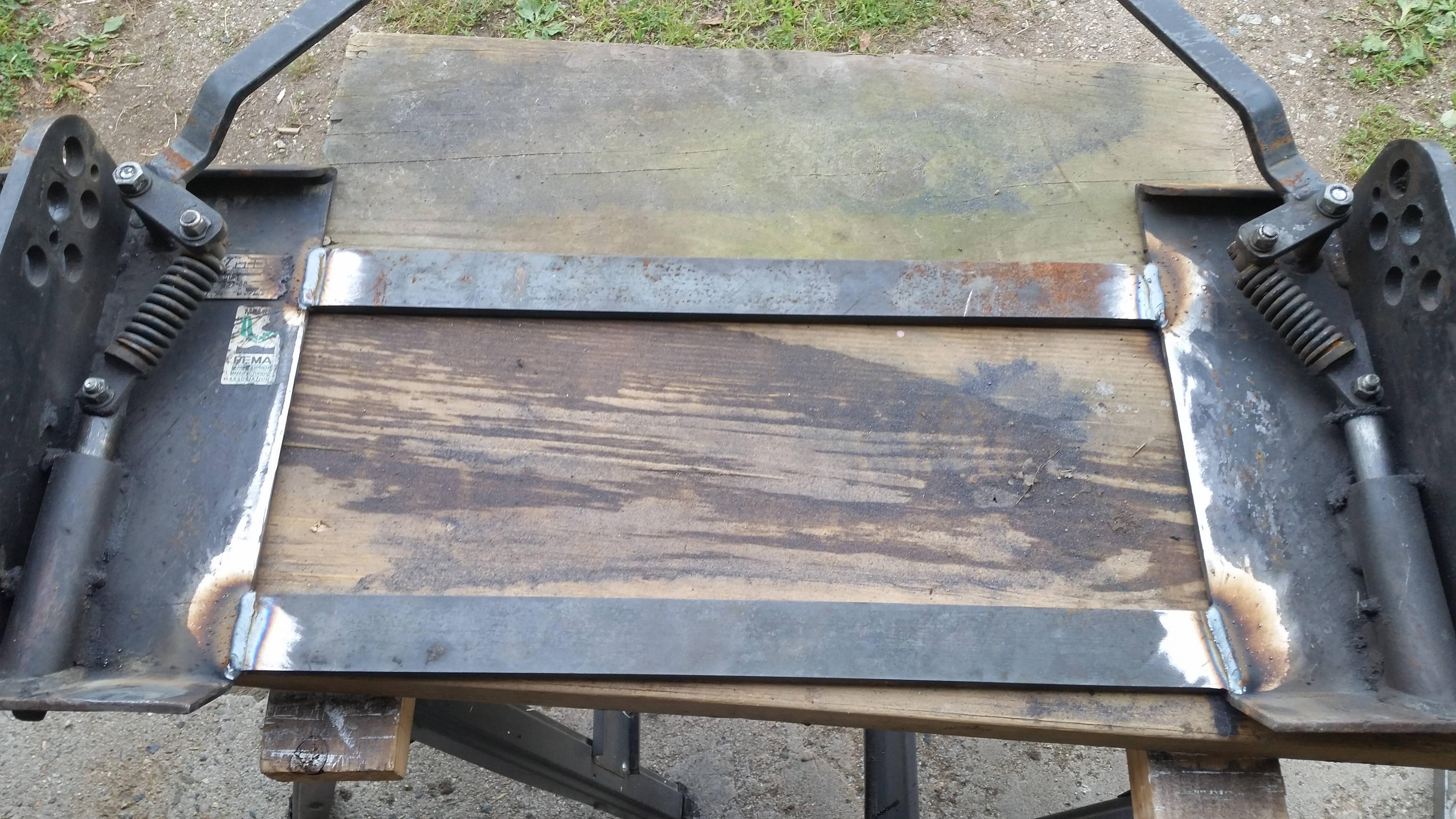

Hey there. I have a Kubota L3710 currently with a Kasco Uni-Hitch setup. Its garbage. Utter. Garbage. I've fixed it a few times, but short of welding 1" thick steel plating to the entire unit it, it keep twisting on me; especially when attaching the plow. The latch dogs have also always given me issues. I'm sick and tired of it.
So what are some options? I see EverythingAttachments has something for $800+. Was hoping to get something for less money. Recently moved and there's no 220v outlet so I can't use my welder. Can't transport the tractor anywhere either. Looks like I'm stuck with something bolt on.

Its on the list. Right now I'm facing a garage with 14g wiring. I can't even run a compressor in there. So I need to tear that wiring out and install 12g.
Looks like the Uni Hitch is SSQA. Is it not heavy duty enough?

I have so many problem with this setup. The two bars flex back and forth. Especially with the plow.
Spoke to Dad last night, and we've decided to try one last time to fix it. My welder and gear are at the shop, so we're going to bring that over then use the generator to run it. Weld right in the driveway. I have a 4x8 sheet of 1/4" that I'll use. I'll plate it up solid. Fish plate everything as well.
I have a second issue with the snow plow, but that will require welding as well. I get out there today after work, I'll post up a video.

Yea, the two bars that connect each side of the arms. The original ones twisted. Cut them off and welded them. Second time I welded 3/8" bars, those welds broke. Now I'm just going to go all Mad Max and plate the whole stupid thing.
The plow is just menacing on the whole system. There's a lot of weight and torque being thrown around up there.

If the plow is bending the SSQA mount and you reinforce to stop that, I'd be concerned with bending a loader arm. I think I'd look into a dedicated plow frame and remove the loader during plow season.

I can't do a dedicated plow frame, because still need the FEL to bring in firewood.
The problem is two fold. A video is going to make much more sense, but I'll describe it here.
Its all when connecting the plow to the SSQA. Once on, its fine. The first issue is the skid steer plate on the plow, not the tractor. I prop it up vertical, pull the tractor forwards, then once the QA on the tractor comes into contact, it flops over. I need to weld in a bar or something to prevent it from falling over. Something removable so once its connected, I can take it off. So when it flops over, I curl the bucket arms almost all the way down, "scoop" up the angled edge of the plate on the plow, and fight with getting both sides on; especially when the plate is on its side. The problem gets even more complicated if the ground isn't level. One side will fit into the top groove before the other. Then its a careful balance of raising the plate to vertical so I can get out and lock the dogs. But what happens a lot is when the plate is on its side, one side will raise before the other and twist the two arms. Or one side of the groove will pop out as I'm curling back to vertical. Once side will pop out and the other will stay in. This puts a bit of stress on the arms. By the third time the snowplow is connected, the QA is contorted.
So yea, I need to fix both issues.
