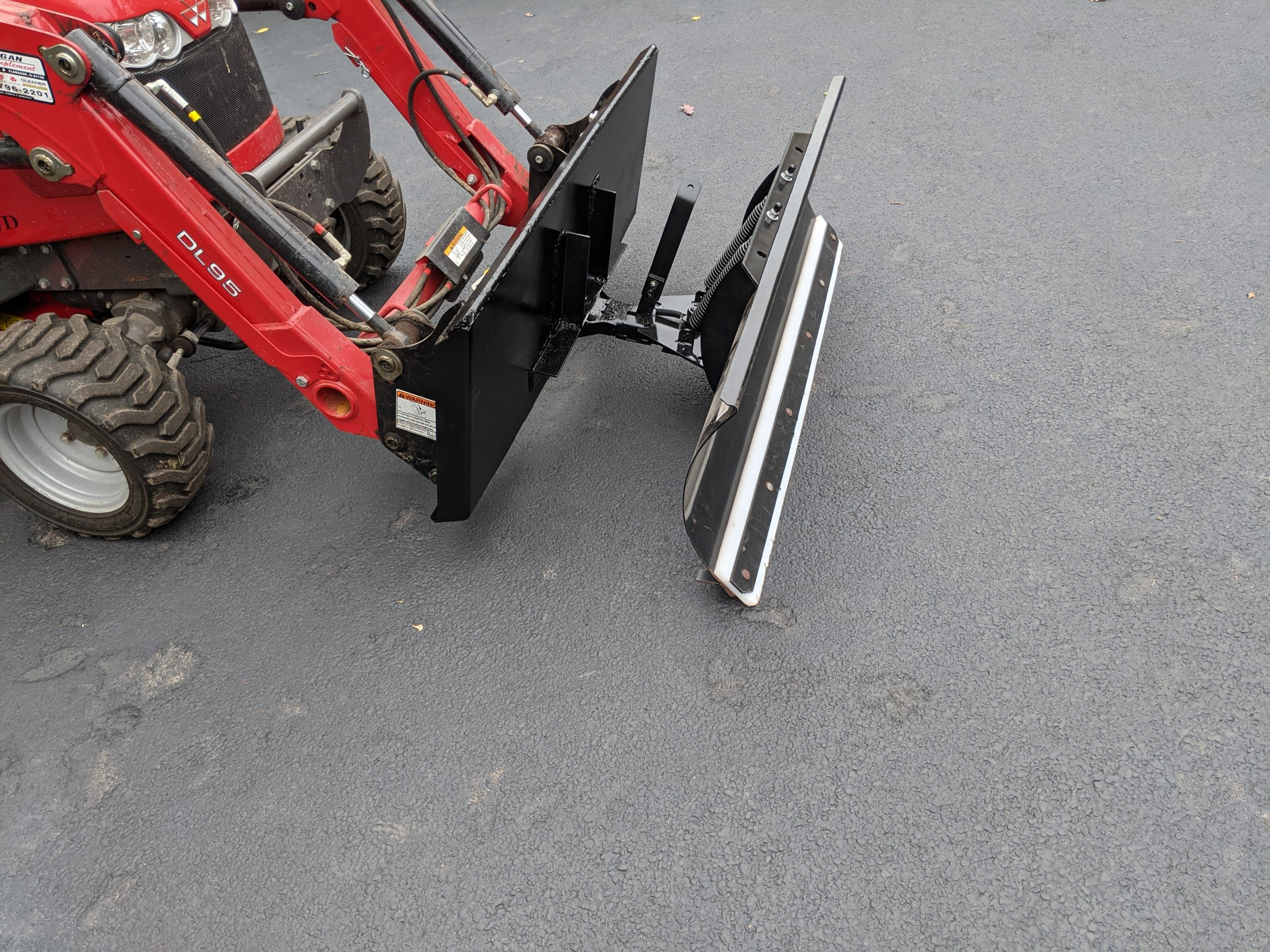

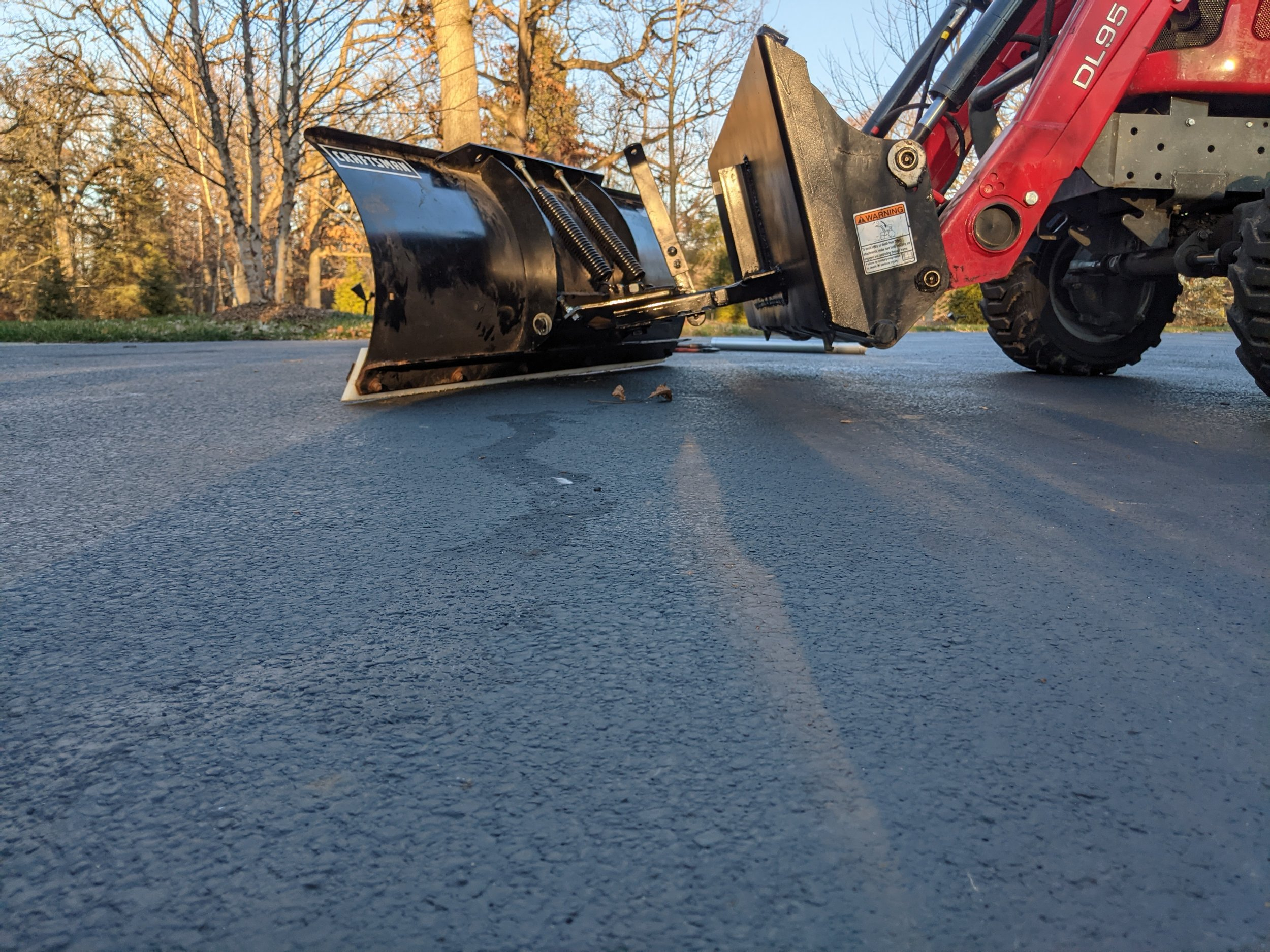

My SSQA blade floats via a chain. It is the underslung design, set forward just enough to comfortably clear the FEL frame at full right/left travel. I have had various rear blades and a regular rear-facing blower. The SSQA is the best I've found for doing areas like parking lots. So far, it's my favorite snow removal tool.
The rear blades worked fine for small snows on driveways. The rear blower was a lot of fun, but no good for parking lots. Fortunately, looking out the rear window hasn't been a problem for me, although many do complain about rea-facing blowers.

Interesting in that the blade is allowed to float on it's own.
Similar to other front mounts in that it sticks along way ahead of the loader frame.

No down-pressure. Floats on its own weight. Lifted with the chain by curling the loader control. Hydraulic angle using rear remotes or 3rd function -- OR, if you don't have hydraulics, can manually swing it or just leave it angled and always plow in one direction. MUCH better than a rear blade or pushing snow with a bucket.

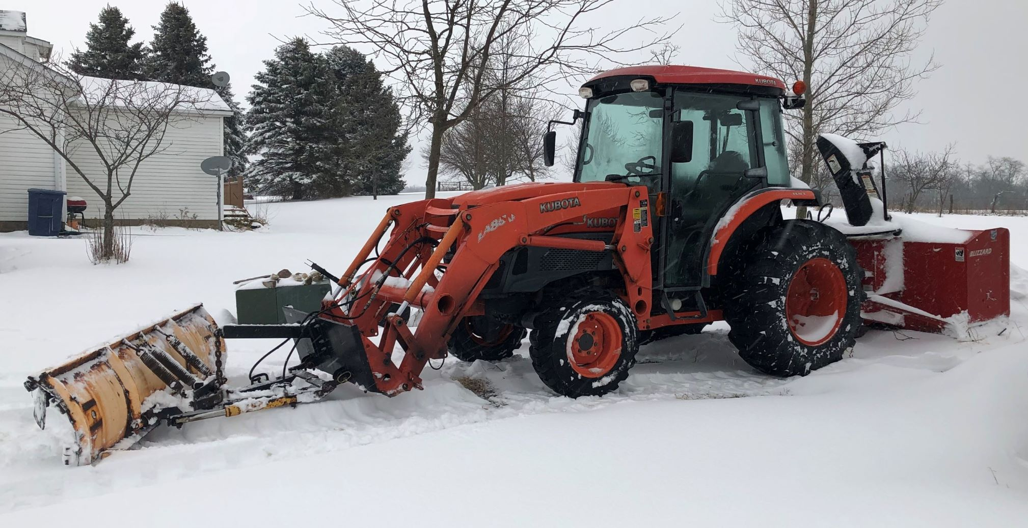

For mine, I welded my old craftsman plow onto a ssqi plate. It's a rigid mount, but there's a lot of slop in the pivot so it allows a few inches of float. That works for my driveway quite well.
But if I was to do it again, I'd probably forgo the plow and would build a snow pusher instead.

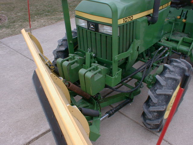

Short wheelbase, power up and angle plus vertical float. $100 scrapyard truck plow. Wide enough to shove snow mounds off to the side, easy & fast to attach (2 bolts and a pin + 4 hydraulic lines), and low side thrust moment. 1000 psi cylinders work just fine with my 2000 psi loader lines. I used truck brake line to reduce the initial pressure surge. Plus entire loader frame can be dismounted without leaving the seat. I've since added a commercial grade rubber wiper strip to the blade edge now that my 800' driveway is concrete. After any heavy snow, I'm done before the tractor warms up. Single pass down and back in high range and top gear. Speed tosses the drifts as far as I want. Plus I occasionally use the down-force ability to crack any ice buildup that can occur.
The only 'problem' I have is neighbors following me if I decide to do my county road. I'm not willing to drive to their workplace so they re stuck where I leave off and turn around.
