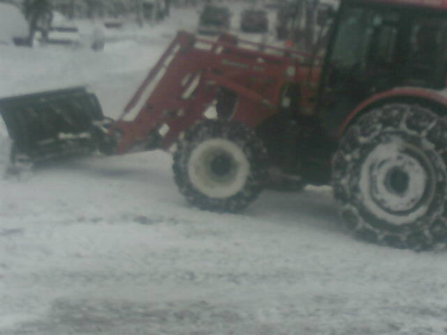

I have the fixed ssqa blade the under slung would work much better from what I have seen plowing on my gravel driveway.
There are several threads on here with the under slung blades.
The off the shelve ssqa blades stick out so far ahead of you that any irregularities become quite pronounced.
The home built blades that are tucked back in under the loader down tubes are much more compact and likely better then the commerical blades
such as mine.

Yeah you can do it fixed, but it is far, far easier to use when you float the blade independently from the FEL. And as a couple posters have noted, bring it in as close as you can. The lower pivots can be behind the SSQA plate by running them below it.
If you need to be able to apply serious scraping pressure to the blade too, you can set it up so you dump the loader enough and you engage the blade frame to press it down for scraping ice, for example. And then right back to floating on the chain when you move the FEL back to curl a bit. All depends on how good your fab skills are.
